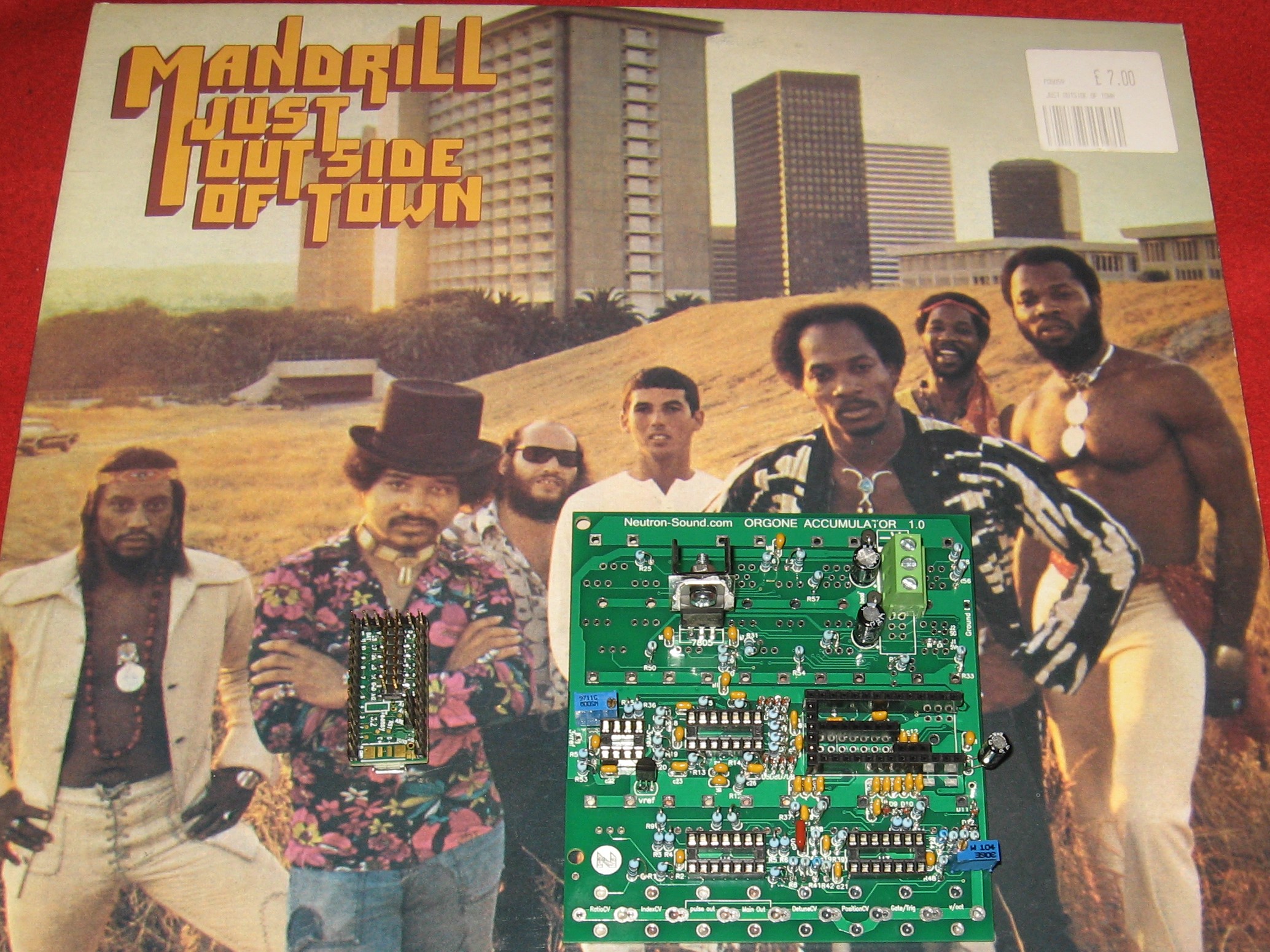

I have a small pile of bare & new to me pcbs forming and decided to tackle the top one first , a Version 1 Neutron orgone accumulator green pcb (thanks Alan).

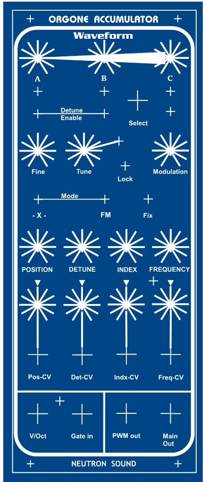

The home made panel will be the usual 100mm wide by 250mm high with the panel pots , switches , sockets wired back to the board , i found Sduck's cool build a great source of inspiration for helping me with the layout design (Thanks Sduck) , and also the 60 or so pages of the muffs build thread were good to read as well as the pdf docs.
Progress so far ... i have populated the pcb , and now ready to twist some 2/3/4 core wire looms in the drill , i found a piece of 4mm thick ply for when testing and tuning happens , the proper blue panel will have to wait till ive designed some other panels to send 1 order to the printers Smile .

Panel hardware set up on test panel & L plate for pcb in place also i made a few changes to the panel crosses and checked for space around control knobs.

Had a good burst of building over the weekend and got the V1 pcb all wired up and connected to the switches & pots & sockets , done a no-chip power test ... good Smile , popped in the 3v ref chip and checked there was a nice +3v & -3v good again Smile , then went for the op-amps & the teensy board , powered up and no led's , hmmmm, tried turning them around to the opposite of the pcb legend and intrepidly switched on, all good Smile Smile , i done a quick and dirty tune up on the first couple of octaves just for testing purposes and i was feeling myself sliding into a TD tangram / exit album sound zone Very Happy fantastic my fave Smile
then i checked all the pots & switch operations , i have not fully explored the effects sets , i was having great fun just in normal mode, also i was getting some nice 90's warp records type clicks & drone type sounds .
Once the good panel sticker comes in a month or two i will finish off the sound demo testing of the different effect modes.
Loving this module Smile Smile Smile
Dave.

Looks great! How are you making your panels?
Posts: 1217
Audio files: 159
PostPosted: Mon Jul 31, 2017 9:37 am    Post subject: Reply with quote  Mark this post and the followings unread
Hi colorbars , panels ... i go to my local engineering firm to get 3mm thick aluminium sign sheet ( aluminium sheet with a protective sticker on the non scratched side) cut to my module sizes (100mm X 250mm) on their big hydraulic guillotine machine , i then print off a drill template on my home pc printer and glue on to the module plate and center punch all the crosses , i then use a press drill in my shed to work up the drill sizes start with 4mm for all crosses and build up to the biggest needed (12mm for my jacks) , i give the front a light rub with P1000 automotive body emery paper and wipe clean ready to apply the proper final vinyl sticker by de-activating the adhesive with warm soapy (washing up liquid) water, that allows me to move the sticker about to line up with the holes and i just scalpel vinyl crosses out before putting on the pots & sockets.
