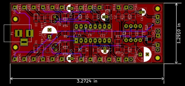

Here is my SMD Board Layout, which was the point of creating the schematic in KiCad. I'm rather proud of it. There's a lot of stuff packed in ~1.3"x3.3". I have ordered the boards; we'll see what we get...
I am also including a pdf of the schematic, for any interested non-KiCad users.

Nice job on the WSG PCB. Interested to know how this turned out? Do you have any finished boards ?
I have been using using Proteus ISIS/ARES for all my designs and simulation but the KiCad package looks real nice Very Happy
