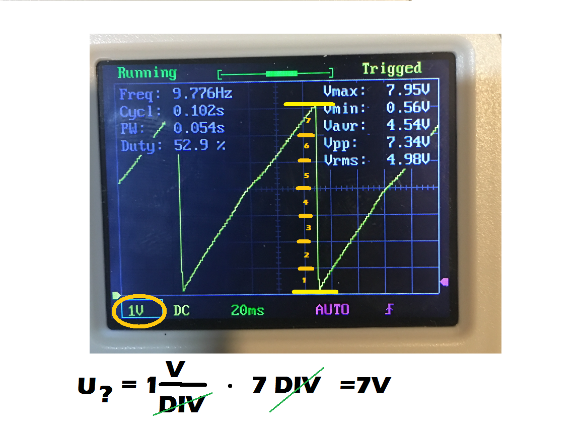

PostPosted: Sat Nov 16, 2019 6:56 am    Post subject: Triangle = saw Reply with quote  Mark this post and the followings unread
Hi there, was there ever a solution to this problem? As I have a similar issue in that the triangle is a uniform saw which also resultis in a weird sine. I have a good saw and square, so that would leave me thinking that it’s somewhere within the triangle wave shaping that the problem lies. I have changed every ic every transistor, all caps several resistors. Also t2a and b have no effect on the circuit what so ever and I have also changed those. Oh and also I have changed the four diodes. Also the duty cycle of the pulse starts at 70%.
Thanks for any help, Ryan

well just fishing around:
measure the outta pins of the saw offset trimmers, one pin should have 0V and the other about 10V, if pots/trimmers have no effect often one side is not connected
if you have a good saw, where do u measure it? what is the amplitude?
note also that in yves schematic is an error, R17 (200k) exist two times, but one should be 100k (ic2a in the schemo)

PostPosted: Mon Nov 18, 2019 1:44 pm    Post subject: Reply with quote  Mark this post and the followings unread
Here is a (cheap) scope image from pin 14 of ic 2, same reading as pin 7.
I’m only getting 20% of the duty cycle of the pulse too.

PostPosted: Tue Nov 19, 2019 11:53 am    Post subject: Reply with quote  Mark this post and the followings unread
Here is the scope set to DC. As I mentioned I’m very new to this so still not 100% sure how the read these things properly. Thanks for your help though mate

PostPosted: Wed Nov 20, 2019 4:14 am    Post subject: Reply with quote  Mark this post and the followings unread
ur welcome, we all have started some-time-some-where
i can imagine there are tons of yt-videos about scopes,
but the most basic thing is measuring the amplitude of a signal:
count the divisions between the highest and the lowest point of your signal:
yours has roughly 7 Divisions, then you multiply the divisions with volt-per-division-value, which is in your case 1V/DIV
so your signal has an amplitude of about 7Vpp (peak to peak)
or on your scope u could calculate Vmax - Vmin=7,39V
but the waveshapers are expecting 10Vpp!
hm, that smells somehow like a 12V powersupply?

PostPosted: Wed Nov 20, 2019 5:05 am    Post subject: Reply with quote  Mark this post and the followings unread
just saw that u mentioned a 12V power in the other tread.
so in theory the amplitude should be 12V*66%=7,92V
in reality you have measured 7,39V
u can correct that by changing the resistor combination R14/R17,
by default they should 100k/100k
theory: the factor between 10V and 7,92V is 1,262
so we could use:
100k / 126k
79k / 100k
68k / 85k
50k / 63k
39k / 50k
reality: the factor between 10V and 7,39V is 1,35
then it would be:
100k / 135k
74k / 100k
68k /92K
50k / 68k
or just use a trimer, do you have one laying around?
