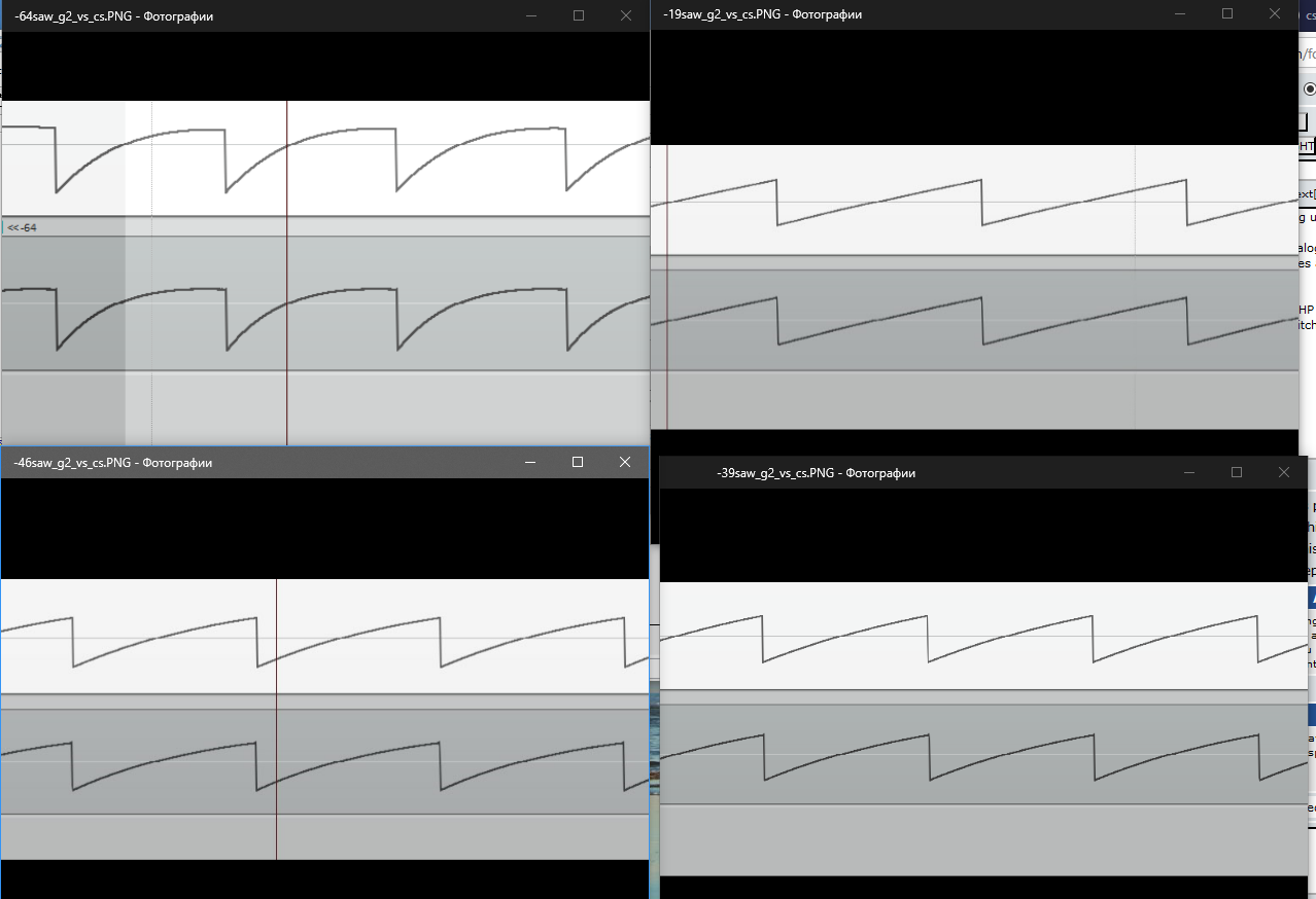

Hi folks! Some intriguing update here!
Since Clavia has an analog part, which obviously includes some high-pass filter, the recorded waves are different comparing to demo 'digital only' recording.
Today we modeled the HP filter and here are some results for saws from OscA at -64, -46, -39 and -19 pitches, compared to corresponding from our Csound models.
I like it!

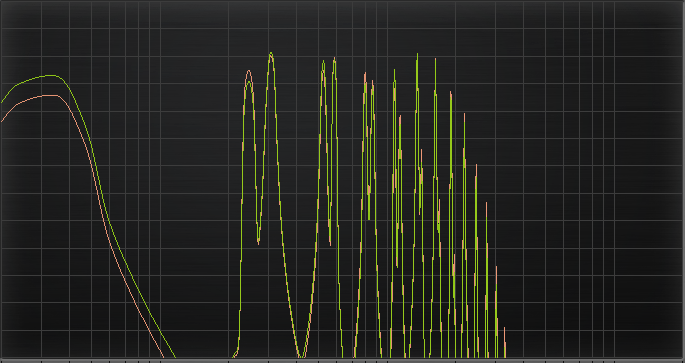

Hey people! Here are some fresh results of FM modeling through simulating OscB/OscC modules. One color is original NM2, another - our Cs model.

.Here are some fresh results of FM modeling through simulating OscB/OscC modules. One color is original NM2, another - our Cs model.
Looks good to me. We don't want to make the perfect the enemy of the good. Smile

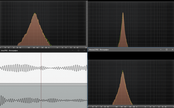

PostPosted: Wed Mar 28, 2018 1:05 am    Post subject: On OscNoise Reply with quote  Mark this post and the followings unread
Hey ppl!
Here some news from our labs! This time we got a OscNoise model. We use simple non-linear feedback filter. As it used to be, one color is Csound, another is for Clavia. Also some waveforms included.
.PNG
OscNoise
 Filesize:  505.23 KB
 Viewed:  624 Time(s)
.PNG

That's pretty close Smile

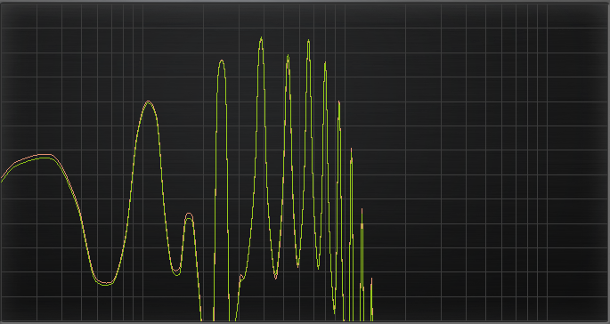

PostPosted: Sun Apr 01, 2018 7:14 am    Post subject: More FM/PM Reply with quote  Mark this post and the followings unread
Friends,
here are more modeling results for OscPM, which soon will be uploaded to our repository. Enjoy!
 Filesize:  450.66 KB
 Viewed:  634 Time(s)

Hi gleb812!
Nice! Excelent results !
I'm a bit busy actualy. But I follow all updates. I will take more time to test and work on the project soon.
Big respect to you, your team and all the others who join the project!

Yep very good results. Busy here as well, I need to look at the book!

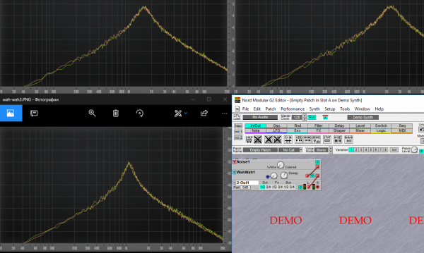

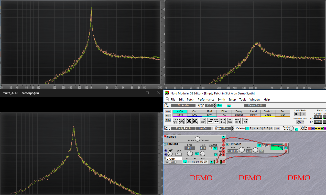

PostPosted: Sun Apr 08, 2018 1:56 am    Post subject: Filters... Reply with quote  Mark this post and the followings unread
Hi folks!
What about reversing some filters? Not the top ones for this type, but nevertheless worth doing.
Today we have FltMulti, FltStatic & Wah-Wah. All seem to be pretty well modeled by Csound's statevar filter, which is in turn a digital implementation of an analogue state-variable filter.
The first series of pictures is from FltMulti/FltStatic in 12 dB mode, without GC.
The second series is Wah-Wah. Just a BP, but with gain and Q changing across the freq range + some small static high shelf around 17k+.
G
FltMulti/FltStatic vs Csound statevar
 Filesize:  593.05 KB
 Viewed:  585 Time(s)
Wah-Wah vs Csound
 Filesize:  491.34 KB
 Viewed:  620 Time(s)

Looks good to me. It doesn't have to sound exactly like a G2, just close enough.

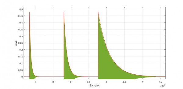

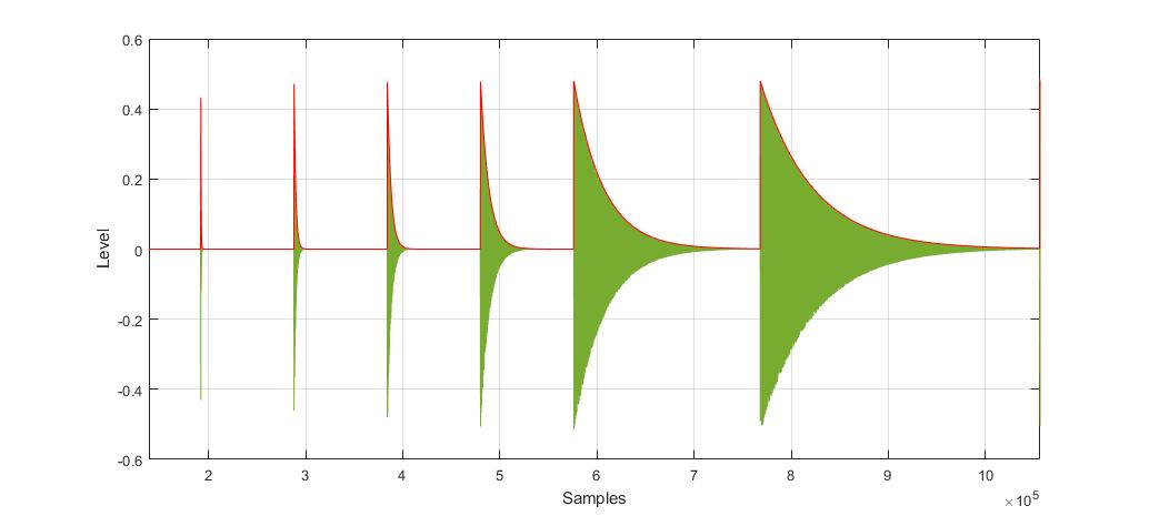

PostPosted: Thu Apr 12, 2018 10:59 am    Post subject: Decay Reply with quote  Mark this post and the followings unread
Hi folks!
Today we have a math model of NM2 exponential envelope.
On the pictures below the green signal is an original enveloped noise from DrumSynth, and the red envelope is our envelope model.
The function we use is
Env = exp(-4.7 * x / DecayTime)
More interesting things to come later....
 Filesize:  33.21 KB
 Viewed:  520 Time(s)
 Filesize:  37.19 KB
 Viewed:  520 Time(s)

Looking good again.
