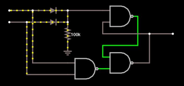

This is how I did it. You can play with it here: http://tinyurl.com/ydz4g9w7
In the simulation I added two 10K pull-down resistors in the input that you won't need if you feed it logic signals. The 100K resistor and the two diodes are for the wired-OR gate.

Heh! I didn't notice I could get rid of the NOTs by taking the other output. Well done.
