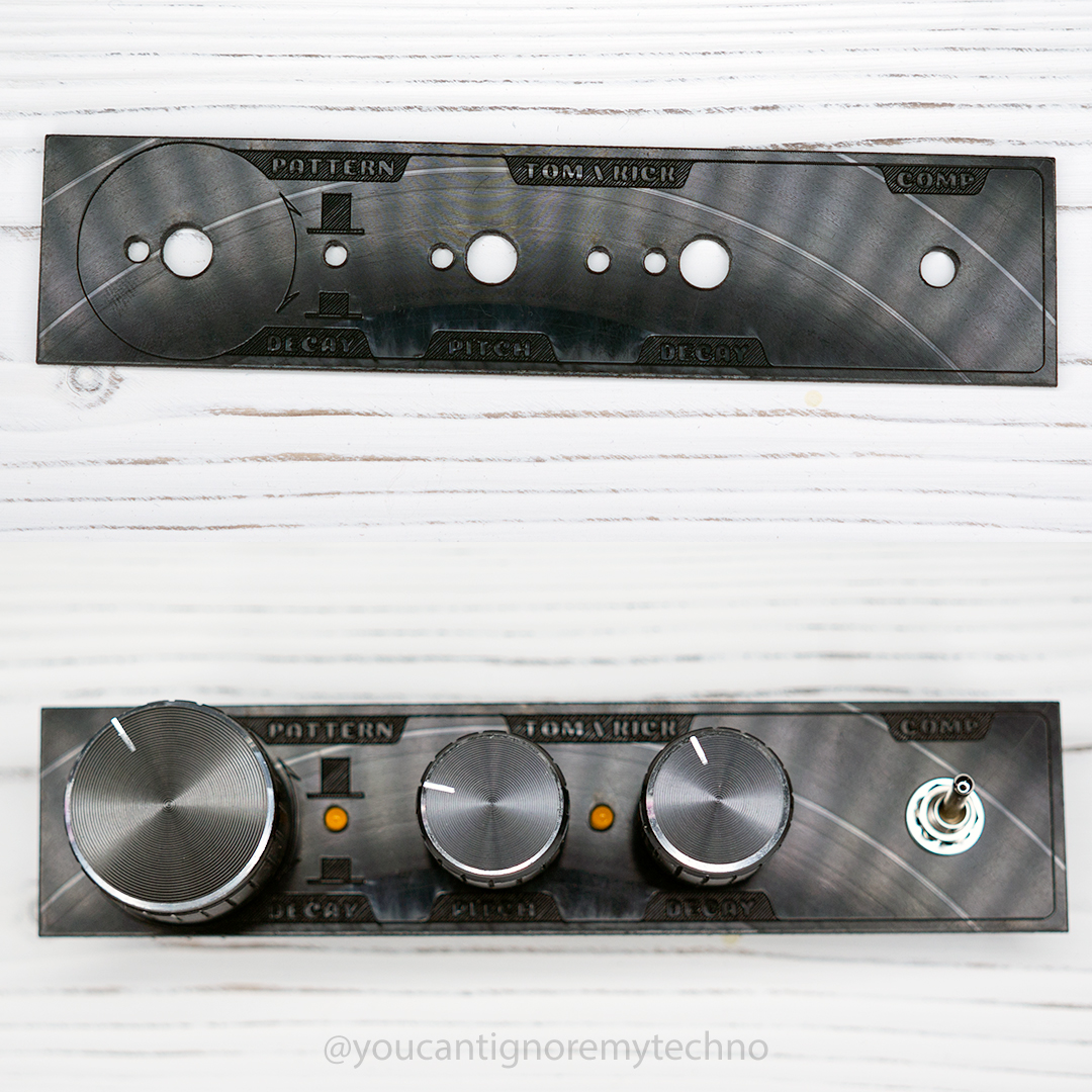

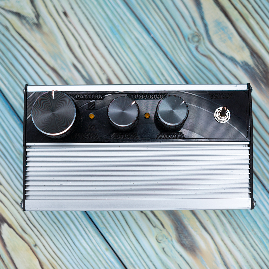

I've used for tom/kick Wien bridge based oscillator. I'ts working great with 4069. Only sidechaining part of the main circuit still isn't ready.
But I started to make case out of e-bike controller box. Sides are laser cutted vinyl.

PostPosted: Sun Jul 22, 2018 2:48 am    Post subject: Reply with quote  Mark this post and the followings unread
Face deck

Posts: 5950
PostPosted: Sun Jul 22, 2018 7:52 am    Post subject: Reply with quote  Mark this post and the followings unread
great idea with the lasercut vinyl Very Happy
sounds good too.
Hammer
Joined: Mar 13, 2018
Posts: 72
Location: Russia, Zhukovsky
PostPosted: Sun Jul 22, 2018 9:06 am    Post subject: Reply with quote  Mark this post and the followings unread
Thank you, PHOBoS!
A lot of interesting stuff could be cutted out of vinyl: https://www.instagram.com/youcantignoremytechno/
But it's not easy beacuse of releasing chlorine and condensating hydrochloric acid. CNC should be very good oiled, smoke should not stay in the room. Otherwise everything will be covered by rust.
