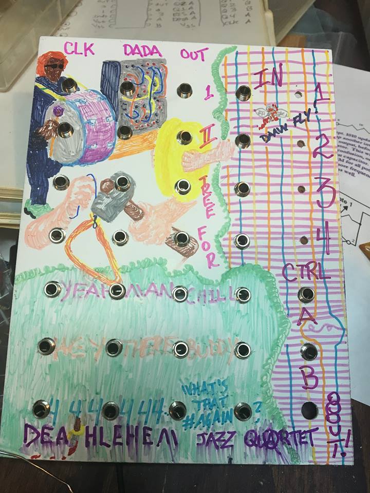

Back to Lunetta'ing for almost 2 weeks now, this damn brain of mine keeps spitting out new ideas to try. I'm very happy with the results from testing this one yesterday. I should have it fully completed, today.
I've done a quick search on here for the CD4015 dual 4 BIT Shift Register and haven't found anyone else posting sequencer schematics using it. I'm sure I'm not the 1st person to do it. Anyone else?
Anyhoo ... with 4 BITs output to an R-2R DAC, we can have up to 16 different pitches. With their being 2 x 4 BIT Shift Registers on the 4015, we can have 2 different 16 pitch sequencers!
Using 2 of these chips? 4 sequencers.
To tie everything together, to have up to 4 different patterns that can be selected for playback, I went with the CD4052, which is a dual 1 to 4 or 4 to 1 multiplexer. The minor problem with it is, both of the multiplexers operate from the same A and B controls, to decide which of the is active.
That's ok though! Whilst 1 of them is used to receive the 4 sequencer inputs, the other one is used at the same time, to light an LED for each, to see which one is currently active.
And there we have it! As well, I realized / remembered this morning - each of the outputs from the sequencers, can be fed into the Data input of another sequencer, to have sequence lengths of 4, 8, 12 or 16 steps! Very Happy
Here are pics of the quickly thrown together schematic as well as almost finished panel.
Any questions or errors you notice? Fire away. I'm open to being shown something that I may have done incorrectly / et cetera. Smile
This is the quickly drawn schematic for the Deathlehem Jazz Quartet
 Filesize:  99.93 KB
 Viewed:  759 Time(s)
This is the almost completed panel (Missing LEDs and jack nuts) for the Deathlehem Jazz Quartet.
 Filesize:  113.13 KB
 Viewed:  700 Time(s)

I have completed a 4 x Sequencer version of this with a multiplexer, to decide (if it it is used) which sequence is currently active. It has 1 bug I have to solve before I make a video of it as well.
Each of the 4 sequencers, have their 4 BIT outputs, wired to that sequencer's own 4 BIT R-2R DAC. The output of each DAC, is brought to a panel jack. (Each sequencer has it's own Clock and Data input, as well.)
There is also a patchable 4052 4:1 multiplexer, to plug the sequencers into, to decide which one is currently active.
I have 1 bug to work out (sequencer #'s 1 and 3 are not running). Once I've solved it, I'll shoot another video to demonstrate some of the ideas from it. Smile
