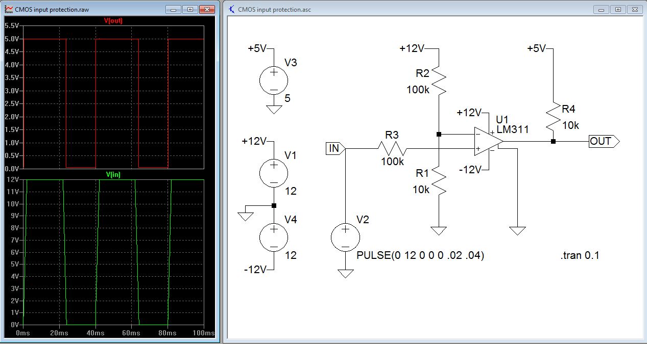

PostPosted: Tue Aug 21, 2018 2:13 am    Post subject: Reply with quote  Mark this post and the followings unread
i just played a little bit in LTSpice and maybe the best and most rock solid method was to use a 'programmable' comparator.
here you power the comparator from the rails, while you program the output to be 0V to 5V. see attached picutre.
and this has one big advantage: the input can now work with everything, even a sine wave could be used to drive the CMOS.

PostPosted: Tue Aug 21, 2018 2:14 am    Post subject: Reply with quote  Mark this post and the followings unread
looks more complicated than it is. one 8pin IC and 4 resistors.

PostPosted: Tue Aug 21, 2018 2:21 am    Post subject: Reply with quote  Mark this post and the followings unread
thank you. from what i see there, it is much more place on the board and more parts. is there a remarkable benefit from this approach? since my test with the third diode in front kept negative voltages away, too
PostPosted: Tue Aug 21, 2018 2:46 am    Post subject: Reply with quote  Mark this post and the followings unread
yes, it is one DIP8 and a resistor more. but as i said, you now can process anything, not just pulses.

PostPosted: Tue Aug 21, 2018 9:21 am    Post subject: Reply with quote  Mark this post and the followings unread
from what i understand is that some (or all) circuits don't understand a rising voltage as a gate signal. at least my test i just did brings me to that conclusion. when i create a triangle wave form between 0 and 8 volt and feed this into the protection circuit it doesn't trigger the dinky taiko. however if i shorten the rise time there is some point at which it counts as a trigger signal again.
so, if the comparator circuit creates a nice trigger signal at one point, it would be the solution for a wider scaled input scenery. if i get all this correct Wink
Posts: 24673
PostPosted: Tue Aug 21, 2018 9:26 am    Post subject: Reply with quote  Mark this post and the followings unread
Ah .. ok ... hysteresis added ... had assumed the CMOS input port would have done that. And was reasoning the other way around .. that the protection diodes would be better in passing "any signal" (as in that it will work for analog inputs too).
