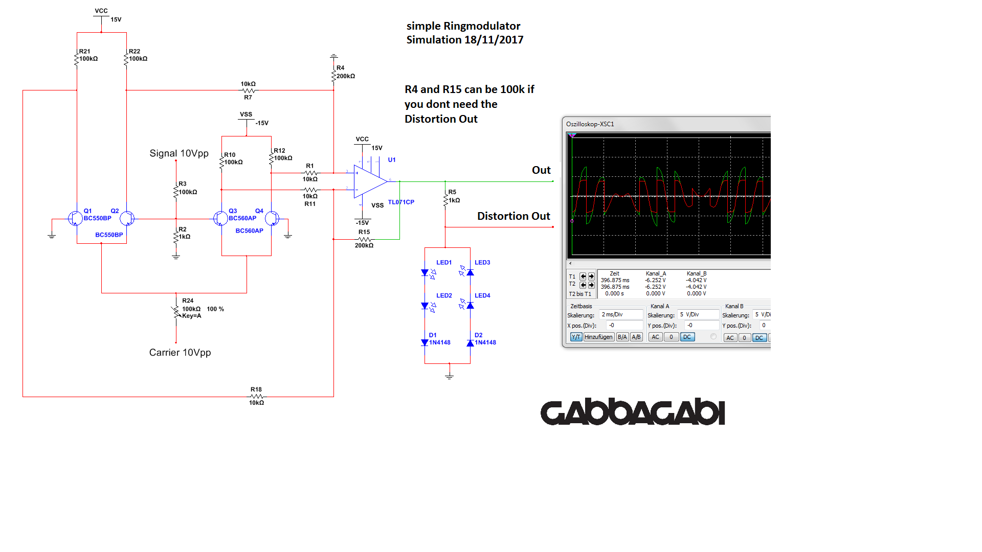

gabbagabi
Joined: Nov 29, 2008
Posts: 652
Location: Berlin by n8
PostPosted: Sat Nov 18, 2017 5:06 am    Post subject: Reply with quote  Mark this post and the followings unread
thx!
find attached a simplyfied-Version-Simulation.
ps: the k in function is to show what is in my opinion misspelled in english Smile
I am still thinking about that frequency-shifting-thing - but it is a hard nut - thx for the challenge.
