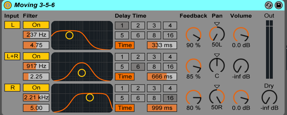

I have been experimenting with various kind of post-processing FX in Live, downstream from my 3 mixers. All feedback-driven signal generation is in the mixers, with Live FX post-processing downstream from the mixers. The idea is to be able to tickle characteristics of a Live FX without taking hands off the mixer.
Here is a simple example. (I am saving the rest up for the summer solstice webcast.) Tune the stereo pair in my mixer, one to high pitch and the other to low pitch, and then send them to a filtered delay in Live. In the pictured delay I have knocked the mid-range out all together (gain = -infinity), and set the high frequency range to echo at 3 times the period of the low frequency range, giving me multiple rhythms.To get anything out of a delay, things need to change from time to time. Otherwise you just have sustain.
It was necessary to make the feedback higher on the faster delay, otherwise it decays much faster than the other.
You can then sweep pitch from the mixer, manually or using mixer FX, to vary the effect. You could put the Live patch's delays on a foot controller, so as to keep hands on the mixer. I haven't done that yet. This recording just illustrates the basic idea.
The Live patch
 Filesize:  102.06 KB
 Viewed:  1090 Time(s)

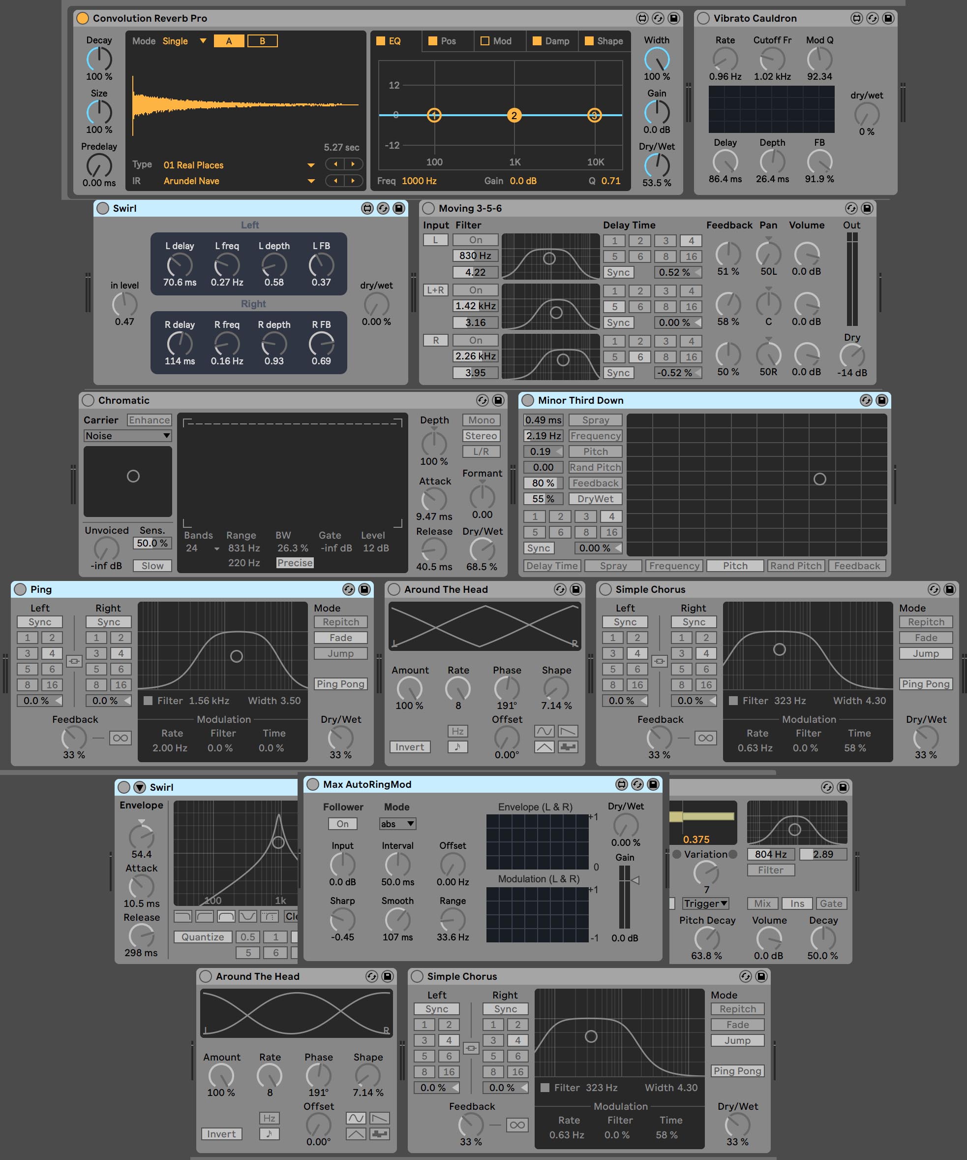

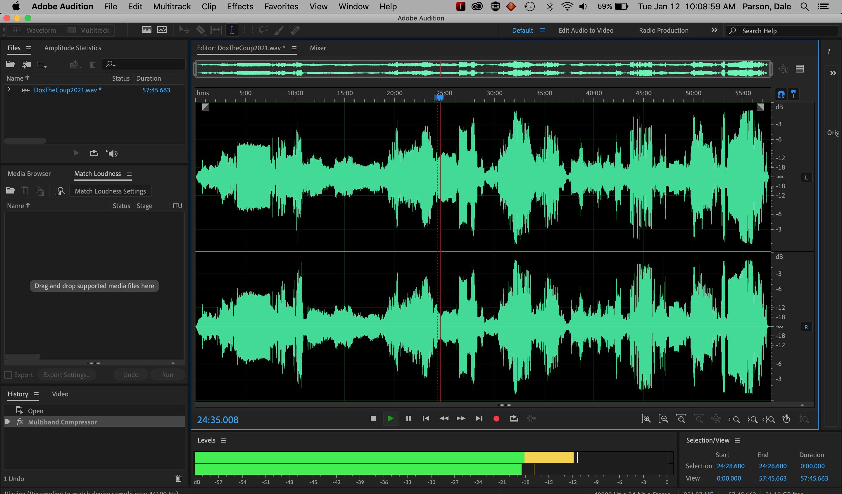

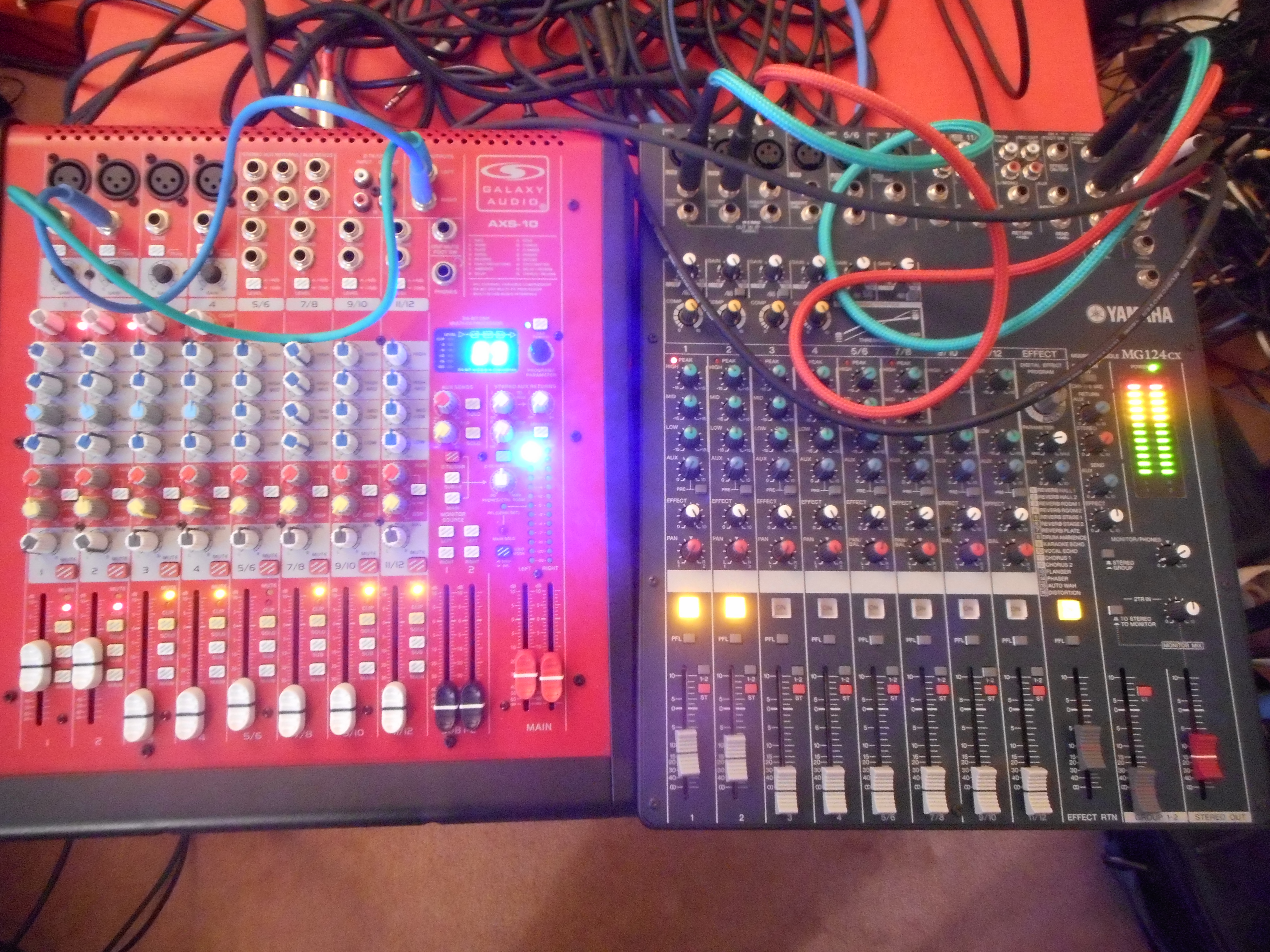

PostPosted: Tue Jan 12, 2021 11:26 am    Post subject: Dox the Coup
Subject description: Sonic response to attempted coup in U.S. Capitol 6 July 2021
I decided that before I Tear down the New Year's Eve arrangement of mixers in my study in preparation for another busy semester of teaching Crying or Very sad , I should improvise & record a ZIM piece.
This 58ish minute piece Dox the Coup is inspired by the traffic on social media during and following the attempted coup on the U.S. Congress on 6 January 2021, which was inspired by their fascist leader. It ain't over yet. The title Dox the Coup is inspired by this hack on the parler social media site where much of the planning for violence took place. Amazon Web Services dropped hosting their media site on Monday morning, following Google's and Apple's dropping distribution of their apps, but not before this hacker got in with admin permissions, grabbed everything, and posted it publicly. The FBI undoubtedly has done the same, but now this dataset is available to journalists and the public. I'd have my data science students dig into this dataset if I had time for a new project. I am eager to see what gets spilled. We have some fascist supporting legislators in Pennsylvania. Unfortunately I live in the U.S. House district of one. We have been flooding him with pretty intense feedback lately.
The first 24:33 minutes are strictly the red Galaxy AXS-10 and Yamaha MG124cx mixers, sometimes pure feedback-driven tones shaped by the analog EQs compressors & level adjustments, and sometimes coupling their DSP effects units into the feedback. I got a lot of sonic variety out of just the mixers.From 24:34 until the end I used the pictured Ableton Live and Max-for-Live audio fx (one or two at a time) on the output of the mixers. I mostly avoided duplicating in Live the chorus/phaser/flanger/reverb variations available within the mixer DSPs. The idea was to use Live to complement mixer capabilities. Live delays, harmonizers, rhythm generators using LFOs, whatever you see there. I did give each mixer its own always-on Max-for-Live reverb, and put a compressor in front of the record track in Live to avoid the worst of the semi-unpredictable feedback explosions.
Before recording I experimented with cross-coupling the mixers into one feedback loop, but that lost me two independent voices with no sonic advantage. I also skipped working with Live-to-Live feedback. This setup was enough.
Listening in bed last night there was still one passage that felt like having all of my teeth drilled at once, but I cannot find it today with the same headphones and volume level. I had to do some level descaling and selective frequency band compression on the mixer+Live second half. There were some appropriate ugly sounds at the low- and high-end frequencies, but I'm afraid I stepped on them a little forcefully in the interest of preserving listeners' hearing.
Here is my soundtrack to the bullshit going on here today. Not a sonic Guernica , but with any luck we can avoid that level of trouble.
the mixers
 Filesize:  7.71 MB
 Viewed:  318 Time(s)
Live patches
 Filesize:  468.95 KB
 Viewed:  270 Time(s)
chasing down dangerous tones in Adobe Audition
 Filesize:  475.2 KB
 Viewed:  267 Time(s)
