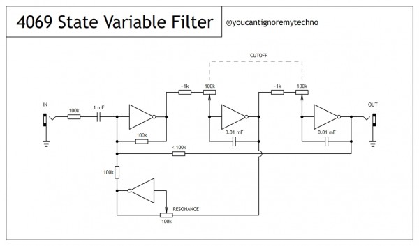

Hello!
This is just one more 4069 SVF, but with additional BP feedback, which makes it more "waspy".
Example with 561LN2, sorry for accent: https://www.youtube.com/watch?v=6Vt1AKOakLE

Filer sounds good and dirty !! What is the range of CV on the FET transistors?

Hello, Bill!
The range of CV is between 0 and 2.5V

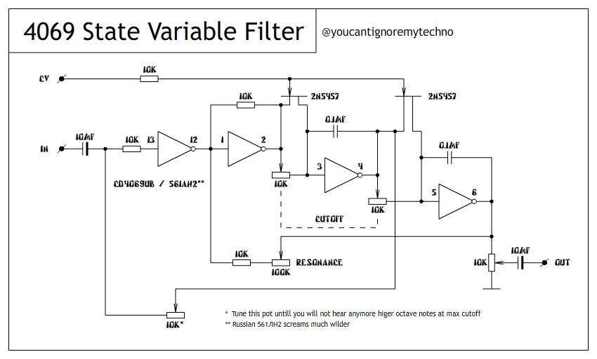

One more 5V single supply 4069 SVF, very musical and simple, inspired by this topic: http://www.electro-music.com/forum/topic-29678.html
Tested on breadboard.

What is the Drum envelope generator you're using???
oh man, how does that resonance even work?
This one:
Are you mean the second filter?
I do not really understand why, but when you block resonance with parallel cap. in long fedback line, it's starting to resonate when you change coefficient of summing amp.

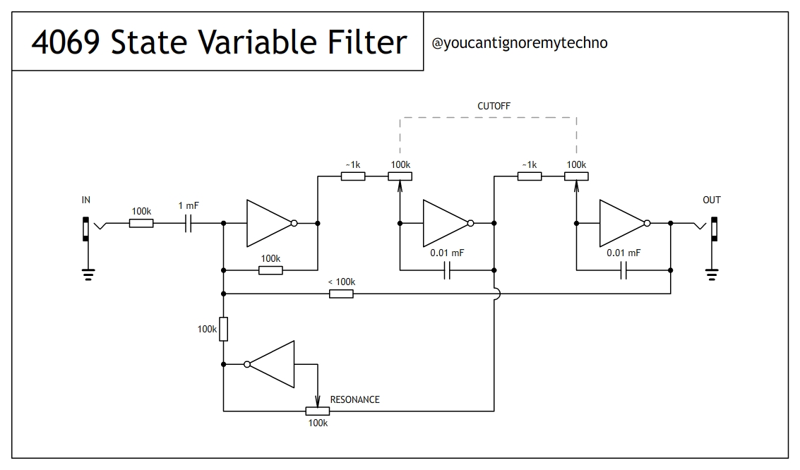

One more CMOS LPF design!
I've read the article written by people who are much smarter than me: https://ftp.unpad.ac.id/orari/orari-diklat/teknik/homebrew/filter/active-filter/docs/A%20Beginners%20Guide%20to%20Filter%20Topologies.htm
New design have much cleaner resonance and less distortions.
1. If you will remove ~1k resistors, you will have no resonance when filter is open.
2. Feedback resistor should be a little bit less 100k:
> 100K - distortions
< 100K - more resonance, lower amplification
Just find your value.
Certainly better to use 561LN2 Very Happy

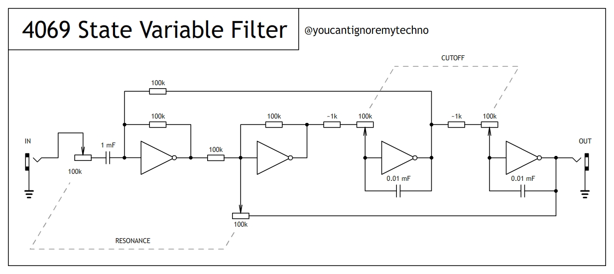

And here is the newer newer version. Almost linear resonance and a loads of it. Self oscillation and so on. This version works better with CD4069 unbuffered. Low pass bypass and hipass also available.
Tested on breadboard with digital potentiometers.
To change cutoff with CV use digital 100K pots and an arduino right?
I have the audio demo of the original design finished, will post it soon.
Hammer
Joined: Mar 13, 2018
Posts: 72
Location: Russia, Zhukovsky
PostPosted: Sun May 26, 2019 2:53 pm    Post subject: Reply with quote  Mark this post and the followings unread
Not exactly. I do not use CV, Arduino have simple decay envelope function and analog pot. to control decay. It's only gate signal here.
Digital 100k pots connected in series with analog 100k pots to have manual control of cutoff. Low end of one digital pot is connected to the 1/2 Vcc, it works like VCA.
I haven't decided yet, do I need fully functional ADSR, CV, or just single pot, like Korg Monotron have. Single pot also can have slow and fast attack angles.
You can hear some hiss sounds, but this is because it's builded on breadboard and use USB power right from PC without any capacitors.

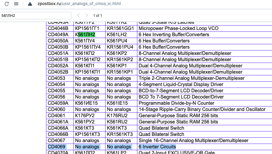

reviving this thread after 1.5 years with a question as I have started to test your filter.
when I check for Russian CMOS chip equivalents I find no 4069.
and К561ЛН2 is supposed to be a 4049 according to this page http://zpostbox.ru/ussr_analogs_of_cmos_ic.html
is this correct? not a problem anyway but important to consider regarding the pinout Cool
К561ЛН2 have the same pinout as 4069U. And both inverters are unbuffered.
К561ЛН2 have higher frequency of operating i.e. higher "resolution".
Check this PDF https://static.chipdip.ru/lib/031/DOC001031294.pdf
Now I think that any another unbuffered CMOS hex inverter with high frequency of operation (> 2 Mhz) will be better than too old but cool К561ЛН2. Maybe 4049.

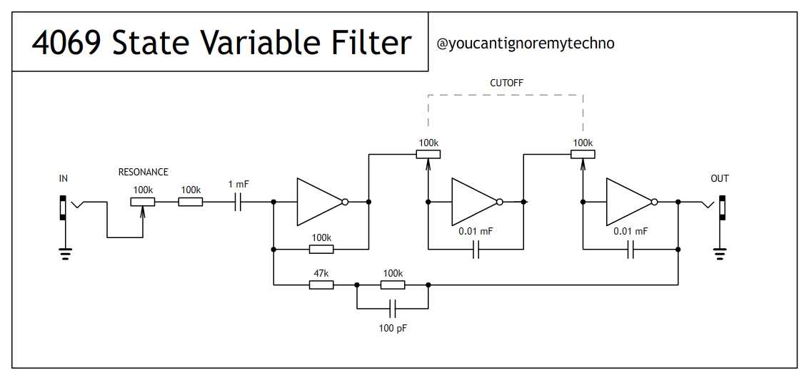

Hello! Greetings from Argentina. While searching for variable filter circuits, I ended up here. I designed a PCB based on the schematics I found in this forum and added an output for the high-pass filter.
