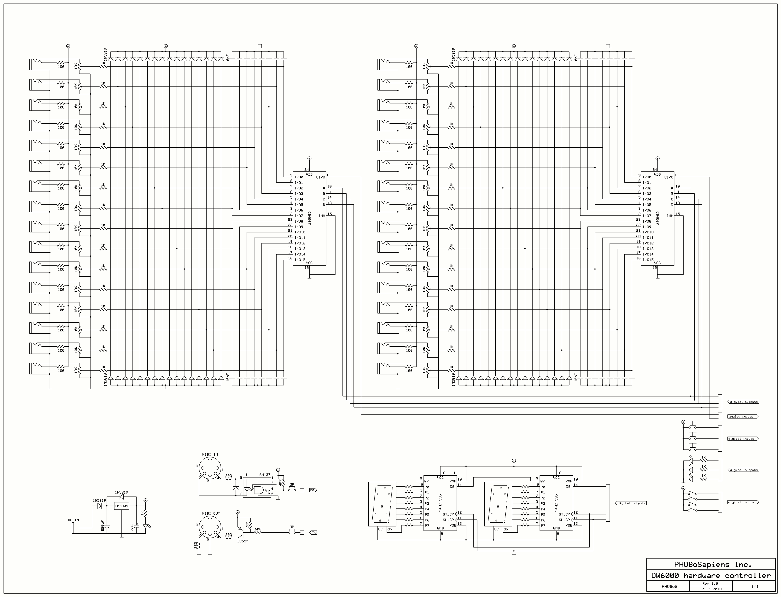

I finished it over the weekend Cool . I also added a DC output to the DW6000 with a diode and fuse in series as protection.
(will post the arduino sketch after cleaning it up a little bit)

Here's the schematic.
(note that I drew 32 controls but in reality it only uses 30 of them)

my schematic reading skills aren't that good, but who cares.
well, the schematic tells you what parts you need and how to connect them so it is rather essential to understand how to read it Wink
It's not very complex though, just has a lot of repetition. each paramater has a potentiometer and a protective network in case an
external CV is used and all the potentiometers are connected to multiplexers to expand the number of inputs on the arduino. There
are some switches (with LEDs), a midi input and a midi output and the LED displays which use shiftregisters to control each LED indvidually
with only 3 arduino pins. I used a 5V regulator for power but the onboard regulator on the arduino might be sufficient as the circuit
doesn't draw a lot of current.
Note that this is not really a beginners project. There is no kit with parts, no PCB just a schematic and some code (that you will probably
have to adjust a bit). So you will need some DIY experience to pull it of.

PostPosted: Fri Jul 05, 2019 5:32 am    Post subject: Reply with quote  Mark this post and the followings unread
i'm talking about this...
 Filesize:  462.72 KB
 Viewed:  322 Time(s)
panthera86
Joined: Jan 08, 2019
Posts: 9
Location: Zamunda
PostPosted: Fri Jul 05, 2019 5:33 am    Post subject: Reply with quote  Mark this post and the followings unread
Phobos!thanks for the explanation of the code,
that will help me understand what is going on in the code
