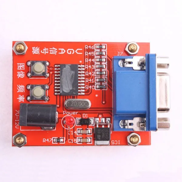

Second: I found a quick and easy way of generating a VGA sync and VGA video signal via cheap sync board that can be found on ebay/aliexpress:
They look something like this and can be found for under 10 dollars US. The trick is to short the RGB input pins on the board to CV. This can be done in under 10 minutes and produces some interesting results. Someone has documented this approach here: https://jonasbers.com/chav/

dianusindustrial wrote:
Hi cerkit! Glad someone finally showed interest on what I had wrote about the subject. Since writing I have made two significant breakthroughs in designing a simple Lunnetta video synth.
First: I found another design for a more cohesive sync generator via this hackaday project: https://hackaday.io/project/9782-nes-zapper-video-synth-theremin/log/32282-vga-porching;cid=1481971505084-221
It uses several TTL chips so perhaps closer in character than the 555 circuit. I also had a separate discussion in the tagboard forums about creating a strip-board layout that would be much easier to follow for contstruction: http://guitar-fx-layouts.42897.x6.nabble.com/VGA-Sync-Generator-td31501.html
Hopefully that helps get you started in Lunetta video! Very Happy
