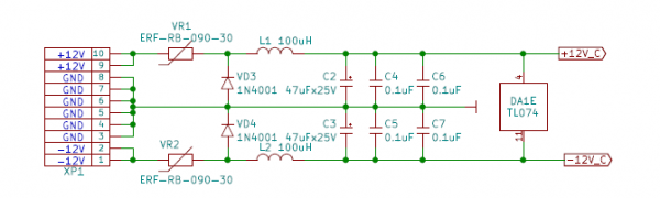

I noticed in my Arduino module driving LED matrix that there is an audible (in headphones) electric noise on some powers supplies (e.g. from USB) and on some is not. I also have not ferrite beads on the voltage lines (although I know I should). Good project always has good supply filters, like this one from Erica Synths, for example:
