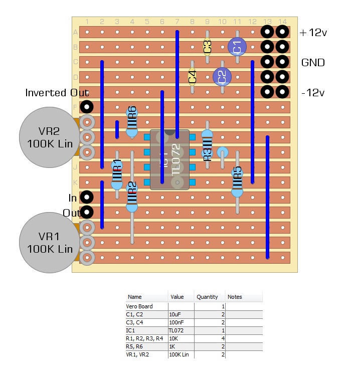

Hi all,
I'm new to laying out stripboards, and I wanted to do something simple, so along with the magic smoke 8k LFO I attempted this circuit, which is the voltage source from Ian Fritz' Super Sample & Hold.
I haven't built this one yet, but I thought I'd post my layout here and see if any of you stripboard gurus notice anything glaringly and embarrassingly wrong with it! Shocked It's literally my 2nd layout ever, so I would be shocked if it didn't.
Below is the layout and the original schematic.

Here's an attempt at a standalone Rungler. Thought I'd post it here rather than start a new thread... any corrections would be much appreciated. (I'm sure there's a way to do it in a lot less board space, but right now I just want to get it working.) Subbed a 4094 IC so it can run off +12v.

u need to forgive the forum members for not responding,
controlling stripboard designs that u not have done urself is not the most enjoy-able activity Smile
eventhought ur design looking quite clear.
PostPosted: Wed Mar 13, 2019 12:17 pm    Post subject: Reply with quote  Mark this post and the followings unread
Your Rungler is going to blow up.
In the original circuit the rails are +9 and -9, and the 4021 is powered from +9 to -9.
While you're running your 4094 off of 0 -> 12V so it won't have a problem there, you're running your op amp at +/-12V and that will fry the data in on the 4094 when it's low.
You *should* be able to get away with using a single-supply op amp instead of the TL072 (it will *not* work without a balanced supply). I'm not having any luck finding single op amps with single supply (I know they exist, but I can't remember, and my datasheets will take a long time to sift through), but you could use an LM358 for example and just ground the inputs of the second amp.
For sure. I was just putting them up to get a second set of eyes, in case there was anything immediately apparent that was obviously wrong -- such as
Shocked Shocked
good catch elmegil. I see input voltages are supposed to be between -0.5v and supply +0.5v. Could I use a diode rectifier or a similar scheme to kill the negative half of the waveform?

PostPosted: Thu Mar 14, 2019 9:07 am    Post subject: Reply with quote  Mark this post and the followings unread
Am I understanding correctly that the problem is the TL072 is going to be ouptutting a negative voltage in it's "low" state instead of 0v?
In that case I was thinking something like this:
PostPosted: Thu Mar 14, 2019 1:21 pm    Post subject: Reply with quote  Mark this post and the followings unread
Correct in concept, however, it's usually not just that simple.
For one example, going forward through the diode, you will lose 1 diode drop. That *should* be fine, but may not be. CMOS chips like the high value to be very close to the + rail.
For another, when you're reversed and the diode is cut off, there is not actually a "ground" signal at the input of the 4094, so that also may not work, or worse, only work intermittently. I'd consider putting a 10K to ground on that side of the diode.
But this is all just GENERAL advice, I have not tested any of it nor do I have specific expertise addressing -V into chips that can't tolerate -V.

PostPosted: Thu Mar 14, 2019 3:22 pm    Post subject: Reply with quote  Mark this post and the followings unread
Using LM358 for the op-amp seems like the easiest way then... good call!
Should the strobe pin 1 be tied high?
PostPosted: Thu Mar 14, 2019 4:08 pm    Post subject: Reply with quote  Mark this post and the followings unread
You'll still need to address the possibility of a negative going input, but it won't be as difficult with an op amp Smile There are examples of this with op amp inputs available in schematics for things like the Orgone Accumulator which is open source.
As for strobe, that's how I would read the verbiage at the start, but the timing diagram is confusing me. You'll need to look at that more, or maybe just use the 4021 like the original.

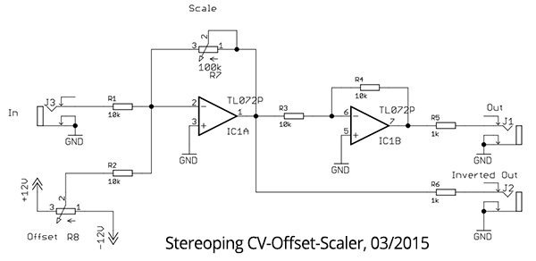

Here's one for Stereoping's Scaler/Offset utility module.

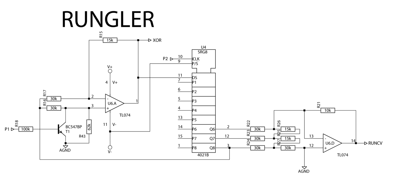

w/r/t the Rungler, here is how the data input works on Andrew F's 8-bit cipher. (Think I'm going to just build that, since it does everything I would want from a standalone Rungler!) But looks like a similar scheme could be employed on the standalone rungler using a CD4094.
(the inverting op-amp inputs are also tied to ground via a 10k resistor, that part was cut off.)

lol building that Rungler on stripboard sent me down a long rabbit hole of shift register sequencers and LFSR noise. And somehow I ended up right back at this thread by accident.
Anyway, with the benefit of actually understanding the circuit now:
The reason the rungler doesn't "blow up" as Elmegil suggested is because the input stage is a comparator that only puts out high (+Vcc) or low (0v) states for the shift register.
The register bits are sent to an R-2R dac whose output is (on the benjolin) intended to be CV for a pair of VCOs, one clocking the shift register and the other fed into the comparator input (P1).
The result is a bewildering array of "interference patterns"
The reason I wanted a standalone rungler is to basically patch up a benjolin with pre-existing VCOs, but this got me obsessed with shift register sequencers such as the CGS gated comparator, Wiard Noisering, Turing Machine, and the mighty Klee.
