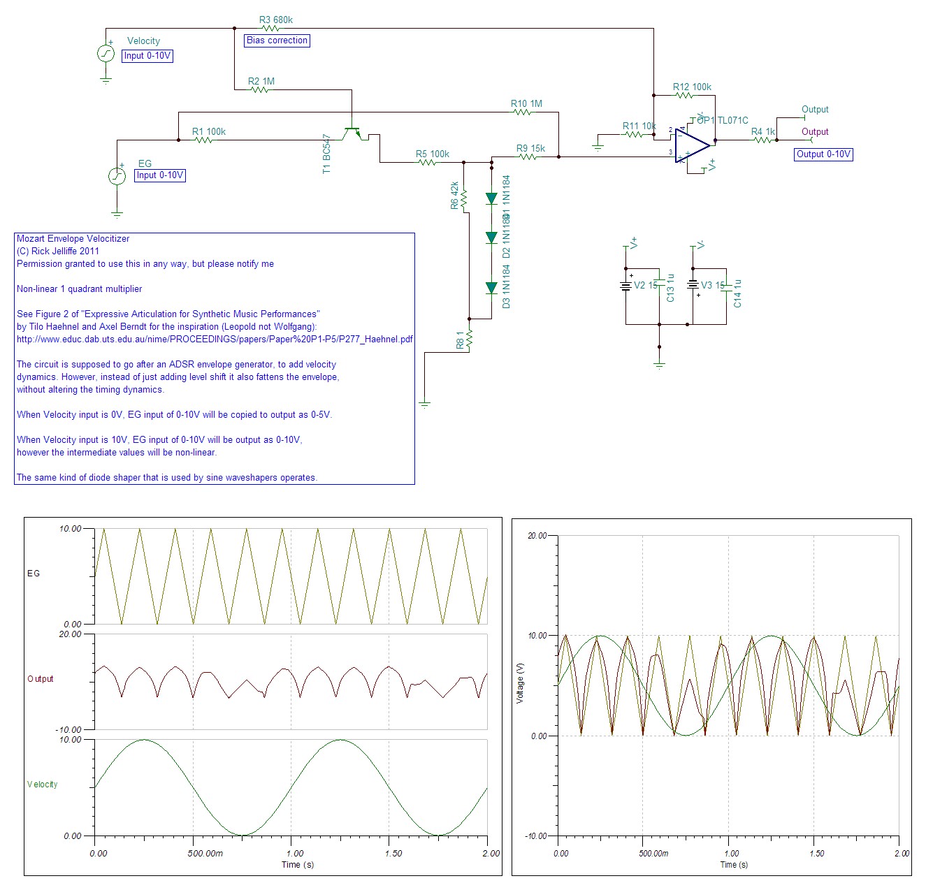

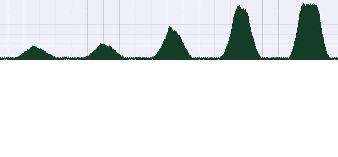

I was reading this conference paper:
"Expressive Articulation for Synthetic Music Performances"
by Tilo Haehnel and Axel Berndt:
http://www.educ.dab.uts.edu.au/nime/PROCEEDINGS/papers/Paper%20P1-P5/P277_Haehnel.pdf
They look at Leopold Mozart's book on early classical/baroque articulations, and do some measurements of instruments. So I thought I'd have a stab at a circuit in SPICE. Here is it, in case anyone is interested.
Basically, we run the ADSR through a multiplier and then into the same kind of sine shaper diode circuit that VCOs use. The result is that at low velocity, a linear ADSR input comes out err linear. But at higher velocity, the input is bent into a curved shape, filling out the note without altering the timing.
Anyway, attached is the circuit, a sound simulation (synthedit), and an eg waveshape.
NOTE: The circuit digram and simulation has a wrong part. For building, the vanilla 1N4148 diode is supposed to be used. And R12 should be halved to 47k, to fit in with Eurorack typical signsl levels. The circuit assumes the EG input has a peak at at least 5V (up to 8V or even 10V) and that the Vel input is from 0V to 5V.

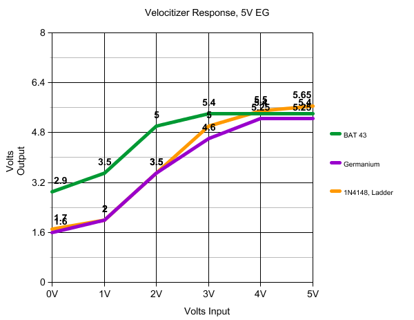

PostPosted: Wed Jun 05, 2019 7:23 pm    Post subject: Responses of different diodes in velocitizer Reply with quote  Mark this post and the followings unread
I have graphed the different Velocitizer responses of three diode types.
* The values of the Elby Kit of their first version, which pretty much follows the circuit above except that BAT43 Shottky diodes are used.
* The same, but with Germanium dides and the feedback resistor (R12 in the diagram above) reduced to 47k to give comparable levels.
* The new version of the Elby kit, which has a little diode-resistor ladder rather than the diode chain, but with 1N4148 diodes and the feedback resistor at 47k as above.
This graph gives the peak output of an 5V AR envelope. This is the kind of levels a system with cooler signals would give. (Note that these graphs are not the simple input/output response for an EG itself, just the value at the input EG's peak. You might imagine the Velocitizer as a distortion pedal for envelope generators, where the velocity of each note alters the "drive" characteristic.)

PostPosted: Wed Jun 05, 2019 8:07 pm    Post subject: Reply with quote  Mark this post and the followings unread
And here is the graph for a "hotter" EG signal, of 6.6V, which is what my CEMvelope module provides.
It shows the wide range of responses possible by varying the different input levels.
I think it shows a couple of things:
First: the BAT43 Shottky diode kicks in early and fast (as expected), but the result is a poor dynamic range of 2 to 1 (loudest is only twice the volume of the softest), the velocity will not be smooth transition from soft to loud but more a velocity switch, and that change happen quite low in the velocity curve. So the effect will be that soft notes are dampened, while medium velocity notes have the same level as high velocity notes (though the fatness of the EGs curves shapes will be different between medium and high, but not much.)
A pretty interesting webpage in diode responses is at
https://jeelabs.org/2012/05/14/forward-voltage-drop-on-a-diode/
Consequently, I don't think the BAT43 is a good choice for this circuit, unless you have a very specific use in mind, such as using a gate to provide the Velocity level.
Second: there is no much difference between the Germanium and 1N4148 responses. So it seems the 1N4148 wins on price and availability (and consistent operation). They both give a much better dyamic range of 3:1 which is, IMHO, a good range for playing.
Third: the level of the EG clips the peak level of the EG (by intention). The rule of thumb is that the maximum level (volts) of the input EG should be greater than the maximum level of the velocity input. If the EG input is relatively lower, the effect will a very compressed signal, with all the dynamics squeezed down to low-velocity and less a range. For example, I have a MIDI/CV converter that produces a 10V maximum velocity signal: I need to pad it down to 5V (or even 4V) to get the widest response.
The Eurorack norms are "Control voltages, as produced by modulation sources like the LFO and ADSR, are typically from -2.5 V to +2.5 V (5 Vpp) for LFOs, and from 0 V to +8 V for ADSRs" and the Velocitizer (with the 1N4148 and 47k feedback) will operate with those, and should be useful just plugged directly in after the EG. You may care to put the CVs though attenuators first, if you want to vary the response and the range of control more finely, but you may find your keyboard controller has different velocity response curves which will save you the trouble.

Thought I'd try this out. But, in the schematic, at the bottom of the string of diodes, we have "R8 1" Is that really 1 ohm?
I can't find an Elby schematic either. Do they not publish theirs?

PostPosted: Sat Oct 01, 2022 7:13 pm    Post subject: Reply with quote  Mark this post and the followings unread
Yes, that 1R resistor can be left out. It was probably there as a holdover from playing with different curves.
