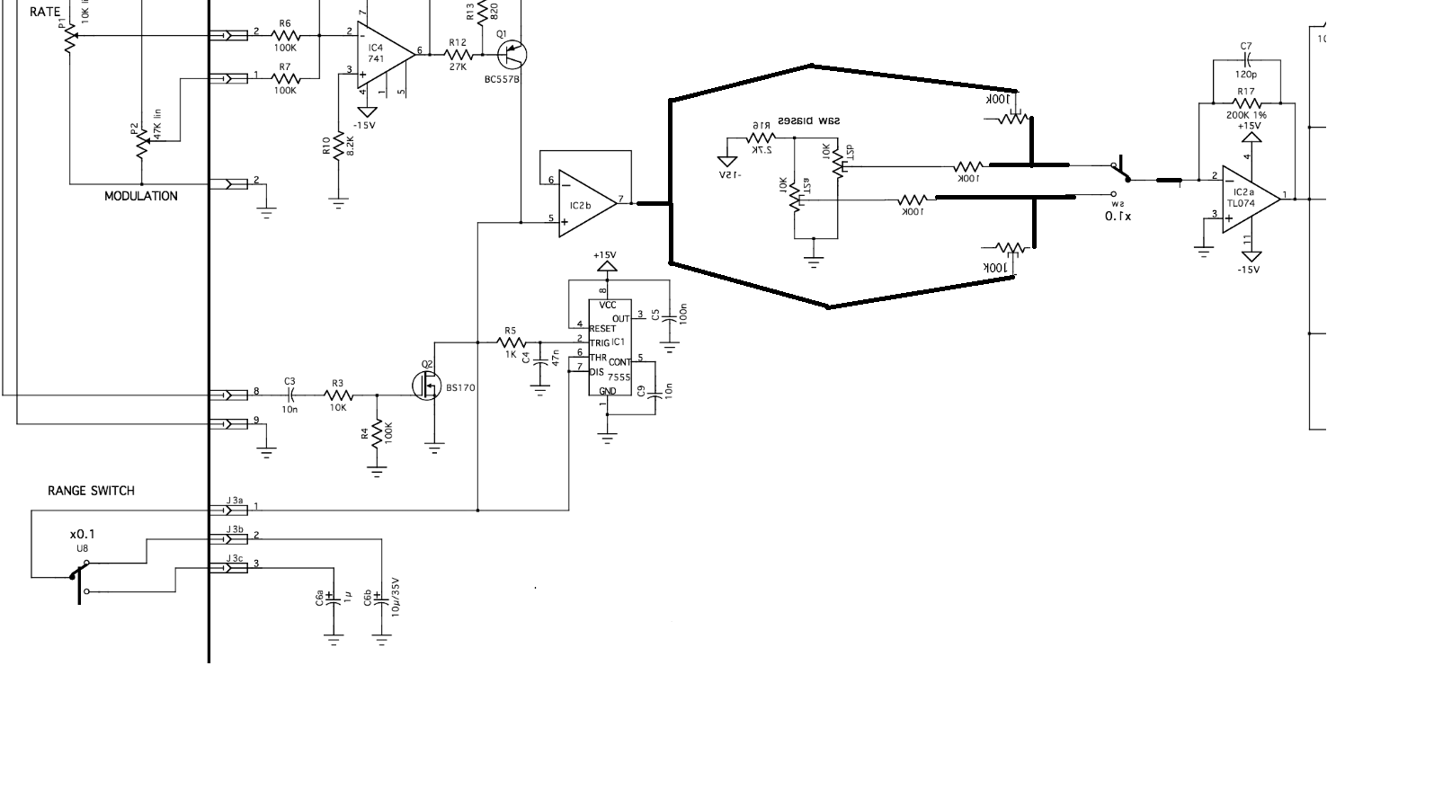

Hi everybody, I built a VC LFO v2 and I am having some problems with it. Here is what I am seeing:
At the sine and rectangle outputs: 10vpp, -5 to +5v
At the saw and triangle outputs: 18vpp, -9 to +9v
At U2, pin 7: 10vpp ramp, 0 to +10v
At U2, pin 1: 18vpp saw, -8 to +10v with range switch at x1
At U2, pin 1: 15vpp saw, -10 to +5v with range switch at x.1
I've read through the pages here checking out other peoples' problems and the recommendations made. Much of the circuit seems to be working.
Thanks for any help. |

At U2, pin 7: 10vpp ramp, 0 to +10v seems to be ok, as far as i remember the 555 switches at 66% supply voltage.
this signal then goes to U2A and will then be amplyfied two times, which gives theoretically 0 to +20V, which is to much and ur measurements at At U2, pin 1 seems to confirm that
for that reason i would try to change R17 to 100k

After reading your reply, I did this: changed R35, the feedback resistor for the saw op amp U2d, to 51k ohms. This halved the signal and I now have a 10vpp saw.
I understand your reasoning for the change of R17 to 100k, but was worried that the saw and triangle would at the proper voltage, but the sine and rectangle would be too low.
Since I have the version 2 LFO, I have a free op amp onboard, and I'm thinking I'll try this to fix the triangle:
Lift the side of R25 connecting it to U3c, pin 8.
Install a jumper from R25’s free pad to the SEL connection.
Install a 100K ohm resistor at R31.
Remove jumper at R34 and install a 51k ohm resistor at R34.
Install a jumper between R32 connection to U3a, pin 1 and the lifted end of R25.
Hope like heck that gets me a 10vpp triangle!
Thanks again, I'll report back after I've done this. |

the tri and sine waveshaper expecting a well centered +/-5V saw (or ramp) wave as input
to archive that u should lower R17 to 100k, the centering u do then with the saw bias pots, the saw output is then automaticly right
edit: the tri waveshaper (aka precisicion rectifier) would of course also work with higher voltages
edit2: there are two R17 one at the tri waveshaper IC3C (with the 1n Cap) and another R17 at IC2A (with the 120p Cap) - i was talking about R17 at IC2A (with the 120p Cap) the other one should stay at 200k to produce proper SIN TRI Waves |

I am having some trouble with my LFO V2 as well. I have changed R17 for 100k (The 120p cap R17) and which has reduced the output.
I am having a problem with the X 1.0 & X 0.1 switch. After flipping it over to X 0.1, it introduces an offset to the Tri and Saw outputs. Seems to be about -1.7 V.

gabbagabi
Joined: Nov 29, 2008 Posts: 652 Location: Berlin by n8
Posted: Mon May 13, 2019 11:18 pm Post subject:
as far as i remember, there where two trimmers labled "SAW BIAS"
can you kill the offset with them? |

but i have no idea rigth now how that amplitude drop can can happen.
i only could offer an idea for a workaround, which i have attached.
This workaround would need you to solder out R14 and R15, solder in a bridge for R15, and a piece of Stripboard with two resistors (you could recycle R14 and R15) and two additional trimmer.

Had some time today so had a look at your suggestion. Am I right in thinking this will give me a way to adjust the gain of the signal from IC2 pin 7?
I wonder if this will have an effect on the offset that I am experiencing? The signal will be higher but it will still be offset by -1.7 V on X0.1 Sine and Triangle output.
Again, thanks for all your assistance g.gabba. |
gabbagabi
Posted: Sat Jun 01, 2019 9:52 am Post subject:
np it was a welcome task to think about,
the idea is to give you controll of the gain AND the offset for both setting (0,1&1) independently, with minimal effort.
the offset you can still calibrate on the two trimmers on the pcb,
the gain on the daughter board.
off course if you change the gain you will also change the offset,
so you will need to trimm them "thogether"
gl |

It works!
Had a chance this evening to have another go and the relationship between the trimmers on the PCB and daughter board started making more sense.
It was kind of like trimming a VCO, you have to overshoot the mark with trimmer A, then bring it back down with trimmer B. |

Resurrecting this thread because I had the same issue (DC offset on slow setting output) with my YuSynth LFOv2 and this clever fix was the only solution I could find online. It works perfectly - many thanks!
A quick additional note - you don't need to use two trimmers on the daughter board. Just use two 100k resistors for the 'fast' side and resistor + trimmer as shown for the 'slow' side.
Trim the LFO fast setting first using the fast Saw Bias trimmer to get a good triangle wave shape, followed by the Sine/Tri Symmetry trimmer to remove any DC offset. Switch to 'slow' and adjust iteratively using the slow Saw Bias and new Gain trimmers (they interact with each other) to get a good triangle wave with no DC offset. Don't touch the Sine/Tri Symmetry trimmer during this step. |
