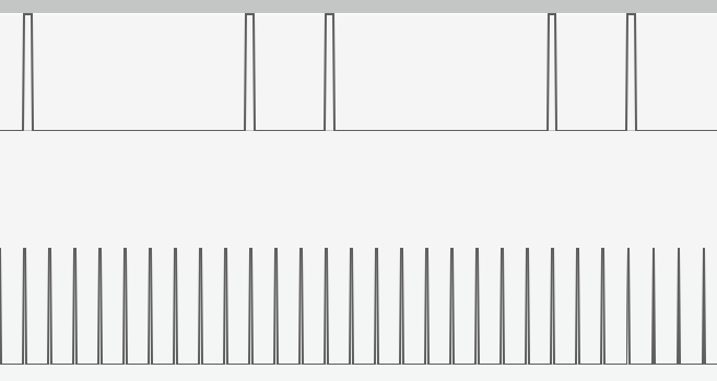

PostPosted: Fri Apr 19, 2019 6:18 am    Post subject: Reply with quote  Mark this post and the followings unread
Hi people!
Long time no see! We are back on track again with the ClkGen model (long time tested) and a whole Logic group completed. Not so much about actually sound design, but anyway one step closer to the final emulation.
Stay tuned! more things to come soon!
And as always - any questions are welcome and any help is appreciated.
Gleb and Eugene
Clock divider in the second mode
 Filesize:  3.27 KB
 Viewed:  20068 Time(s)
Flip Flop trigger
 Filesize:  2.39 KB
 Viewed:  20069 Time(s)
Counter unit time diagram
 Filesize:  7.79 KB
 Viewed:  406 Time(s)
Clock Generator (1/96 pulses and swinging 1/16)
 Filesize:  4.21 KB
 Viewed:  433 Time(s)
