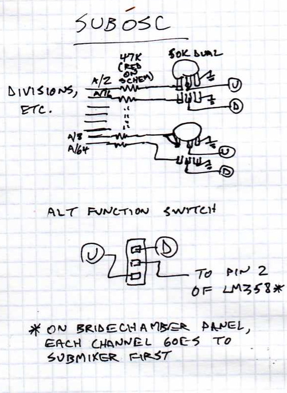

fluxmonkey
Joined: Jun 24, 2005
Posts: 708
Location: cleve
PostPosted: Wed May 21, 2008 7:35 am    Post subject: Reply with quote  Mark this post and the followings unread
bridechamber wrote:
On the one I'm working on now, I use dual-gang pots, with switches for each channel -- A, B and Multiples. I also use Mixer PCBs to separate a mix the channels. That was one thing I wanted on my original -- the ability to separate channels.
The other thing, for audio divisions, was to have a jack for each output. Then, with some EGs or sequencers and VCAs, you could do some really fun mixing of divisions and tones...
i'm not grasping what exactly yr doing w/ the dualgang and switch arrangement... a wiring diagram would really help.
and just to second the emotion re: the fantasticness of some of these modules. i've been tracking with a patch heavily centered on the Gated Comparator for the past week... too much fun.
b
bridechamber
Joined: Oct 06, 2007
Posts: 64
Location: Saint Paul, MN
PostPosted: Fri May 23, 2008 7:32 am    Post subject: Reply with quote  Mark this post and the followings unread
Here's a fancy diagram (sorry, couldn't find my crayons). I hope it makes sense.
Using the 47K resistors in red on Ken's schematic, and then going to the pots, we move the summing node to the switches. We then switch between upper divisions (audio) and lower divisions (control). Each channel does this. On the Bridechamber version, the A and B channels each have their own mixer, for submix and inverted submix outputs. The "Mix" switches then control whether they are included in the final output, or if the final output is just the multiplied signals.
This way you can use the Subosc as intended, but also be using Channel B for something else, or use A and B separately, and then check out what's happening on the Multiply channel, just for fun!
I used the x2 and x2i a lot in my originals, to add harmonics or carve a little bit away. Since everything's in phase, cancellations can be useful!
But it is confusing to wire up at first! When I did my first Subosc it was confusing enough. I don't know why I had to go and make it worse : )
I guess I just _had_ to have those separate channels!
Subosc channel wiring for subchannels and "alt function" switches.
 Filesize:  119.59 KB
 Viewed:  589 Time(s)
ericcoleridge
Joined: Jan 16, 2007
Posts: 889
PostPosted: Thu May 29, 2008 10:29 am    Post subject: Reply with quote  Mark this post and the followings unread
Would you elaborate on this a little? As I'm designing my panel, this is the part that is confusing me. Both divider channels can (optionally) switch between this initial multiplication (x2, x2i). But then only channel B goes to the "prescale" stage (with divisions 2, 3, 5, 7, or bypass). So, would it make sense to have a x2 / x2i switch on both A and B channels, and then a second pre-scale rotary switch for B?
Also, I'm wondering if it's possible or worthwhile to try to bring the pre-scale divisions out to pots or jacks?
I'm planning on using CGS DCMixers to sub-mix A, B, and the Multiplier. I originally wanted individual outs for each separate division, but now I'm thinking I'll compromise with sub-mixes.
bridechamber
Posts: 64
PostPosted: Thu May 29, 2008 11:16 am    Post subject: Reply with quote  Mark this post and the followings unread
The dividers are hardwired to x2. x2i is there because, I think, there was an extra gate and Ken thought it would be fun Smile
Using x2i would just give you inversion on the whole channel, which you can easily get from your final mixers.
x2i is useful to bring out to a pot (and the mix), because you have these huge sounds available, and you can carve out the waveform to something a little less huge but very interesting by using an inversion at a higher frequency to basically add 'dips' at the tops of the waveforms. And it does fun crazy stuff at low frequencies too.
Separate outs can be useful for different applications. For control, you could use each division for different clocking tasks, like any divider. For audio, you could use a separate EG and VCA for different divisions and multiplications for dynamic mixing.
You'll need to buffer each output before each jack.
Have you seen Ken's new Master Divider? You could just build two of those. I used his old version all the time and am planning on doing two of the new ones. Timing modules (and logic modules) are insanely useful for experimental sounds.
