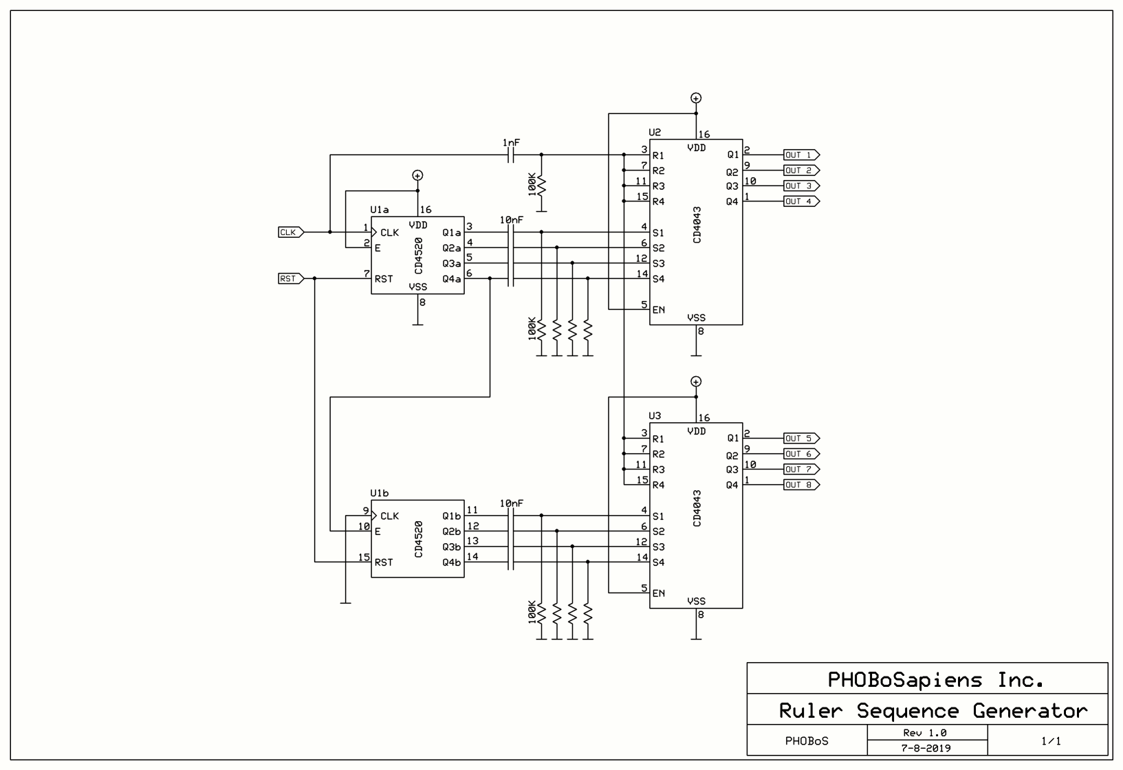

I designed and tested a simple circuit that creates a (0), 1, 2, 1, 3, 1, 2, 1, 4, 1, 2, 1, 3, 1, 2, 1 sequence, and it can easily be extended.
I don't really like the (0) in there but it shouldn't be very hard to change that to another 4 (or whatever the highest number is).

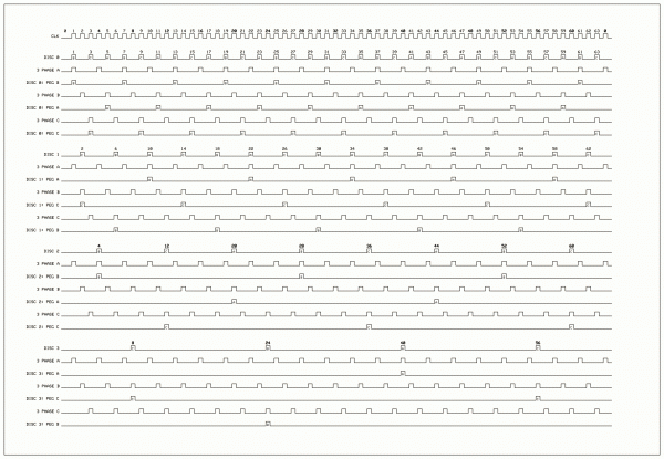

However that is only part of it, there is also the sequence of the pegs/rods which for 4 discs is B, C, C, B, A, B, B, C, C, A, A, C, B, C, C.
I have been staring at it and trying to group things together by looking at the actual movement but haven't been able to find much logic behind it.
ruler sequence generator for 8 'discs'
 Filesize:  57.66 KB
 Viewed:  587 Time(s)
Posts: 5947
PostPosted: Wed Aug 07, 2019 7:46 am    Post subject: Reply with quote  Mark this post and the followings unread
a bit of an explanation for the circuit above which relies on the fact that for the CD4043 (which has 4 flip-flops) SET is dominant.
This means that if both SET and RESET are high at the same time the flip/flop will be SET.
As mentioned before:
To solve it you count in binary and the position of the bit that changes from 0 to 1 is the number of the disc (0 being the smallest) to move.
0001 move disc 0
0010 move disc 1
0011 move disc 0
0100 move disc 2
0101 move disc 0
0110 move disc 1
etc,
And that's what it does. Everytime one of the outputs of the CD4520 changes from 0 to 1 (and that is only ever 1 output at a time)
it sends a pulse to the corresponding flip-flop to SET it. At the same time all the other flip-flops are RESET by the CLK signal.
For reliability I used a smaller capacitor for the RESET inputs although I am not sure if that is even needed.
You could also use the same capacitor values and a smaller pulldown resistor.
Because only one of the outputs is high at a time you could connect them to a priority encoder (CD4532). (useful if you want to control a mux)

ok I see something. although I am not sure if it is going to help me any further.
The whole thing is probably (not surprisingly) recursive.
for 5 discs the sequence is: B C C B A B B C C A A C B C C B A B B A C A B B C C B A B B
or: B C C [B] A B B [C] C A A [C] B C C [B] A B B [A] C A A [B] B C C [B] A B B
or:
B C C [B]
A B B [C]
C A A [C]
B C C [B]
A B B [A]
C A A [B]
B C C [B]
A B B
and the letters between brackets are also in the order:
B C C [B]
A B B

This shows even better how it is a simple repeating (and recursive) pattern, which is the same for all pegs just shifted.
For every extra 'level' (2 discs more) the same pattern repeats but a factor 4 slower.

Yes .. Embarassed .. didnt even think of that .. but a bit shift will do exactly the right thing (for n >= 0).
heh, shoudn't that be (for n>0) ? otherwise it will use out[0] which doesn't have a value assigned yet, unless it's 0 by default.
here's a more complete timing diagram for a game of 6 discs. (I am very tempted to do it in a spreadsheet with some colors colors )

I came up with a different circuit for the ruler sequence. It's not an improvement but I might as well post it anyway.
note: U2a isn't really needed

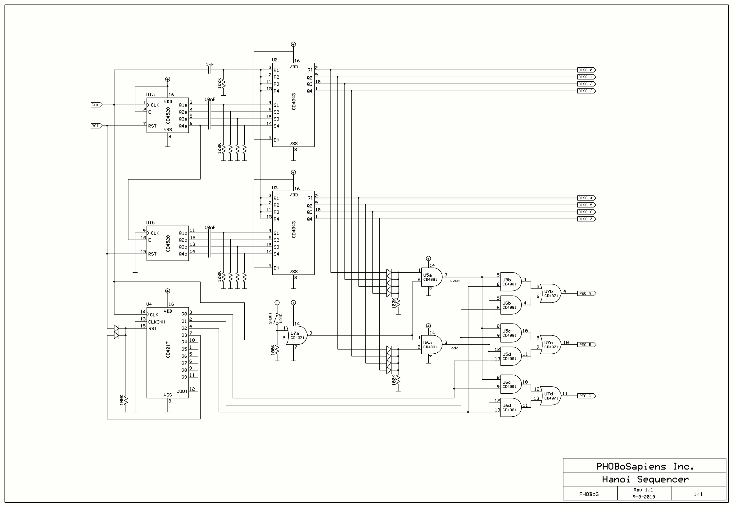

I was happy that it worked but it did look a bit ridiculous with 3 AND gates for each disc, a total of 18 for this circuit (and 24 for the 8 disc version).
I labeled all the AND gates with an A, B or C so I could easily see which peg they were connected to and that's when I noticed something. Each set of
3 AND gates was connected to the corresponding disc output of the RSG but also all the AND gates for the odd discs had their other inputs connected
in the same order to the 3-step counter and the same was true for the even discs. This makes sense of course as all the odd discs move in one direction
and all the even discs in the opposite direction.
Since only 1 Disc output is high at any given time I combined the odd and even ones using 2 (3-input) OR gates which results in two outputs, one for
the odd discs and one for the even discs. I combined each one with the outputs of the 3-step counter using a total of 6 AND gates. This resulted in 6
outputs; odd discs peg A, even discs peg A, odd discs peg B, even discs peg B, odd discs peg C, even discs peg C. So all that was left to do was to combine
the even and odd outputs for each peg using 3 OR gates. Not only does this use less gates it can also be easily extended. For every disc, one of the OR
gates that combine the odd/even discs needs an extra input. Since this can be done with diodes that's just 1 diode extra per disc. Of course the RSG itself
needs some extra chips too for more discs.
And that's how I solved the Tower of Hanoi with the magic of 3's Very Happy
I drew another timing diagram, this time with a 3-step counter (and only 4 discs), which makes it clear why it works.
oh and I had 3 gates left (U5a, U6a, U7a) so I used those to switch the peg outputs between long or short mode. In short mode the outputs have the
same duty-cycle as the clock signal while in long mode they stay on for 1 full clock period. As a result if a peg output is high for 2 or more consecutive
steps it will create seperate short pulses in short mode, and one long pulse in long mode. I was thinking of using the enable inputs of the CD4043's
for this but they have 3-state ouputs so it depends a bit on what you connect it to if that would work. Also I connected the 3-step counter directly
to the clk signal instead of the first division. Works the same except the direction of all the discs get reversed. Hmm, I might aswell add another switch.
I will look into it a bit more to see if I can simplify it even further and have a another look at the other video.
(not tested)
 Filesize:  90.33 KB
 Viewed:  399 Time(s)
