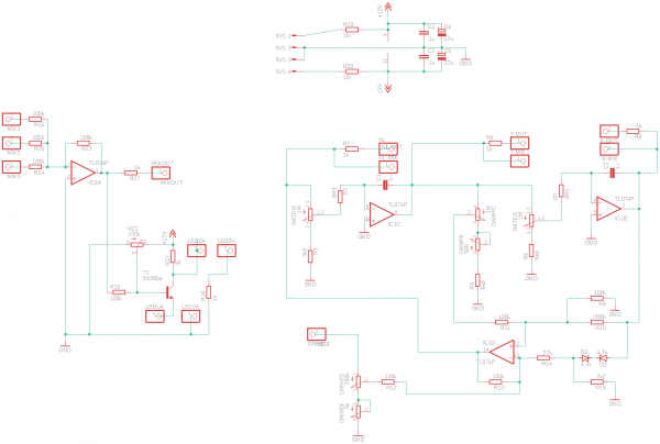

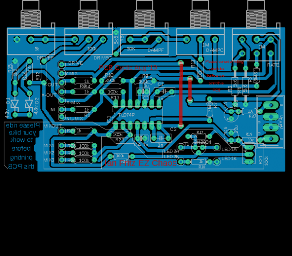

Hey,
Its been a while, but I am back trying my hand at DIY builds again. In an attempt to reacquaint with EAGLE I have laid out Ian Fritz's EZ Chaos aka Double Well Chaos circuit for a single sided home etch PCB.
He has given me permission to share it here.
I HAVE NOT built it yet, and will update when I do, but thought others out there might like to check for schematic errors or pcb errors, as I've grown blind from looking at it for so long...
I have made the layout with on board pots, including the suggested fine tuners for Drive and Damping, so there is a row of 5 16mm pots. It is about 10x5cm in size and I have it down to 2 jumpers.
Since I hate to see an op-amp go idle I put the spare to use as a simple inverting mixer, with the plan that I have panel switches to select any or all of the X/Y/NL outputs to be mixed and inverted as an additional.
I have also included the 'Single Transistor bipolar LED driver.' See commetns below for th link to that thread.
At one point I had some kludge space but I pulled it out for some bike advocacy instead. Lets hope I don't need a kludge!
cheers
screenshot of board. I'll post a etchable file once I remember how to do it!

roglok
Joined: Aug 28, 2010
Posts: 202
Location: uptown
PostPosted: Wed Aug 07, 2019 12:18 am    Post subject: Reply with quote  Mark this post and the followings unread
Especially for home etching you might consider a plane instead of tracks for the 0V. To provide some electrical isolation and to reduce the amount of copper to etch away...

PostPosted: Wed Aug 07, 2019 3:43 am    Post subject: Reply with quote  Mark this post and the followings unread
Yeah thats not a bad plan. Ive also now thought about squeezing in a kludge area too as I have more than once had a little daughter board hanging off the side to drive an LED or buffer input or something. I reckon i could fit in quite a few 1x3 throughholes for that kind of shenanigans. But it does mean i need to reestablish schem to pcb connectivity....
Thanks for the idea.

Hi
Very Happy cheers santa
Your R14 is 27k, Ian's is R17 100K
Apart from that your schematic is identical to his plus your additional mixer which should also be fine. Also the fine tuning pots:
I have not had time to carefully check your circuit for the set up of the fine adjust pots drive and damp (at a glance I noted I should double check the grounding but am not familiar with this pot set up).
Will be excellent to see an EZ Chaos pcb. EZChaos is on my strip board list but I take so long making strip boards badly. Thank you!
(I did also trace comparatively the pcb against ian's schematic and was as above except I got a little confused with your C2 and C4 - will try to have another look).

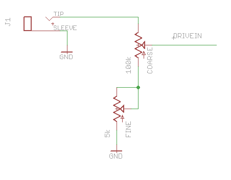

PostPosted: Fri Aug 09, 2019 8:21 am    Post subject:
Subject description: Fine tuning for Drive
Hi cyclic
Here is Ian Fritz's circuit for adding fine tune to drive
Looks like you need to connect the 100k pot "First"
*Edit with reference to gabbagabbi's comment below I was using "schematic-197.png" and "board-189.png", checking against Ian Fritz's original schematic. I didn't open the eagle files.
Can confirm that have now checked pcb and is same as your schematic. Assuming your fine tuning set-up for damping is good.
As I said I will build one to test for you but can't do this at the moment.
Hope that helps and happy to look at an updated version.
Question: were you planning to have nl-mix, x-mix, Y-mix normalled to the mixer inputs?

PostPosted: Sat Aug 10, 2019 9:33 pm    Post subject: Reply with quote  Mark this post and the followings unread
Yes, that is the fine tune i have now.implemented. it made a bit of a rejig so i have redone the board, but not.uploaded yet as.its a bit messy and.I want to tidy it first.
I use bananas so I wont be normalling, but you could. Im going to have manual switches so I can select
I breadboarded the indicator leds circuit last night and its.good.enough but not perfect. If you search for 'A collection of Led drivers' here, it is.the single transistor bipolar driver. Putting it on the board has messed it up a bit so I want to make it neat and tidy before updating. Give me a few daysn i have 3 kids and other hobbies!
It sounds like the current pcb shiuld work fine, but my new one has more features (which are all optional) and i eliminated a jumper too. Yay! So if you can wait, do that...

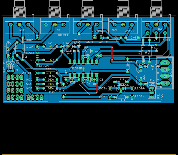

cyclic
Joined: Mar 15, 2015
Posts: 95
Location: hobart
PostPosted: Sun Aug 11, 2019 3:41 am    Post subject: Reply with quote  Mark this post and the followings unread
gabbagabi wrote:
all fine,
Jan (BlueHell) has already given us the answer to the naming-problem
some things:
does the PCB has to be single-sided (for home etching)? or do you plan to send this to a BoardHouse (where it could be double sided)?
the power connector: you using two pins for GND, i guess standard would be 3 PIN for gnd, or maybe better go for the "full" connector 2x7pin as the board is big enough?
Yeah thats a good point about power, but: My entire synth is DIY so ive never worried about conforming to every standard and the eurorack power connectors seem completely overblown to me. Like really, why do i need a 14 pin connector?
I used 3 pins in total (ie 12v, gnd, -12v) at first but then settled on 4 so I can have an analog and digital ground if occassinally needed. I guess i could have put the leds on my DGnd for this, but i dont think its necessary. Why is 3 pins for gnd a standard?
Thats not a hard fix so I can do that. m going to do the ground pour on this i reckon anyway
I have seen a combo eurorack\MOTM power conn, they are on the barton musical instruments pcbs. I have If this was available as an eagle cad file which was easy to install i could do that but its a very low priority for me to create my own.
Ive made it single sided for home etching because thats what I do. I am moving towards making double sided boards and thats why i am making a.silkscreen so I can practice top and bottom alignment. If I get ok at doublesided then I might get something done professionally in future but Im in no rush.

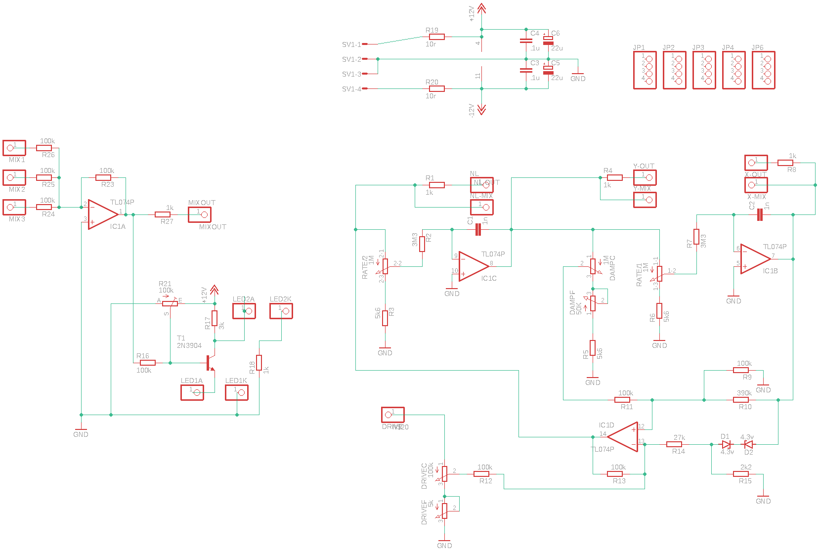

PostPosted: Sun Aug 11, 2019 5:57 am    Post subject: Reply with quote  Mark this post and the followings unread
AAAAAAlllllll Righty then.
Here is a bunch of files which I am considering ready for prototype production.
It is a single sided PCB for home etch.
Main circuit: Ian Fritz's EZ Chaos, AKA Double Well Chaos from the schematic available on synthcube and reproduced here with Ian's permission. I have included the recommended fine tune pots on board, for a linear array of 5 pots to double as PCB mounting. Because I like that.
Sub circuits:
- An inverting mixer for all outputs, to be selected via 3 panel switches so I can choose any combination of outputs, inverted.
- A pair of LEDs for bipolar indication of the *MIXER* outputs, based on the 'Single Transistor Bipolar LED Driver' contained in the "A Collection of LED Drivers' thread here on EM (http://electro-music.com/forum/topic-49449.html)
- A bunch of pads to 1.make use of space and 2.allow for kludge space in case I scrwe anything up...
All these subcircuits are delineated on the silkscreen so you can choose to include them if you want, and its easy to ID where they are. They are entirely optional, but I'd at least put a bridge across the spare op-amp if it is not used as a mixer.
I went with large 4-pin power because that what I wanted.
You can take the files and do whatever you want with them except make money.
the full thing. I went with a ground plane even though I'm not convinced that this really IS a 'ground plane' vs a 'ground pour' in terms of actual electrical effect. But it does mean less copper to etch

OK!
I have finished. I'm not doign any more now.
The finals files - all that should be required - are now in the ORIGINAL POST and are 'version 3'
I left the 'version 2' ones up as well, but I reckon 3 is better (obviously!) but 2 has the kludge space but tiny pads.
I'm not even sure if I will etch V3 myself - I will attempt to use v2 which I have etched but had the tiny pads and will only re-etch if I either fail or its so freaken awesome I need two of them...

So ive built the #2 version above which I etched last week and this is what I have to say so far:
Yep, chaos when you get the right spots. At least I got that far (after eliminatig an invisible solder bridge somewhere and cursing late into the night yesterday)
Um. Er. I drew most of the pots in backwards. Whoops.
I can see that 10turn pots will actually be way better. So I bought 2 of them with the fancy knobs for $10 on ebay. Sure they wont be Bourns but they will better...
The Led is useless. I had problems on the breadboard but just whacked it in there to use some space up. Waste of time as currently drawn.
I have also since realised that the Cha half of the ChaQuo is actually an improved version of the EXChaos which, ahem, uses all 4 opamps. Since the mixer is just there to use an opamp, but the improved version is, well, improved, I may as well just ditch the mixer too and add.the extra gain control to hopefully get slightly better or easier to dial in chaos.
Yay for learning!

So 18/12 later I have another update...
I laid out the Cha of the ChaQuo and used multiturn pots because to be honest, the coarse/fine dual knobbage just isnt anywhere near as good as a multiturn.
I used really shit cheap mutliturns and it turns out (bwahahahah!) that one of them was dodgy and I didnt realise that until, ahem, yesterday.
I had thought for the last 12/12 that my layout was bad and htats why all I ever got was a few options of weird LFO.
Now that I have fixed my crap pot by hot gluing it all back together it seems to be working properly, so it seems that after all it might be worth while posting it here.
So I'll post the schem and board files again in the next few days once I get around to it and check that the ones I have on file are the one I etched.
Once again, I put the on board pots in backwards. Sorry I cant be arsed fixing it now, I just live with the fact that my chaos is also backwards.
Ayab
Joined: Oct 27, 2015
Posts: 186
PostPosted: Wed Feb 17, 2021 12:20 am    Post subject: Reply with quote  Mark this post and the followings unread
Hi Cyclic
Great that it is all tested and working. You are the man Razz
Good work. Thank you. I will get etching as soon as I have a diy space again - (should not be be too long before I sort out that type of chaos).
Couple of queries:
- Can I just solder the pots to the other side of the board (as long as there is plenty of solder should be ok, no?) to reverse them?
- The .brd eagle file seems to be in text format am not sure how to download it (probably use the other version anyway.
