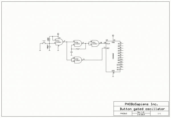

Posts: 5971
PostPosted: Sat Aug 03, 2019 1:07 pm    Post subject: Reply with quote  Mark this post and the followings unread
I think this should work:
 Filesize:  35.54 KB
 Viewed:  565 Time(s)

You got damn genius. It finally works the way I wanted to work for the longest time. Now I can add the rest of the circuit. And I'll post the completed circuit once I'm finished with it.
Posts: 5971
PostPosted: Tue Aug 06, 2019 4:11 pm    Post subject: Reply with quote  Mark this post and the followings unread
great to hear that works Very Happy
btw you can probably leave out U1c. I forgot that the 4040 counts on a high to low clock transition and I added U1c
so that when you push the button you immediately get a low to high transition. If it's for high frequencies
it doesn't make much of a difference though.

Yes you were close I was actually surprised you didn't have the NAND for the reset connected to the button but instead to the oscillator.
I have no idea what you were trying to achieve with the capacitor connected to the first NAND gate though.
Posts: 5971
PostPosted: Wed Aug 07, 2019 5:54 pm    Post subject: Reply with quote  Mark this post and the followings unread
let my dissect the circuit a bit so you know exactly why it works although you will probably already understand it.
When the button isn't pressed the capacitor is charged through the resistor so both inputs of U1a are high and as a result the ouput is low.
When you press the button one input immediately goes low which results in the output going high. Because of the capacitor (which is now discharged)
and the resistor the pin can't go immediately high if there would be any switch bounce. This gets even improved because of the schmitt trigger
inputs of the NAND gate. (If you would add a much larger capacitor the ouput will stay high for a while after you release the button, which can be useful.
You can also replace the resistor with a potentiometer to make the time adjustable, but you do need to add a resistor in series with the pot)
When the gate input of the oscillator (U1b) is low (button not pressed) the output will be high and thus the capacitor is charged. When the gate input
goes high the output immediately goes low and then (after a short delay) it starts oscillating. When the button is released the output will return back
to a high state. With U1c it's the otherway around so it is in a low state when not oscillating.
U1d inverts the output of U1a so that the 4040 is reset when the button isn't pressed. Because there are actually 2 inverters in series (U1a & U1d)
you could also connect the reset input of the 4040 directly to the button (before U1a). But U1a helps with debouncing and if you're not using the
spare NAND gates for anything else you might aswell add it. There is also a small chance the 4040 would react a bit weird because the reset input
doesn't go high immediately as a result of the resistor and capacitor.
