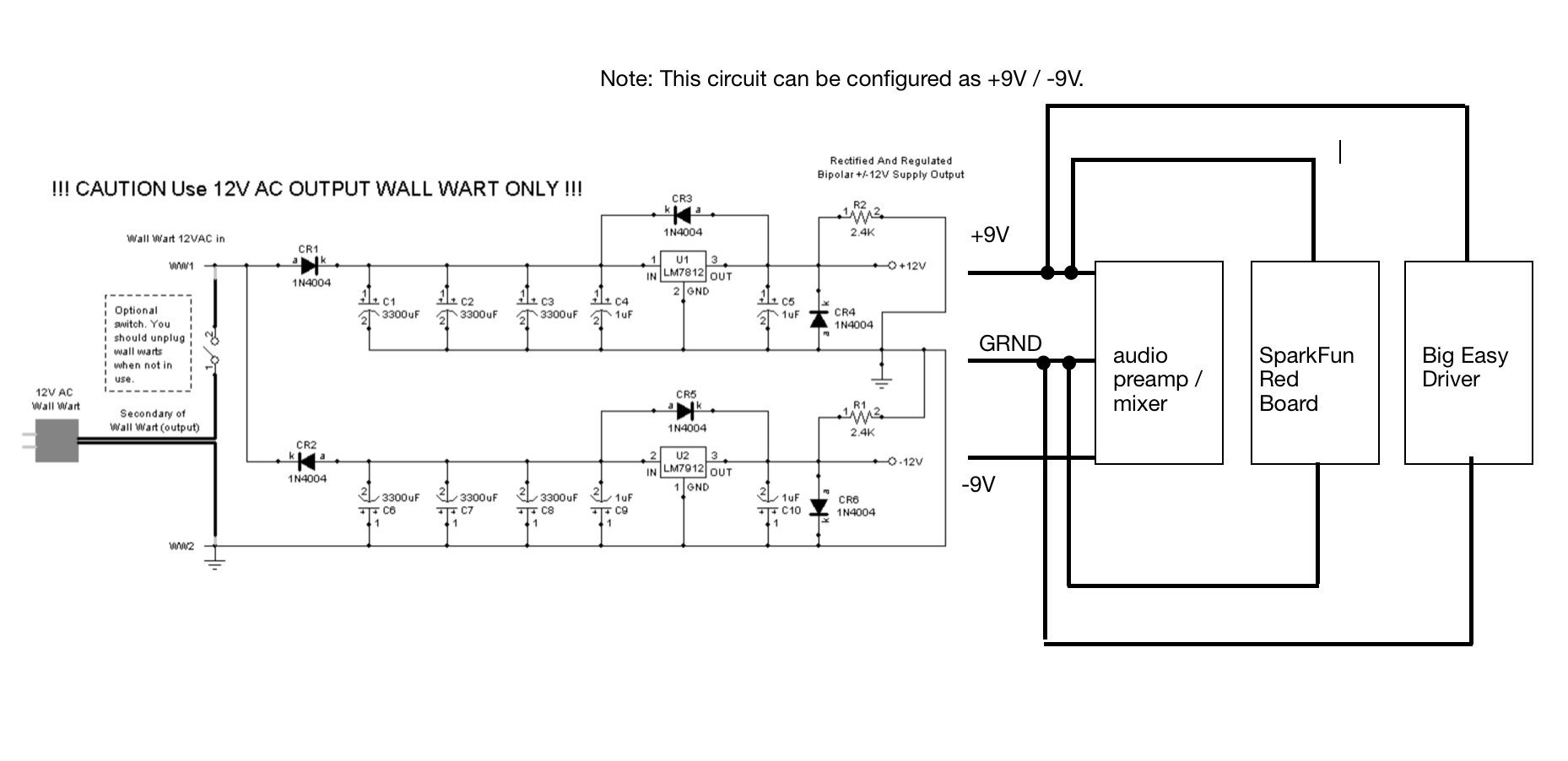

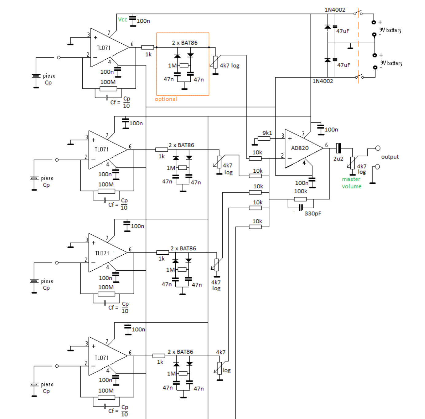

PostPosted: Sun Jul 21, 2019 10:13 am    Post subject: Re: Power supply with more current?
Subject description: 3 or 4 amps
Thank you for the welcome and the reply, PHOBoS!
The project is combination of several circuis:
1. a piezo mixer / preamp requiring a bipolar +9 / -9V supply (schematic attached - note the original schematic had 5 channels, but I only need 4)
2. a SparkFun Red Board https://www.sparkfun.com/products/13975 requiring 7-15V;
3. a Big Easy Driver https://www.sparkfun.com/products/12859 requiring 8-35V driving this stepper motor https://www.sparkfun.com/products/13656
The Big Easy Driver documentation states the power supply "...should be a 6V to 30V, 3A (or more) power supply that is clean (low ripple)." http://www.schmalzhaus.com/BigEasyDriver/
Note SparkFun offers different requirements: "You can use any kind of power supply (desktop, wall adapter, battery power, etc.), but verify that whatever choice you go with is capable of providing up to 2A and falls in the range of 8V to 35V." https://learn.sparkfun.com/tutorials/big-easy-driver-hookup-guide
I was hoping to connect everything in parallel to one supply as in the attached block diagram (using the positive and ground of the biploar supply to power the Red Board and Big Easy Driver).
I have everything built and working; I am currently powering the Big Easy Driver with this supply https://www.amazon.com/gp/product/B073QTNF9F/ref=ppx_yo_dt_b_search_asin_title?ie=UTF8&psc=1 the RedBoard is powered via the USB of my laptop, and the mixer is powered by my bench power supply. I now want to mount everything permanently in my project box so that I have a single cord and on/off switch.
Not to complicate things, but the mixer schematic calls for +/-9V, whereas I was considering using +/-12V. The AD820 can handle up to +/-15V, so I think that is OK? If not, the MFOS power supply could be configured as +/-9V supply.... I just didn't want to be at the bottom of the voltage requirements, particularly for the Big Easy Driver.
Is there any chance the Wall Wart Power supply or something similar could work? It sounds like I may be able to get away with 2 amps if I go with SparkFun's requirements. Does that simply things? Do you think a linear supply is still plausible? I haven't yet found a good resource that introduces slightly more complicated power supply management, so any guidance would be much appreciated.
Thank you for your help!

JovianPyx
Joined: Nov 20, 2007
Posts: 1988
Audio files: 224
PostPosted: Sun Jul 21, 2019 10:31 am    Post subject: Reply with quote  Mark this post and the followings unread
It looks like the current hog is the Big Easy Driver which wants 3 amperes.
In my opinion, the Big Easy Driver needs it's own PSU. It would be unwise to drive all three circuits from one supply. I would create a 3 ampere supply for the Big Easy Driver and use a separate supply for the other two. The mixer should need very little current. The Red Board also, I'd predict fairly low current. LM350T is a 3 ampere regulator which could be used for the Big Easy Driver. Note that your transformer for this needs to supply at least 3000 mA. You might not be able to find a wall-wart transformer that provides that much current. It's voltage should be about 12 volts AC for a 9 volt regulator. If the input DC voltage is more than 12, you will experience more heat coming from the regulator. I would also plan on a substantially sized heat sink for it.
The Big Easy Driver needs to dump large currents into the stepper motor coils and could push noise back into it's supply. Using a separate power supply for it will help quash noise that could easily come from it.

Posts: 5883
PostPosted: Sun Jul 21, 2019 11:23 am    Post subject: Reply with quote  Mark this post and the followings unread
Yep, I agree.
Keep the power for those steppers as far away from any audio circuits. On the plus side that part only needs a positive supply
and you could get regulators for that if needed (like the LM350T JovianPyx mentioned).
I also think the wall wart supply might not be ideal with such uneven loads on positive and negative rails. It would probably be better
to use 2 seperate transformers. So either way you'd need more that one supply.

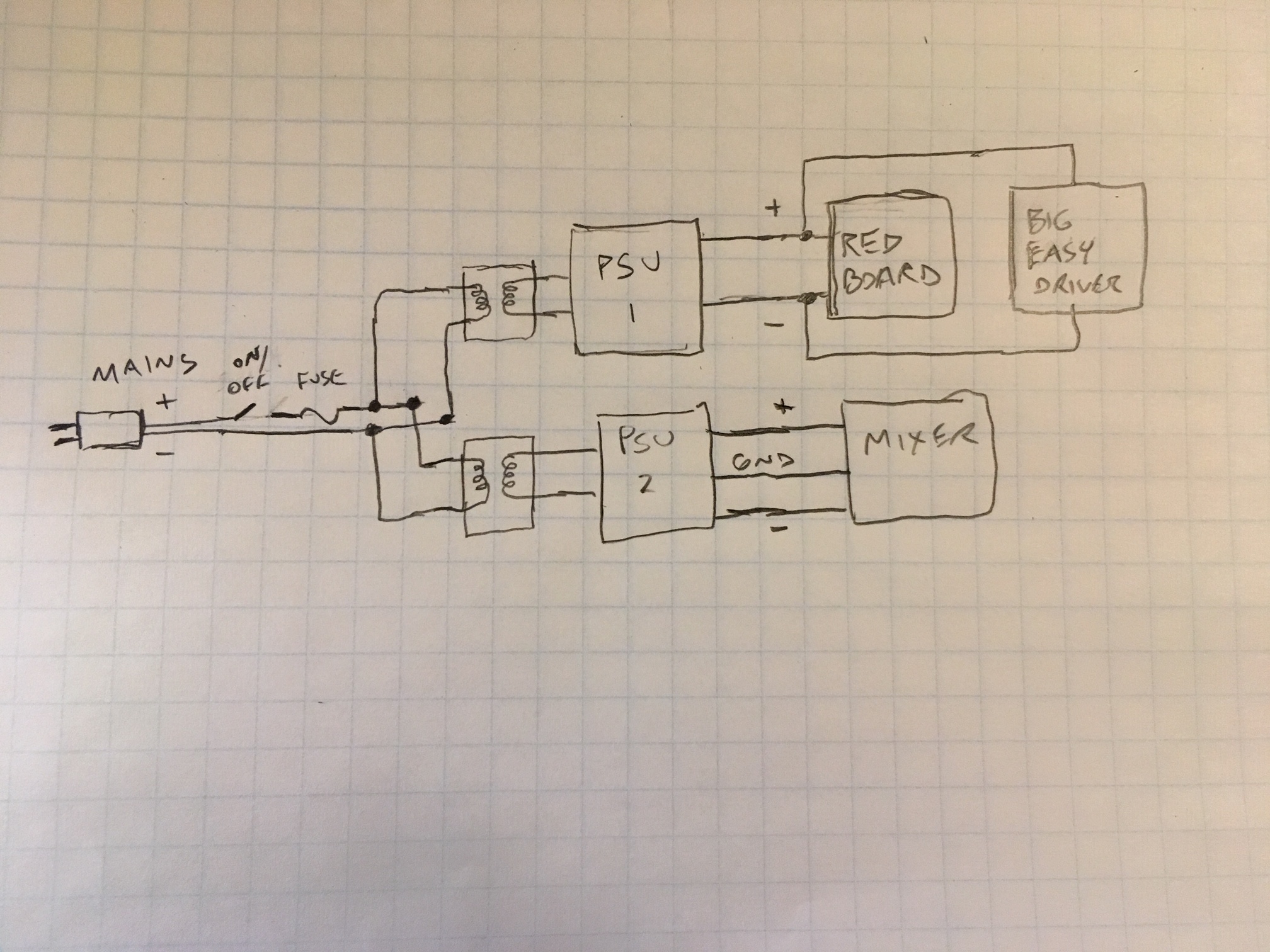

xGx
Joined: Feb 11, 2019
Posts: 10
Location: USA
PostPosted: Sun Jul 21, 2019 4:33 pm    Post subject: Reply with quote  Mark this post and the followings unread
Thank you JovianPyx and PHOBoS! Would it make sense to have the LM350T PSU power both the RedBoard and the Big Easy Driver since they need to be connected (Arduino code on the RedBoard controls the Big Easy Driver) and both only need a unipolar supply? And then a separate bipolar supply for the mixer? That would totally isolate the audio circuit from the rest.
I will research possible circuits using the LM350T, but what I'm not quite sure of is how to implement two power supplies but still have a single cord and on / off switch for everything.
Is the attached sketch at all close? Mains power feeding two transformers in parallel.... one for a unipolar PSU and one for a bipolar PSU? The unipolar would maybe use the LM350T, and the bipolar perhaps the LM317 and LM337?
 Filesize:  772.11 KB
 Viewed:  414 Time(s)
JovianPyx
Posts: 1988
Audio files: 224
PostPosted: Sun Jul 21, 2019 5:25 pm    Post subject: Reply with quote  Mark this post and the followings unread
That depends on how close to the 3 amperes the Big Easy Driver goes. If there is enough current headroom, the Red Board could work. If not, it could operate erratically.
I don't know how much current the Red Board needs and I don't know how much headroom the Big Easy Driver allows with a 3 amp supply.
Time flies like a banana.
corruptio optimi pessima
Posts: 5883
PostPosted: Mon Jul 22, 2019 7:22 am    Post subject: Reply with quote  Mark this post and the followings unread
Looks good to me but I would add a seperate fuse for each PSU, reason being that the fuse needs to be rated high enough to protect PSU1
which won't offer a lot of protection for PSU2. I'd also use an extra fuse for the Big Easy driver as an extra protection. Also you might want
to use a double pole switch for the mains power just for extra safety.
btw I think that for PSU1 a switched supply would work great, it's probably cheaper, smaller and weighs less, while being also more efficient
so it produces less heat. Actually that's what you have been using so far Wink

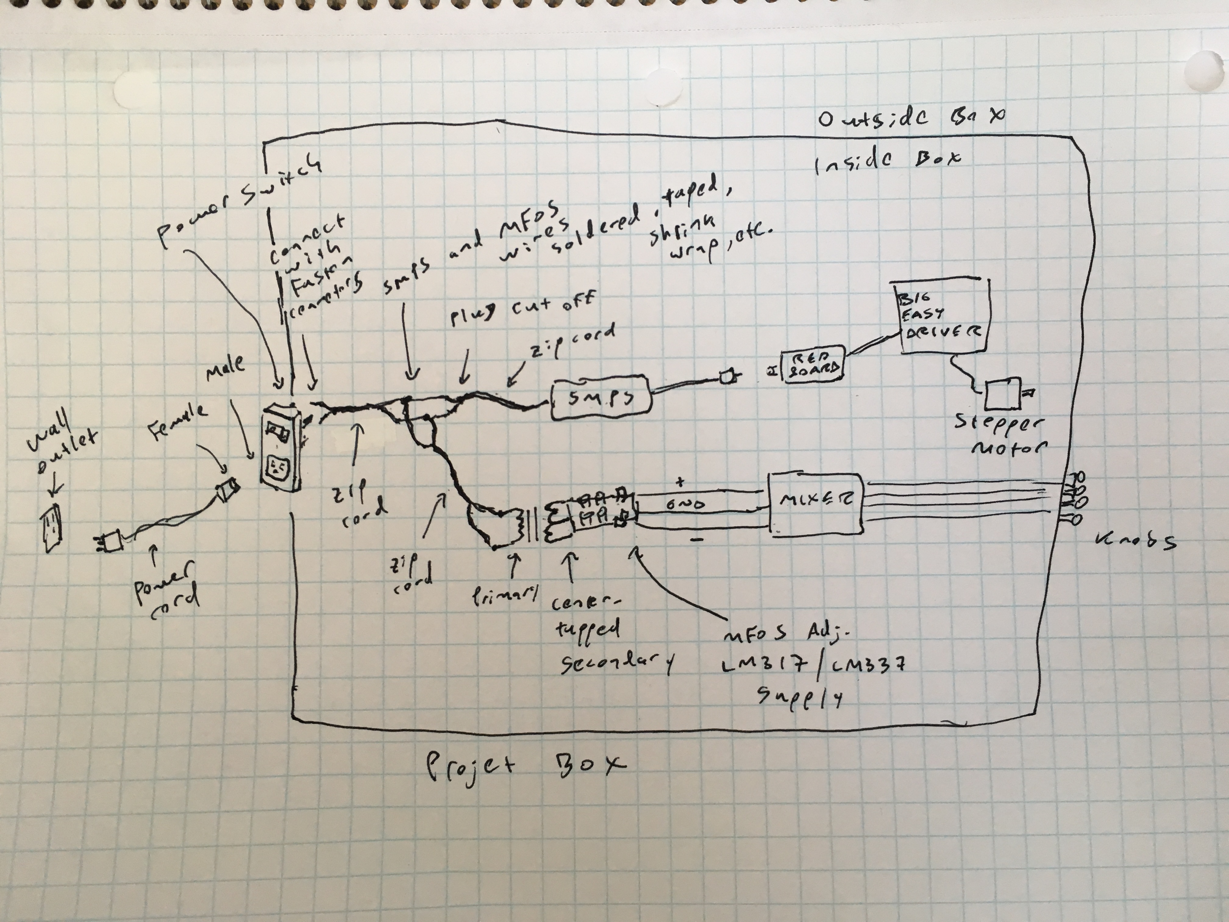

xGx
Posts: 10
Location: USA
PostPosted: Sun Aug 18, 2019 8:04 am    Post subject: Reply with quote  Mark this post and the followings unread
Thank you both again! I agree that building a SMPS is not a good idea. But I think a see a Plan taking shape, based on your advice. It involves using the SMPS I am currently using.
1. Build the MFOS Wall Wart Power Supply
2. Buy one of these or similar: https://www.amazon.com/dp/B01C7OE868/?coliid=I195ASGHQ2L9FM&colid=1F32SLWJVP2SL&psc=1&ref_=lv_ov_lig_dp_it
3. Buy one of these or similar: https://www.amazon.com/dp/B078N95379/?coliid=I17W0LLVXHB1YE&colid=1F32SLWJVP2SL&psc=1&ref_=lv_ov_lig_dp_it
4. Cut the single "prong head" off the "cable leader" in step 2. Separate the wires.
5. Mount the switch from step 3 to my project case.
6. Solder the exposed wires from where the prong head was to the switch, so the two sockets are inside my case.
7. Mount the MFOS WWPS and the store-bought SMPS that I am currently using into my project case, ensuring adequate ventilation.
8. Plug the MFOS WWPS and the SMPS into the "cable leader" receptacles.
9. Use one of these to connect between the switch socket and the wall: https://www.amazon.com/dp/B00FBA1UHG/?coliid=I32UQ4G42YP3S1&colid=1F32SLWJVP2SL&psc=1&ref_=lv_ov_lig_dp_it
I am a bit nervous about steps 4 and 6, but is this the general idea?
Posts: 24525
Audio files: 299
PostPosted: Sun Aug 18, 2019 8:31 am    Post subject: Reply with quote  Mark this post and the followings unread
Genral idea will work.
add step 10 (or a little earlier better :-) ):
re 4. and 6. and so, use shrink wrap tubing over the solder connections of the mains wires, and make it so that the mains wires can't move anywhere even when a single failure occurs (like a not-so-good solder connection comming loose, or the device falling down from some height, stuff like that) - tie wraps may work well for that.
add step 11:
In the hand drawn schematic above, on the secondary sides of the supplies: connect '-' of PSU1 to 'GND' of PSU2 close to the PSU's (or otherwise they'll either float with regard to each other or there will be a ground connection anyway trough other connection not drawn but in a less defined way).
Posts: 5883
PostPosted: Sun Aug 18, 2019 10:49 am    Post subject: Reply with quote  Mark this post and the followings unread
step 6: I'd use (insulated) faston/crimp connectors instead of soldering which is what those switches are designed for. Soldering directly to the
switch requires quite a bit of heat which could potentially damage it (depends a bit on the quality). You could also solder to those connectors
instead of crimping on the wires, but it can be a bit tricky.
step 8: not exactly sure how you are planning to do that. Those aren't mains sockets. I mean voltage wise yes but you can't plug something
like a wallwart in them. There might be cables for that purpose available though.
and yes, make sure everything is properly secured.

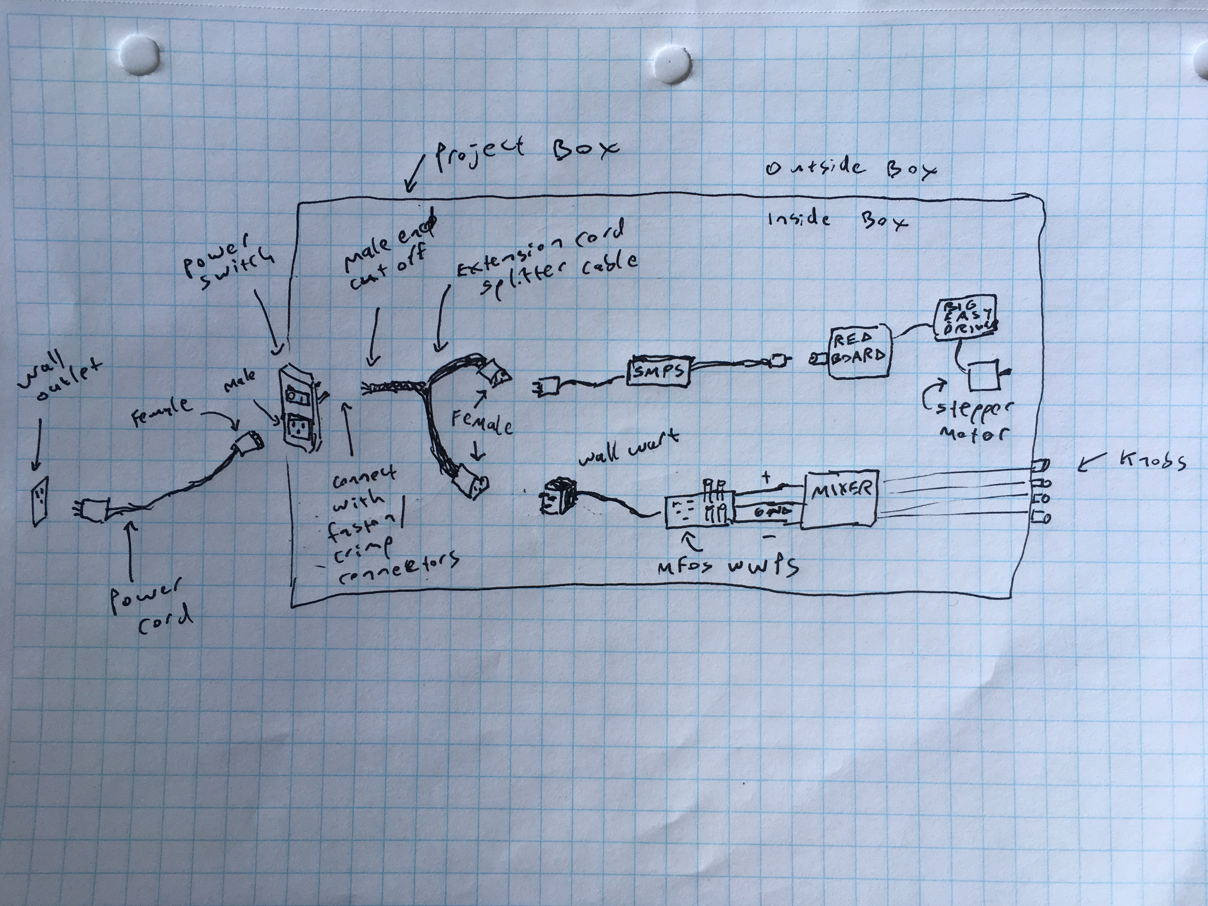

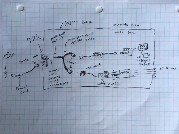

xGx
Posts: 10
Location: USA
PostPosted: Mon Aug 19, 2019 11:10 am    Post subject: Reply with quote  Mark this post and the followings unread
Hey PHOBoS,
Maybe I misunderstood... I thought step 8 was essentially the crux of your suggestion.
Rather than have two power cords dangling off the back of my project, mount a mini split extension cord inside the project box. Wire one end to a switch, and plug both the MFOS wall wart bipolar power supply and the store-bought SMPS in to the female ends of the split extension cord (inside the box).
I have attached a drawing, which I hope makes sense.
If this isn't what you meant please let me know. If it is, then I have an additional idea I'll run by you.
 Filesize:  2.38 MB
 Viewed:  417 Time(s)
Posts: 5883
PostPosted: Tue Aug 20, 2019 5:07 am    Post subject: Reply with quote  Mark this post and the followings unread
It's not that the idea is bad but I highly doubt you will be able to find a wallwart with a 'IEC-320' connector.
I think what you'd need is a 'nema 5-15' connector which looks a bit similar but is something else.
There are probably splitter cables for those, let's see,..
this should work https://www.amazon.com/Pro-Techgroup-Premium-14AWG-Outlet-Splitter/dp/B002MGT72C
at least if that is indeed the type of mains connector you use.
nice drawing btw Very Happy

However.... I did want to see if this simplification would work. I have attached another drawing.
This plan would use the MFOS Adj. LM317/LM337 power supply: http://musicfromouterspace.com/forums.html?MAINTAB=SYNTHDIY&PROJARG=POWERSUPPLY2009/POWERSUPPLY2009.php&VPW=2358&VPH=1053
Here are the steps:
1. Build the MFOS Adj. LM317/LM337 power supply.
2. Cut the plug off the store-bought SMPS.
3. Solder zip cord to the primary of the MFOS supply.
4. Solder the positive and ground of the SMPS supply and the MFOS supply together.
5. Connect the junctions of the MFOS and SMPS to zip cord. Tape and shrink tube everything.
6. Connect the zip cord to switch using faston / crimp connectors. Tape and shrink tube.
This is a bit more challenging, but it is essentially the same as the previous plan but with fewer parts, correct? Is this closer to how things are usually done when one project has multiple power requirements?
Thanks for your help!

Posts: 5883
PostPosted: Wed Aug 21, 2019 7:07 pm    Post subject: Reply with quote  Mark this post and the followings unread
LM317/LM337 supply with an actual center-tapped transformer is an improvement over the standard wallwart supply
but does require you to wire up a transformer. A toroidal type might be the safest to use and easy to mount with the
correct hardware.
Only connect the GND together, at least if you want the mixer to be connected in some way to the stepper circuit otherwise
you don't need to connect anything together.
For the rest that should all work.
I am curious what you are working on.
mph

xGx
Posts: 10
Location: USA
PostPosted: Tue Aug 27, 2019 8:43 am    Post subject: Reply with quote  Mark this post and the followings unread
Thanks PHOBoS.... the stepper and the mixer do not need to interact. I just want them to turn on together. Don't both grounds and both hot wires need to connect at the back of the switch? I was thinking I would solder the grounds together and put a faston crimp on the resulting joined wires to connect to the switch. Then do the same for the hot wires. Maybe you are saying I can just put the two ground wires in one faston connector and the two hot wires in another faston connector, and not solder them at all? Just attach the two faston crimps to the switch?
Speaking of the switch, many of these inlet modules come with a 5A fuse. Will that be enough headroom considering the stepper wants 3 or 4 amps, and my SMPS is 12V, 5A? https://www.amazon.com/gp/product/B073QTNF9F/ref=ppx_yo_dt_b_search_asin_title?ie=UTF8&psc=1
Could I swap out the fuse in the switch for maybe a 6A or 8A? https://www.amazon.com/Ginsco-110pcs-5x20mm-Quick-Assorted/dp/B01CEB6B1Y/ref=sr_1_27?keywords=10A+fuse+20+x+5&qid=1566914219&s=gateway&sr=8-27
Or find a switch with a 10A fuse?
I am moving ahead with the simpler / safer method of the splitter cable and wall wart power supply, but I'd like to understand the points above for the next iteration. Thank you!
Posts: 5883
PostPosted: Tue Aug 27, 2019 1:50 pm    Post subject: Reply with quote  Mark this post and the followings unread
ah I think it's just a confusion because of terminology. Seems like you are talking about the mains side in which case you have a live and a neutral
connection. And an earth but you only need to connect that to any metal parts that could be touched (if there are any). At least your SMPS doesn't
appear to have a connection for earth. So yes, the neutral wires are connected together and to the mains input connector, and the live wires are
connected together and to the switch. Unless it is a double pole switch, which I doubt, then you can switch both live and neutral.
The fuse is probably even too large. The current you are talking about is on the secondary side, the current on the primary side will be much lower.
What stays the same is the power (Watts) although it's of course not 100% efficient so it will need more power than it puts out (in electricity).
If the SMPS is rated for 5A that's a total power of 5A x 12V = 60Watts. Since you seem to be in the US I assume the mains voltage is 120V so
60Watts / 120V = 0.5A. Of course 12V happens to be 1/10th of 120V so the current is also 1/10th. It's not completely accurate as you are not
dealing with a purely resistive load but it gives you an estimate. A 630mA fuse might just do it, you are not using it for its full 5A anyway. There could
be an inrush current that is too high for it so I would at least use a slow blow type fuse.
