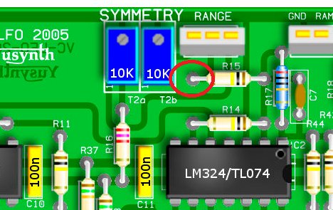

i checked the soundtronics-site,
the pcb are looking the same like yves, they even use the original documentation
so can we assume that we can use tis as orientation?
where did u placed the probe for the scope, when it was on DC?

Pin14 of ic 2

there u should measure a signal that is going from -3,5V to 3,5V
the scope schoots saying that the signal is going from 0V to 7V
that means ether u did not used the ofset trimmers, or they dont work
connect the scope again on pin 14 and try to play around with (both) offsettrimmers to test it
you also could try to measure on the middle pins of the trimmers, when you turn the trimmers u should be able to measure a voltage that goes from 0V to ~10V, on BOTH

So I’m getting 7.6volts from both trimmers

Measuring the power directly as it comes in pre 10ohm resistors is 12v, directly after the resistors I’m reading 11.83v. Please excuse my naivety but would this be normal?

12 - 11.83 = 0.17 or 170 mV.. over 10 Ohms and that would mean 17 mA of power consumption .. nothing unusual I think?

so u have measured 7,6V on both middle pins on the symetry trimmers?
then have turned the trimmers up and down and nothing changed?
u also measured at pin14, turned the trimmers up and down, and the SAW-Wave did not changed position in relation to the 0V Line on your scope?
what do u measure on the other (outer) pins?

They both measure from 0 - 7.6 when turned.
But neither affect the rising ramp from pin 14

can u measure if this variable voltage is comming tru to R15? u have to use the end which is not connectet to pin2/ic2
try both trimmers and since there is the range switch inbetween, use both switch positions
