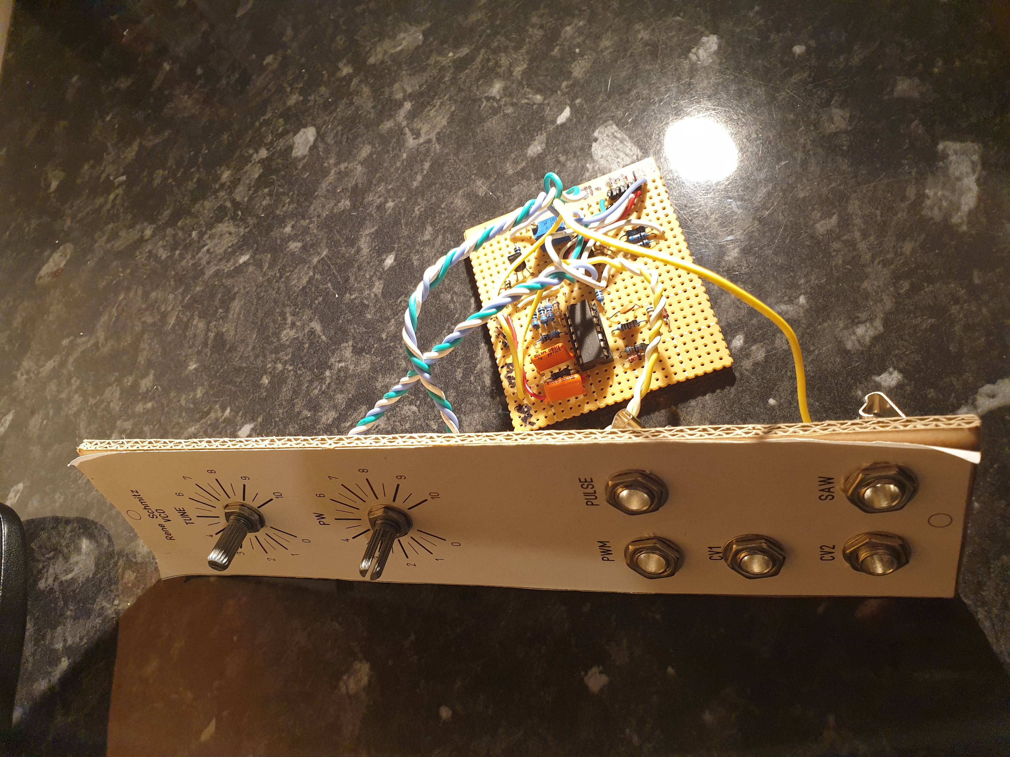

I've just finished building Rene Schmitz 4069 VCO https://www.schmitzbits.de/vco4069.html
and not sure if it works properly, so wanted to check with you guys..
Sawtooth
When the tune (frequency) knob is fully down you can hardly hear anything just very very low frequency (like an LFO - click click etc), which I guess is fine, but then turn it the other way and it doesn't seem to go very high.. It's probably fine, I mean it's high enough, I wasn't expecting to be sending all the local bats crazy or anything just though it might go a bit higher ??
Pulse
Frequency wise pretty much same story as Saw, but then you start to turn up the PW Knob and first 1 or 2 notches it sounds great kinda droney and phazey (nice).. but any further up it just fades out the sound altogether .. does that seem right.?? is it because I'm not actually connecting anything to PWM??
Sorry feel like a total noob as I've been away from this for ages, I can't even remember how it all works Very Happy

Hi Daz,
First check your PSU rails. Then the place to start looking is the CV amplifier and expo converter. Check the component values there, perhaps an R with the wrong value was installed.

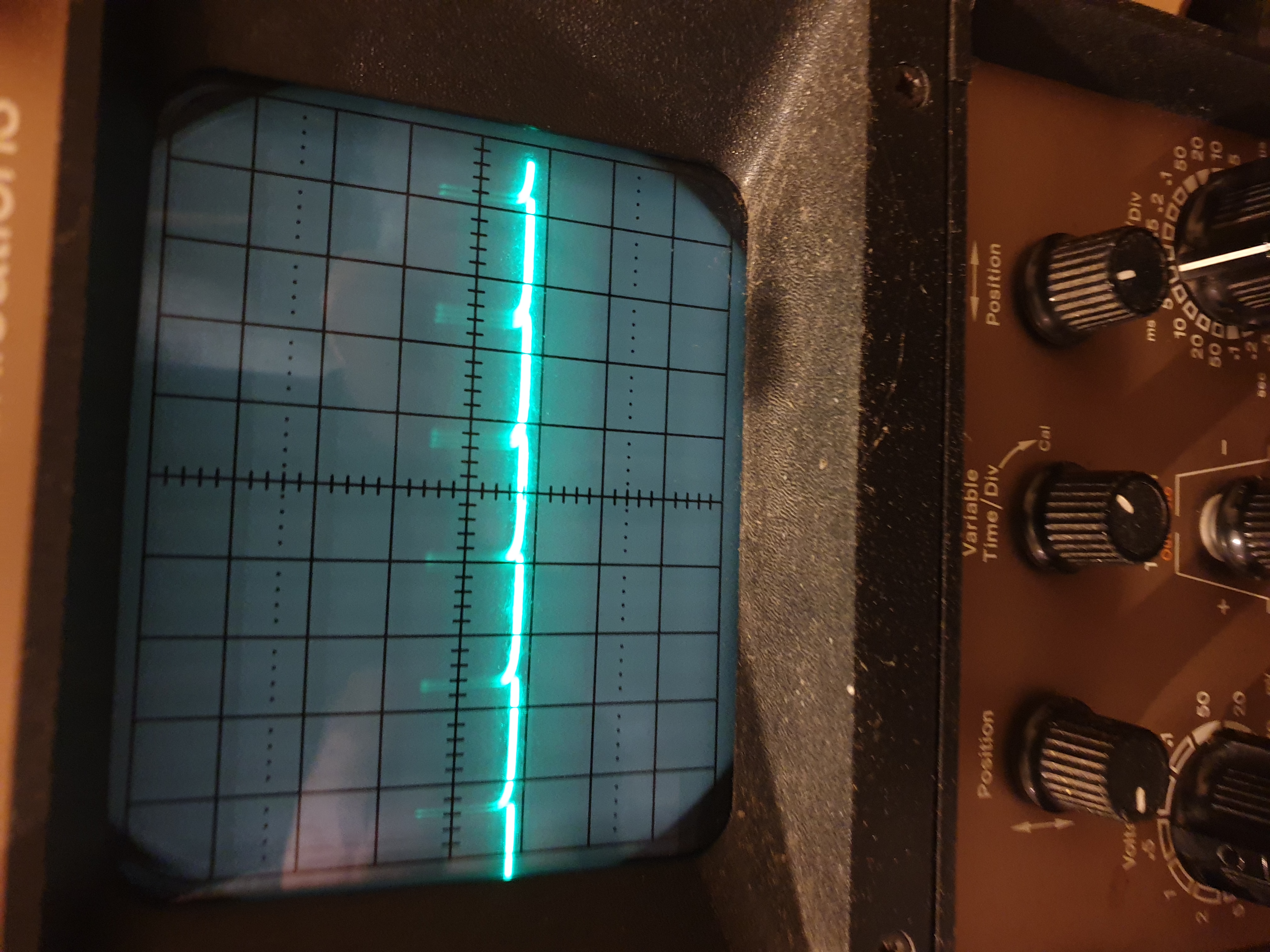

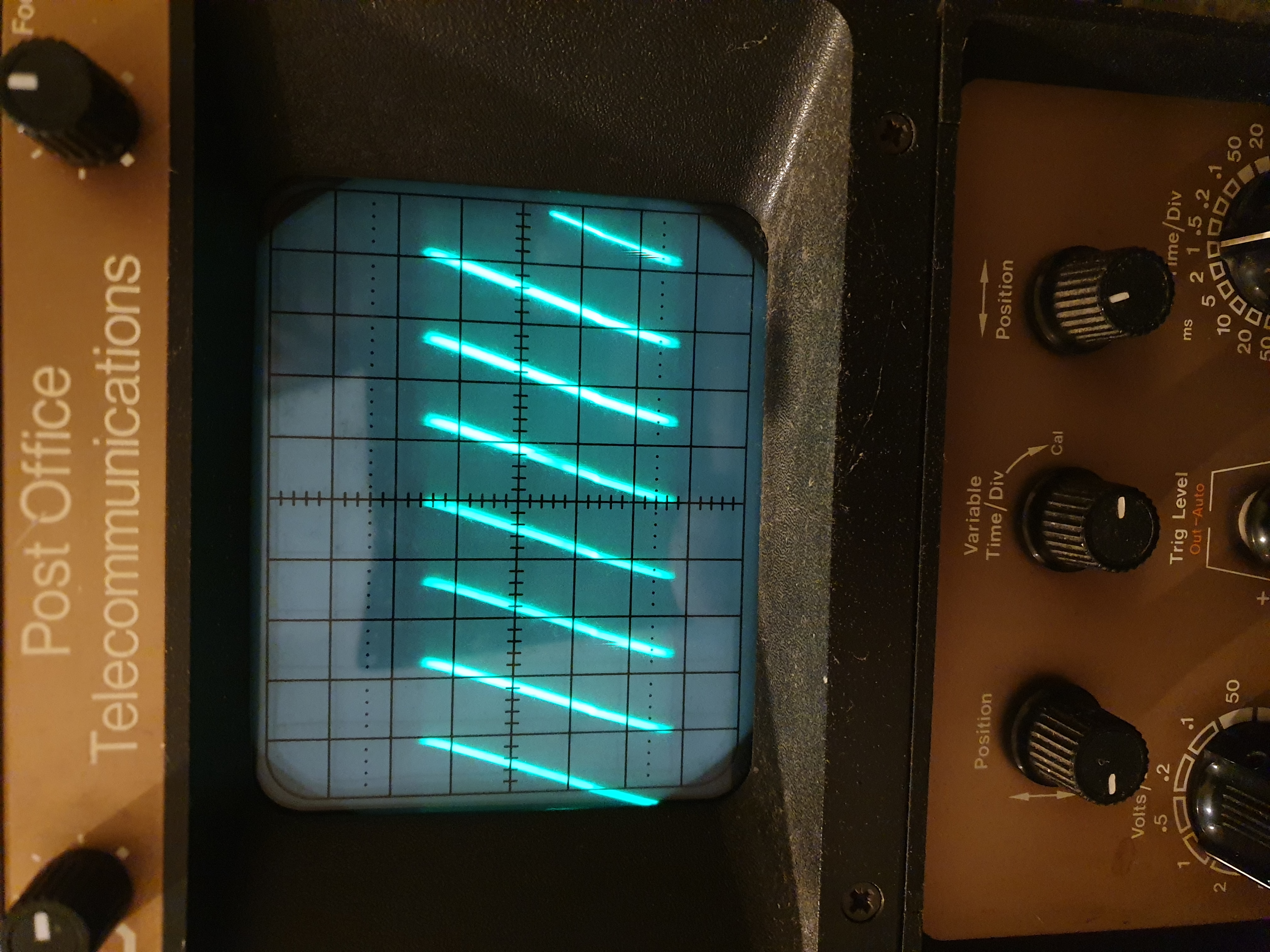

Also got my scope out and took some photos..
Saw looks like a saw to me Very Happy and pulse I think looks alright until you turn PW then it just turns into a straight line..

The top image is definitely the saw. Looks nice.
The next one down looks like sort of pulse, not sure why the one edge is curved. Ideally, it should be a rectangular shape. Probably the effect of a capacitor.
With a wet finger in the wind, I keep looking at the 47K resistor that couples the integrator's ramp output to the PW generator. I would replace that with 100K and see what happens. If it extends the range of the PW pot then it helped and maybe could go bigger. If it makes it worse, then maybe something lower than 47K.
Alternatively, the resistor feeding the summing node from the PW pot might need changing. Making the 47K bigger isn't a problem, but smaller would present a lower impedance to the integrator. That's when I'd want to change the 100K coming from the PW pot.
The pulse output looks funny, curious what's going on there.

Yeah totally agree the pulse looks weird, I was expecting the pulses to be wider and get thinner when I turned the PW clockwise, but they start thin then the pulse is virtually none existent which is why it goes quiet.
I did also wonder about the curve but not for long, my ears aren't good enough to hear it so I could live with that.. Very Happy
I think if I can make it wider initially and then the PW range should get wider I am one happy man Very Happy

The not-so-square waveform is most likely caused by the DC blocking capacitor on the output.
i did change the 47K to 22K which made it better, I guess reading your comment I need to change another one too ?? which one and what to?? sorry for all the questions.. as I say I'm just learning.
You could place a resistor in series with the pot on the side where it connects to +Ub, basically limiting it.
It does seem strange that it cuts out so quick though, but since I haven't build this desing I have no idea if it is supposed to that.
However, going by the schematic it looks like adding a positive CV to control the pulsewidth would make it even worse.
