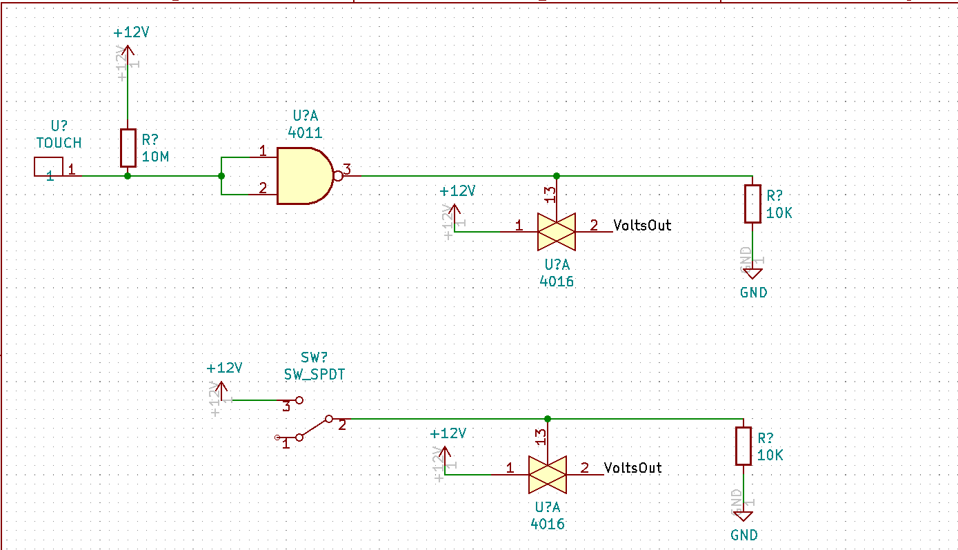

Hi all,
a few questions about cmos switches-
I have a 4016 that I'd like to use to gate 12v through to multiple pots.
First off- When control is tied to ground it seems to still be leaking sometimes even more than an entire volt through. If I'm reading the datasheet correctly, off state leakage should be extremely low, no? Am I doing something wrong here?
And secondly- I'd like to be able to control the gate with the output of something like the attached drawing. However, when I control it with said circuit it only passes something like 7.6v out of the total 12v. Is this odd? I thought the gate is either on or off?
To be sure, if I control it with a mechanical switch that ties control to +v as in the second part of the drawing, it passes 12v through, but still has the problem of off state leakage.
Thank you kindly

You may want to rectify and filter your touch point. On toching you probably will introduce mains hum causing the switch to go on/off at the mains rate - which would then be displayed as an average value by a voltmeter set to DC.
Edit: this can be done after the buffering port. But what you should also do is add some protection diodes and a resistor on that port's input - as is you may blow the port when charged up to sparky level after walking on a dry carpet or something (see 2nd post in this thread for an example: http://electro-music.com/forum/topic-14912.html - the resistor could be much higher than 200 Ohms).
Re. the offset, you should add a pull down resistor on the output of the switch. This should be something in the order 100k ... must be large compared to the on-state resistance of the switch (which typically is 400 Ohms but worst case it can be 2k5 - this should at least better things up Smile
Edit: The reason for this is that the switch has a small leakage current, and when you have nothing connected to it's output (a voltmeter has a high impedance input - which would count as almost nothing connected) som voltage will develop.

Pull down resistor at the switch's output should fix the leakage problem.
Yes, there would be 50Hz introduced by the touch into the gate. I would filter after pin 3 of the gate because you want the touch input to remain at an extremely high input impedance. An RC filter made of 10K ohms and 0.47uF should have a cutoff of 33 Hz, this may take care of the noise. (I used this tool to calculate the filter's part values)

this may be a dumb question, but what exactly do you mean by rectifying the touch point?
I did try putting a gate buffer on the output of the 4011 made of an npn and pnp transistor which basically takes any positive voltage and makes it equal to the supply voltage, is something like that what you mean?
@Blue Hell and @JovianPyx
pull down resistor in fact solved the leakage.
re:filtering, I tried out various rc combinations and it seems that if either the cap or the resistor is too high a value the 4016 won't switch. the best combination I found was 1K with 1UF resulting in around 8.7v output, not bad but unfortunately not exactly what I was looking for either.
A diode and a capacitor, and a resistor to discharge the capacitor - otherwise it would just hang after being charged once. This is actually the same circuit as used for a simple AM detector. For example see the schematic @ https://blog.digilentinc.com/pushing-the-envelope-detector-exploring-demodulation-am-and-fm-signals/ - the one with D1, R7 and C3 (2nd image on the page) - you may need to fiddle a bit with the value of C3 - it may want to be larger.
This will rectify the hum you put in trough your finger to a DC level. This circuit should be after the NAND port in your schematic.
Edit : the nand port would be your buffer - adding stuff on the left side (except for the input protection) would make it less sensitive indeed, but after it you can do a lot more for signal conditioning. An RC filter only would not do much except attenuate the signal a bit - the diode is really need for peak detection.
It may work better to to "invert" the am (peak) detector .. in that the C and R do not go to ground but to + 12V instead and the diode is being reversed - but I am not too sure about that. The thing is .. the capacitor will be charged faster trough the diode than it will be decharged trough the resistor, which mught result in a noticible difference in the time needed to switch on and the time needed to switch off - with the "reversal" you will reverse that timing.

That diode-cap-resistor circuit reminds me of a filter in a PSU. It's a filter that favors charging over discharging the cap. That could be the answer to the 8.7 volt problem as I suspect it's a DC volt meter reading and could actually be pulsating DC.

guys, once again excellent info and ideas,
I was able to get this thing working only thanks to your help!
It seems that a cap value of 2.2-10uf works best, with varying effect between different cap values being noticed only in certain use cases. I hope to play around with it some more this weekend when I have time.
As you all surmised, the touch point was switching on and off and if I connected the output of the 4011 directly to a twin-t input you could hear the oscillations becoming less and less exaggerated as the cap size was increased. I wasn't able to get the signal coming out of the 4011 to not oscillate at all, but it must have reduced the peaks enough to where when it was applied to the 4016 switch, the switch stayed on. I imagine a comparator could be used to clean this up even more as Phobos suggested.

Try the diode filter that Blue Hell suggested. I think that will fix it.
Time flies like a banana.
corruptio optimi pessima
e1999
Joined: Apr 25, 2019
Posts: 29
Location: naples
PostPosted: Sun Jan 26, 2020 10:43 am    Post subject: Reply with quote  Mark this post and the followings unread
yes in fact that worked!
