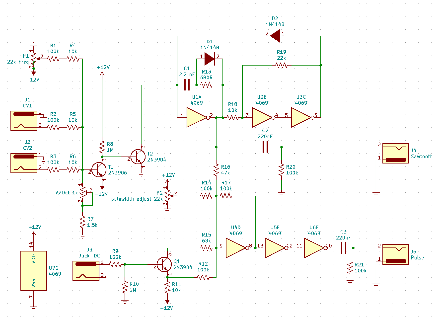

I was looking at the schematic again especially the PWM part and I see some things that might be helpful.
Most important is that the PWM generator is made up of 3 4069UB gates. What this means is that the voltage at the input of the leftmost gate must be no lower than zero volts.
The first gate is a linear amplifier and it works like a crappy op amp.
T3 in an emitter follower amplifier where the lower 100K resistor is its output.
The 68K resistor (has nothing to do with T3) and supplies a positive bias to the "op amp".
The PW adjust raises or lowers the waveform with it's output which is a DC bias.
The input to the op amp is a summing node.
The op amp output is then passed to 2 logic gates which switch at (Vdd-Vss)/2 which is what is converting the saw to a PW controlled pulse wave.
So I would think that if the 47K resistor is removed (this feeds the saw into the PWM circuit), some combination of CV and the PW pot should allow the CV to move the PW from near zero to at least 50%. This would mean the voltage at the output of the first gate in the PWM circuit should move from (I think) zero to perhaps as much as 1/2 Vdd or even all the way to Vdd measured against ground.
I don't see anything about how high the CV for PWM can be, but logically it can't be higher then V+. So in testing, I'd start with the PW adjust wiper to ground and move the CV from 0 to 10v. You can just use a pot to make this CV (0v and 10v on outside terminal, wiper is CV out) Then move the PW pot and try that again. It's good to know what is going on and maybe this will give clues about how to fix it.

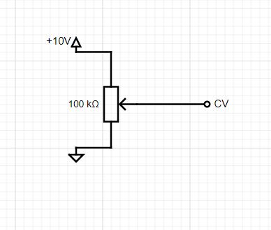

OK just for clarification (As I am a bit stupid sometimes Very Happy Very Happy )
Remove 47K get a pot (any value ??), create as shown in image below (+10v might be difficult to get, suppose 15v is not ideal ?? )
Then does the CV from this pot go to the PWM (not to one of the CV inputs ??)
Then what is it you are wanting to see, do you want me to get some meter reading or put the scope on it.. sorry for all the questions, I'm still a bit new to all this (even though I started building my synth about 15 years ago Very Happy Very Happy ) I still don't fully get it .. I'm sure I'll get somewhere near in the next 15 years Very Happy

PostPosted: Tue Feb 11, 2020 6:38 am    Post subject: Reply with quote  Mark this post and the followings unread
The point on the schematic labeled "pwm" is the CV input for PWM. So this VCO has two CV inputs, one for pitch, the other for controlling PWM.
Yes, that pot schematic is correct.

PostPosted: Tue Feb 11, 2020 2:28 pm    Post subject: Reply with quote  Mark this post and the followings unread
Fixed it jackson dancing
I tried what you said, took out the 47k resistor and made the little CV thing using a pot and I used a 9v battery thinking that was pretty close to 10 Wink
And I was totally lost, it just didn't seem to do anything really so I gave in and went back to basics.. I got the schematic out and followed everything with the meter on continuity checking everything that should connect did and that nothing that shouldn't connect didn't.
And I noticed a very silly mistake I had made ..
I had put the wiper of the pw adjust to the what should have been the tip of the jack in the PWM input and vice versa (if that makes sense)
Easy mistake Very Happy

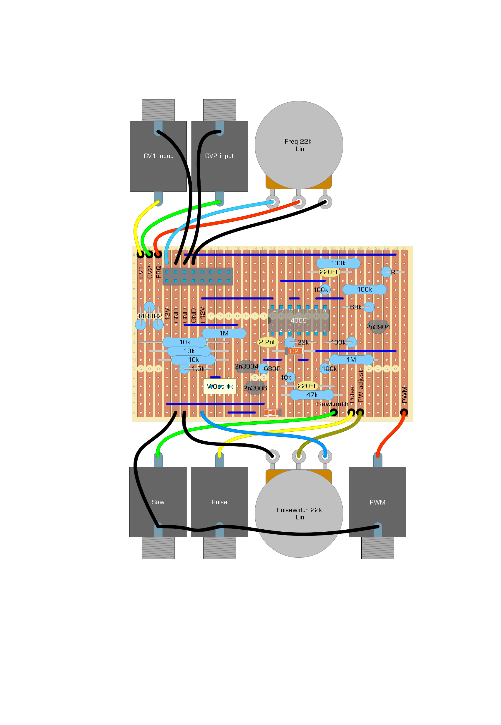

Ha! Great everything worked out for everyone of you - I'm gonna hijack this thread in advance since I finally started building up a eurorack from scratch (except the PSU - still had a leftover Doepfer-DIY-Kit-PSU from back in the days when I could spend my student's loan on modules....) again.
So after succesfully breadboarding simple saw-VCOs based upon CMOS Schmidt-Triggers (40106) and also succesfully building an MS20 filter guitar pedal with CV-control (that stopped working due to bad soldering a few weeks ago...) I want to give René Schmitz 4069 a try as the first intermediate module for the modular (I have already built a mixer years back that I recently disassembled to rework it and I will also put togehter some buffered multiples and simple utility-modules).
The last days I stripboarded a couple of things on the fly direcly from the schematics which did work for a couple of minutes until I changed minor things and most of the times I just desoldered valuable parts and put away the unfinished business to move on to something else when I wouldn't be able to find any electrical or mechanical mistakes. Anyway - this time I wan't to make the thing work properly so I started digging into KiCad and initially VeeCad although I couldn't get netlist transfer work so I finally moved on to DIYLayoutCreator and virtually populated a stripboard by hand.
Since many of you are really fast in understanding what's going on in circuits and what's not working properly before I move on to breadboarding and finally building the whole thing I wanted to share with you my stripboard layout (and transferred schematic) so you could tell me if everything looked okay. I triple-checked everything but as it is the case so often I might have missed something. I'm gonna post my progress in here as well (hopefully...).
Thanks in advance!
EDIT: I've already found and replaced a jumper trace going into Pin 6 (actually has to go into Pin 7 as GND-connection)
