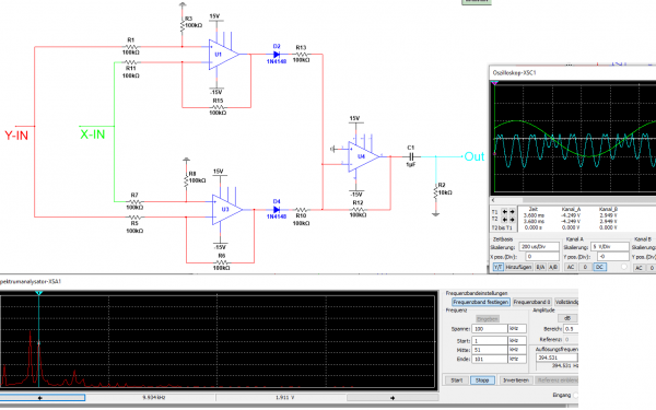

PostPosted: Mon Apr 27, 2020 12:13 am    Post subject: Reply with quote  Mark this post and the followings unread
the output-waveform looks quite similar to the one from circuit #4, but it would not suffer from impediance problems:
http://electro-music.com/forum/phpbb-files/most_versatile_sub_circuit_473.png
(sorry for posting opamps in the lunetta forum again Shocked )

dunno either if the toggler would do the job, probably yes?
the rectifier idea is not a bad one, if u analyse the fonitronic rm it is also based on two rectifiers http://electro-music.com/forum/topic-39762.html,
after messing around with the fonitronik circuit in the simulator, i came up with the attached circuit, the output wave form is not what we would expect from a "real" RM (same with the fonitronic RM) but the spectrum analysis shows the typical two peaks, one at 8khz and one at 10khz, input was 1khz and 9khz, the output is also unipolar - so one should apply a decoupling C/R or may a static offset.
@denmark i meant "my" circuit would not suffer
please let me know if iam to offtopic, but i personally love it to see different approaches to the same goal

PostPosted: Mon Apr 27, 2020 5:03 am    Post subject: Reply with quote  Mark this post and the followings unread
Thanks for posting that gabbagabi... the right half of Fonik's circuit is sort of similar to what I had in mind, but simpler and (probably) better.
As for burning east-germans, we're all wearing masks these days, so it might be less of a problem than it usually would be Very Happy Very Happy
I feel like half my posts are OT here, but it's great to learn from you guys, even if it involves ::gasps:: opamps and transistors!
