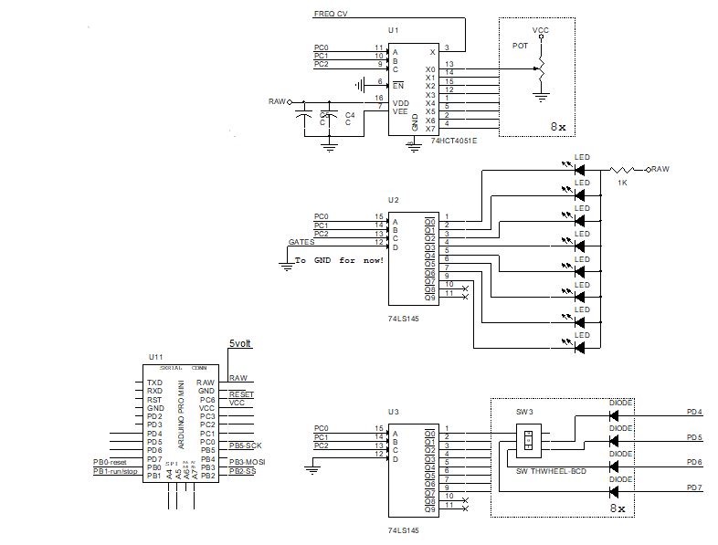

When I first saw the Metropolis made by Intellijel, I immediately liked the idea of the repetitions set by the slide switch and after watching the Youtube video I started to search if there was anything about the origin of the Metropolis, and behold: It was on this very forum where the M-185 made by Ryk was presented by RYK himself!
The Metropolis was a bit to complex to my idea so I went for a more minimalistic approach, where I could use an Arduino.
Now the first part is working, I have 8 slide pots for frequency CV out, 8 thumb-wheels so I can choose between 0 and 9 repetitions for each step.
U1 is an analog multiplexer/demultiplexer where the potentiometer is chosen that goes to a certain step. U2 is a BCD to decimal converter where the selected output is low while the non-selected outputs are all high.
The LED's connected to the outputs of U2 are the LED's mounted in the sliders of the pots, so you can immediately see which step (potmeter) is active.
U3 is again a BCD to decimal converter where the outputs are connected to the commons of the 8 thumb wheel switches to select which thumb wheel switch is active.
Proof of concept:
https://youtu.be/uXZbiiASfTs
