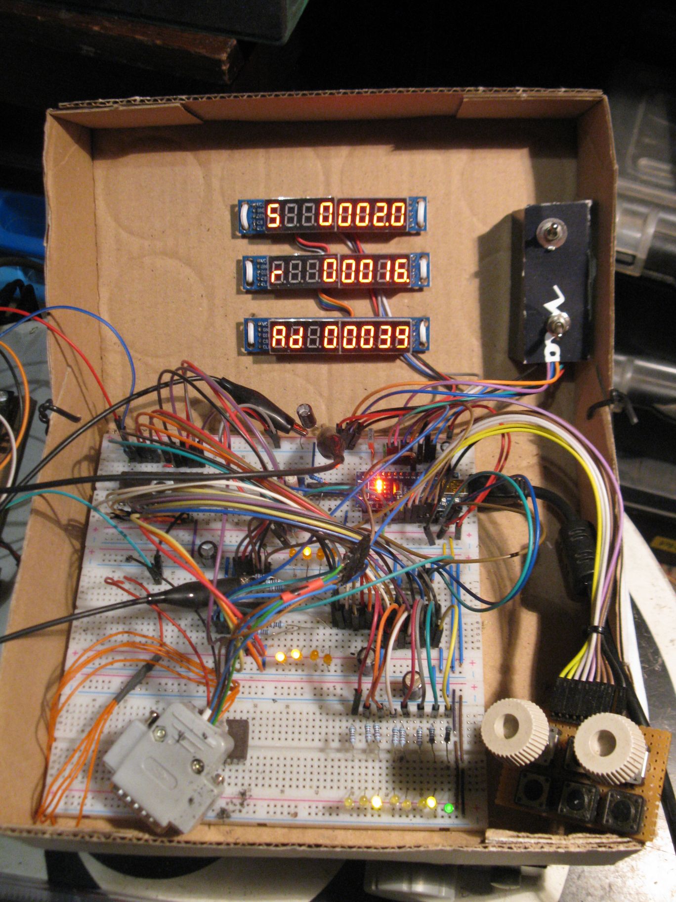

Posts: 5828
PostPosted: Fri Dec 13, 2019 1:09 am    Post subject: Re: Just another digital wave generator
Subject description: work in progress
Grumble wrote:
So I stumbled upon the Adventure Kid website where I downloaded the wave forms.
Oh that might come in useful. I have a ton (or more) of EPROMs to play with and had been thinking of loading some with waveforms.
I did do a test with a triangle- and sinewave before which looked promising. Also tried some drumsounds I found (thanks to Blue
Hell for writing a program to convert the data so I could use it) but that was made for a somewhat odd DAC so rather useless.
At the moment I am working on a circuit, or mostly the code, for exploring EPROM data by scanning the addres lines.

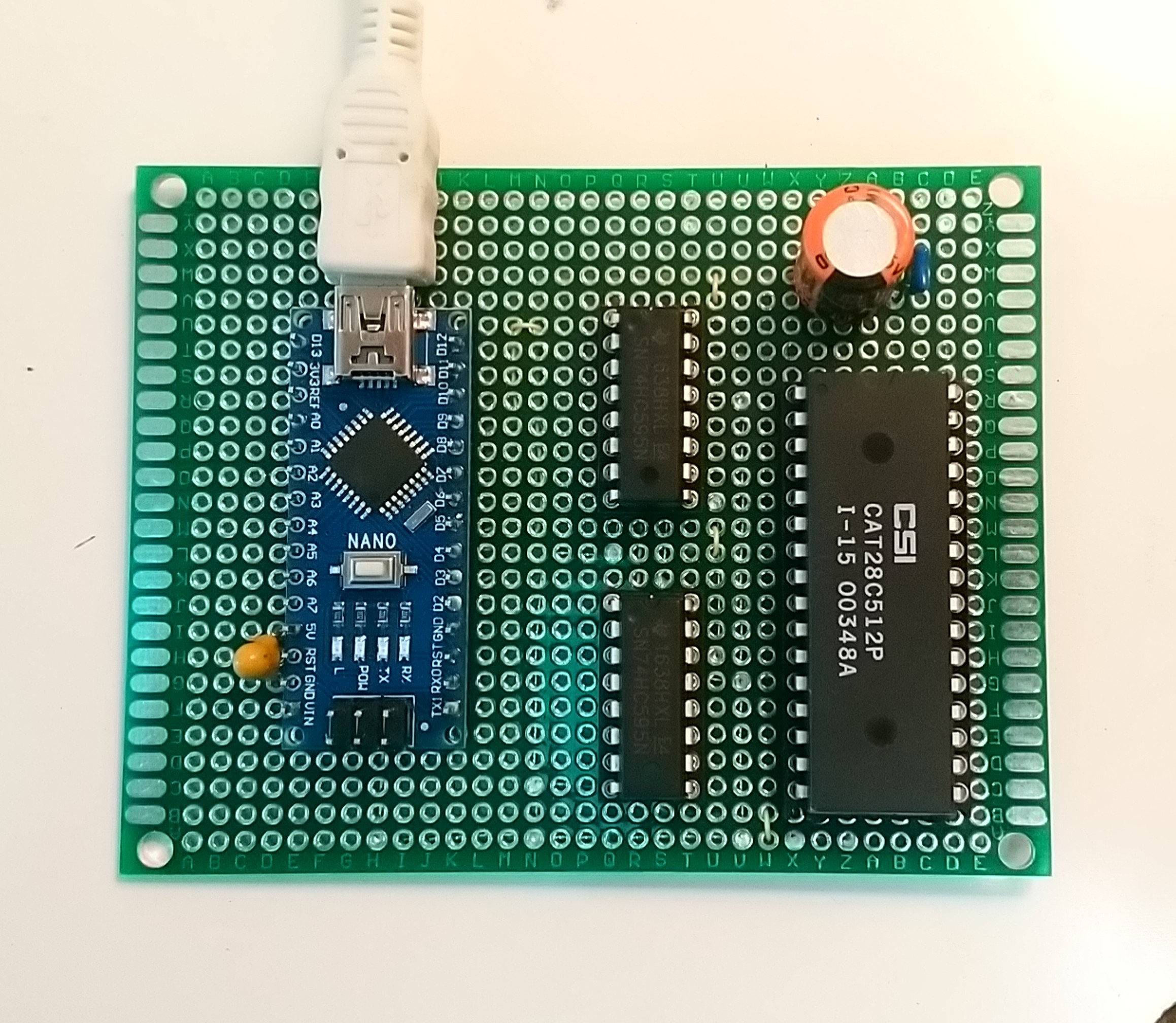

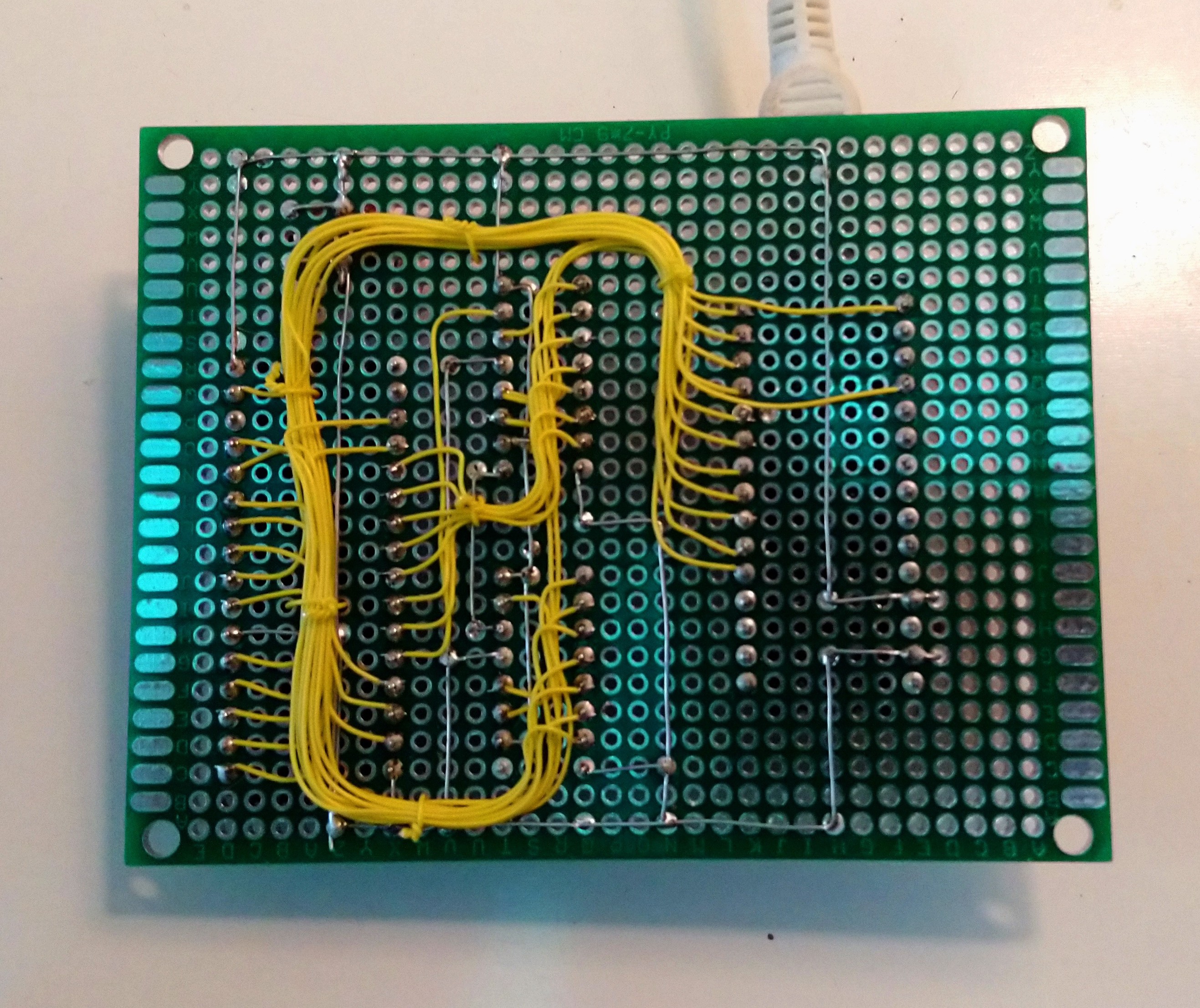

Posts: 1313
PostPosted: Wed May 27, 2020 11:43 pm    Post subject: Reply with quote  Mark this post and the followings unread
First hardware step taken : the eeprom programmer for the 28c512
With this eeprom programmer I can get data from LabView and program the wave-forms in the eeprom for my Adventourus Wavetable Generator.
 Filesize:  1.31 MB
 Viewed:  347 Time(s)
 Filesize:  797.49 KB
 Viewed:  327 Time(s)
my synth
Posts: 1313
PostPosted: Wed Jul 08, 2020 10:51 am    Post subject: Reply with quote  Mark this post and the followings unread
Finally I came to a point where there is actually sound coming out of the generator.
At this point (as shown in the video) the voltage controlled frequency works and the different waves can be chosen by means of a rotary encoder.
The adventure kid waveforms I use here are 512 bytes long*, so I had to make a 9 bit counter with a 74LS74 (LSB) followed by a 74LS590 for the next 8 bits.
These feed the eeprom directly while the last 7 bits of the eeprom are set by a 74HC595 in order to choose one of the 128 wave-forms.
*see remarks above

Posts: 5828
PostPosted: Tue Jul 14, 2020 9:34 am    Post subject: Reply with quote  Mark this post and the followings unread
that sounds great Razz , will have to read up and dive into it some other time.
VERY nice wiring on the EEPROM programmer btw!
