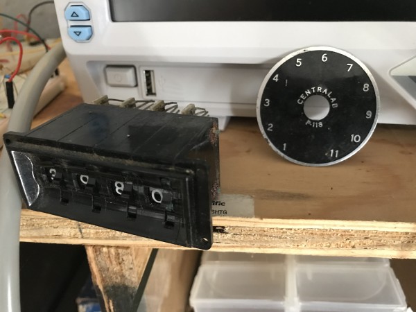

This old rotary selection switch was in a box of electronic parts my dad had. The eleven dial plate is screaming to be used on a master volume pot. The rotary switches are what I’m looking for ideas for.
It looks like a typical piece of hardware from the cockpit of an aircraft from the sixties and seventies. I used to set the tower frequency for the aircrew before they showed up back in the day.
I’m thinking of just building a panel with ten inputs and one output for each dial, instead of dedicating it to a specific task. It will be several months at least before I use it, so I’d like to hear your ideas. Thanks!

It goes to 11! You found the holy grail!

I have used two similar switches in my sequencer to set the number of pulses or length for each step.

Grumble, thats kinda along the lines of what my original ideas for those switches were. I'm leaning at the moment to something that I can feed whatever I want into it. 44 jacks will take up a fair amount of space, but the more I think about it, the more possibilities I see. Cool videos and sounds by the way!
Perhaps I should cut a panel big enough to hold all 40 inputs and 4 outs, but only drill enough to use one of the rotaries just to see how well it works in reality. The metal I get for free at the scrap yard. I need to order more jacks anyway.

Thumbwheel selector switch in a Lunetta environment = 4522B for preset decade down counter division
or 40102B for a pair
clock/n or frequency synthesis with 4046 -see EMM Harmonic Engine
