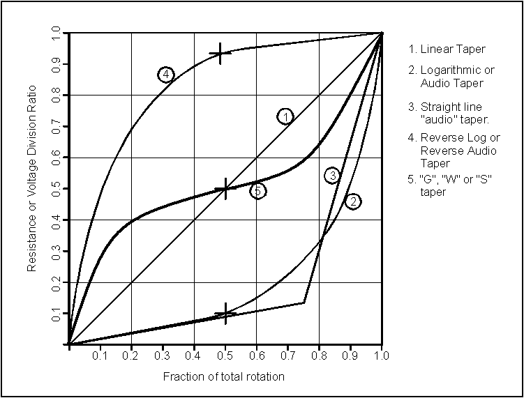

PostPosted: Mon Oct 12, 2020 4:43 pm    Post subject: Reply with quote  Mark this post and the followings unread
Grumble, by precision, you mean like the W-taper in this graph?
 Filesize:  14.16 KB
 Viewed:  193 Time(s)
Posts: 1320
PostPosted: Tue Oct 13, 2020 9:48 am    Post subject: Reply with quote  Mark this post and the followings unread
This is what Kasutronics calls the precision attenuverter and I just adopted this name, it is the one with the S curve.
