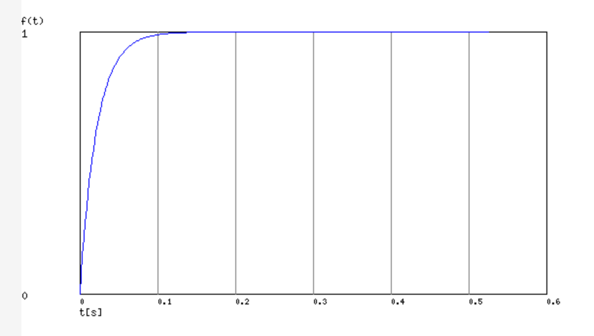

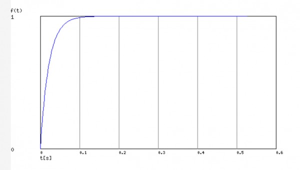

This is the step response of a circuit composed of 1Meg and 0.022uF

If you get the correct notes even with a short glide time then the S&H should be functoning correct. However keep in
mind that the glide time also depends on the notes you play. Notes that are close together will have a much shorter
glide time than notes spread apart. Time can be calculated with RxC so that would be 0.022uF x 1M = 0.022 Sec = 22mS
Of course the time depends on the voltage difference and to fully charge it from 0 could take 5x as long but that would still
ony be around 100mS. (more info about RC imes here)
