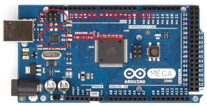

Posts: 1320
PostPosted: Thu Jan 28, 2021 1:23 am    Post subject: Reply with quote  Mark this post and the followings unread
Also the MEGA2560 can be used as a plug and play midi controller, just like the UNO R3 (as long as they have a mega16u2 or mega8u2 on board)
quote:
The HIDUINO project provides firmwares, documentation, and example code for building a class-compliant USB-MIDI device from an Arduino UNO or Mega 2560. HIDUINO does not use middleware software to convert serial messages through a MIDI loopback port (like LoopBe1 on Windows or IAC on OSX). Instead, HIDUINO provides a true USB-MIDI device for plug-and-play compatibility on Windows, OSX, and Linux - just like a commercial MIDI controller.
HIDUINO takes advantage of Arduino boards where a second AVR chip is used as the USB controller, so it won't work with single chip variants (e.g. Leonardo), nor older boards that use an FTDI chip as USB controller (e.g. Duemilanove). Many cheap Arduino knockoffs that pretend to be an Uno or Mega also might not work, since they tend to use the (slighly) cheaper FTDI chips.
HIDUINO is based on the LUFA framework by Dean Camera. HIDUINO was previously developed for robotic instruments and new musical interfaces @ the California Institute of the Arts.
The project name refers to a time when it was intended to contain many different USB-HID device types (joystick, mouse, keyboard, etc). The name "mididuino" is in use by an existing project, though it would be a more fitting title for this project.
Just use an external programmer to reprogram the atmega16u2 or atmega8u2 with the file arduino_midi.hex as attached to this post.
from: https://github.com/ddiakopoulos/hiduino

Posts: 5947
PostPosted: Thu Jan 28, 2021 8:24 am    Post subject: Reply with quote  Mark this post and the followings unread
but does it work as a USB host ? because I don't see that mentioned.
Posts: 1320
PostPosted: Thu Jan 28, 2021 11:09 am    Post subject: Reply with quote  Mark this post and the followings unread
Aahh ...no...it’s just a native midi controller head banging monitor but...full duplex Rolling Eyes
Edit: the mega2560 has 4 (four!) uarts so its possible to use it the way shown previous in this thread plus you can use a daw to generate cv-es if you program the atmega16u2 with the hiduino programm
my synth
