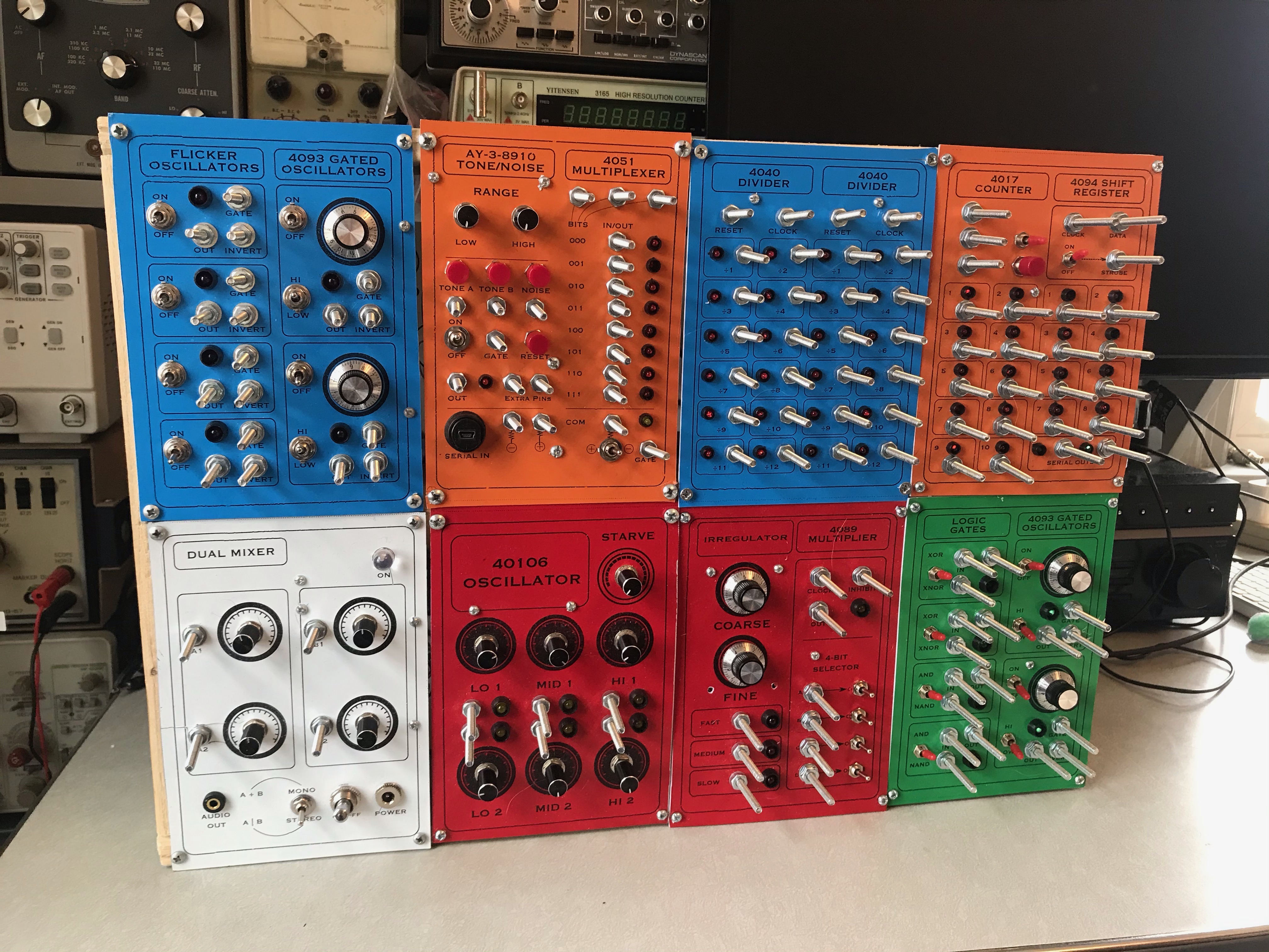

Hi Everyone,
I'm a LONG TIME lurker, but first time poster. Inspired by so many of the amazing circuits and designs on this forum, I decided to make my first lunetta as a way to keep occupied during the pandemic. I started back in the summer and just installed the final panel last week.
I owe ALOT to all of the collective wisdom here, but a special shout out goes to Phobos. I followed his example of using screws and alligator clips. I also included his brilliant flicker LED oscillators and gated 4093 oscillators. Thank you, Phobos! (Insert worshipful thank you emoji here!)
Most of the modules are pretty straightforward--dividers, mux, multiplier, shift register. But there are two that I'd like to share with the forum, so I can feel like I gave a little something back.

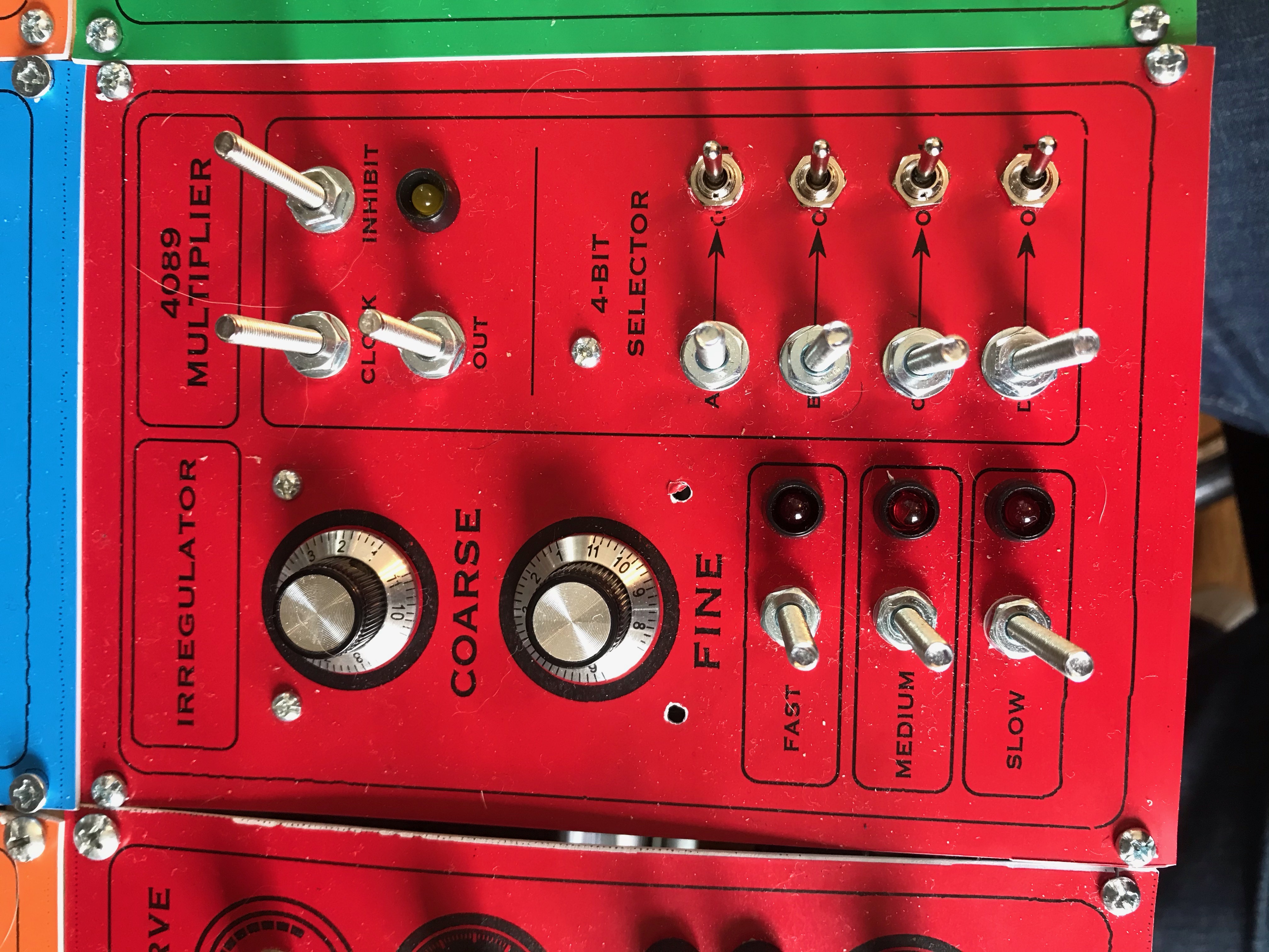

1. The irregulator. I wanted to get more irregularity and randomness out of my synth, so I made a circuit that cranks out unevenly spaced pulses. The heart of it is a transitor configured to produce white noise (by reverse biasing one of its diodes). Then that stream of noise is run through an op-amp comparator to filter it down a bit (connected to the knobs on the front) and a divider, to slow it all down even more and make it more into a pulse stream than just a blast of noise.
It works pretty well, and it is nice when connected to the multiplier circuit. I can toggle the switches on the multipler and to control the overall rate of the irregular pulse stream. It also seems to be affected by the amount of current being used across the whole synth--so sometimes it just goes a little bit weird all by itself. I guess that's a bug but I like to consider it a feature!
2. This one might be cheating, but...I also found that I wanted to be able to trigger a wider variety of pitches to use in things like the Melody Generator and other circuits. So I made a circuit that uses an Arduino nano to drive an old AY38910 (one of those chiptune style sound chips). I can trigger new pitches, or change various ways in which the pitches are made (chromatic, scalar, random, etc.) with CMOS level signals. The AY has three voices available: I'm using two for pitches and one for noise. I also the little mini usb port of the nano right to the front of the lunetta so I can reprogram it as needed, or even send commands from the computer to change modes or whatnot while the lunetta is going crazy.
When the Irregulator is triggering the AY, I've been able to get some really nice melodic figures, chords, rhythms. I'll post some tests/examples if anyone is interested in hearing them.
Anyway. This is really just to say THANK YOU to this amazing forum. I've learned so much here and found so much inspiration.
--Brian

Wow those look great, if you have time to post some samples that'd be super. I'm new to the forum and thinking about my own Lunetta project, thanks for the inspiration!

that looks great! what did you use for the frontpanels ?
I need to look for those panel mount USB connectors, that seems a lot easier to work with than having to
position the arduino behing a large hole. I have been thinking about making a simple module with just an
arduino but I am not sure yet what kind of hardware to add. (switches/LEDS/pots/inputs/outputs)

Phobos, for the front panels I used plastic sheets that are intended for laser engraving. I found them on Amazon and figured I'd give them a try. I printed out the panel designs on toner transfer paper, and ran the panels and transfer paper through a laminator to do the actual transfer. It's similar to what you'd do to make your own toner-transfer PCBs. They are stiff enough to work well for the front panels but also easy to drill.
The usb port is, I think, meant for boats or other places where you need a little usb extension. I'll toss in the link below. They come with a super cheap plastic hex nut that broke in about 2 seconds flat. They also have a weird cap that you can use to protect the usb port when not it use. I ended up drilling the top off that cap and using it to mount the whole thing. Worked out all right...
But I gotta say, I like having the arduino accessible and being able to reprogram it on the fly.

Ruebezahl, you're absolutely right, the 4089 works just the way you described it. It's not great for getting pitches, for the reasons you mentioned. I use it as a way to filter a stream of faster pulses. If I take the output of from the Irregulator, I can feed it into the 4089, and by selecting different bites get different degrees of density (pulses per second, etc.). I can thin out a dense stream of pulse by only allowing 1 pulse per 16 out, and so forth. Also, because the irregulator makes an irregular pulse stream, the 4089 tends to keep that irregularity audible, so the streams aren't totally predictable.
I put switches and bolts on each of the bits, so I can either manually control it (set it for, say, 1101, or whatever) or just hook it up to oscillators or counters and let the Lunetta set it. If I hook the most significant bit to a really slow pulse, say from a divider, you can get big shifts in texture. If I feed the output of the 4089 into the clock of that divider, and then let the divider select the inputs, you can get some really crazy results.
In general, I like having ways of controlling overall density and other global level phenomena with the Lunetta. It's one of those lessons learned from reading Xenakis' writings: work with chaos at a global level and let the details take care of themselves.
