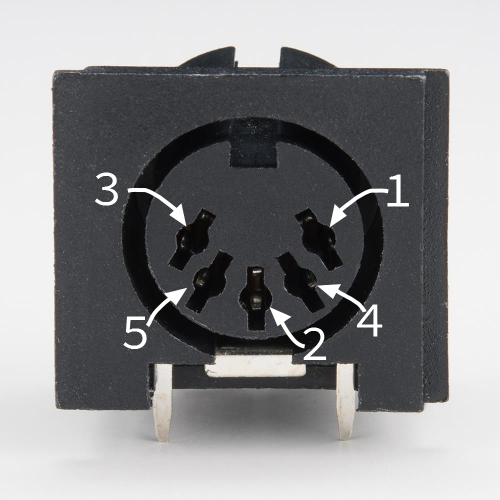

Hello community. I am struggling with this project a lot and it seems nothing is working. Basically i used this schematics, followed it 100%, i also contacted the creator who told me it would work fine. But it doesn't want to Sad
To test it i use esx1 as master and pass the signal to minilogue xd via this midi thru.
I ve done ton of research, i used different schematics, different opto but still nothing.
I power it using 5v cellphone charger. I even tried 9v battery brought down to 5v with 7805, but nothing.
Any ideas?

For me the hardest thing was to find pins 4 and 5 on MIDI socket - pinout is from the front or from behind? So attaching properly labelled pinout.
I had used some different values for 6N138 but as it not worked reliable for me (maybe because I'd not used Schmitt triggers), I had switched to 6N137.
Here is my schematic with 6N137 which I've used in two synthesizers so far.

Thank you so much for your reply! In fact... from what you are saying.. i must had soldered the 4 and 5 pins incorrectly. I will try changing them and update the topic

And yes!!! you were 100% right, pins 4 and 5 soldered incorrectly . It solved all my issues. It works perfectly now. Iam sooo grateful!!! Thank you so much!
