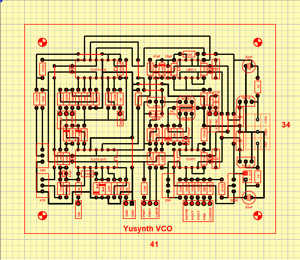

Hi PHOBoS
Would you mind to share the perfboard layout for the VCO?
Posts: 5883
PostPosted: Thu Oct 21, 2021 9:17 am    Post subject: Reply with quote  Mark this post and the followings unread
welcome party!
sure,
I had to delve deep into some folders but I managed to find it.
It does have some things unlabeled so I will sort that out first.
note: it is not stripboard but pad per hole perfboard.

Posts: 5883
PostPosted: Sat Oct 23, 2021 6:42 am    Post subject: Reply with quote  Mark this post and the followings unread
I hope these are useful.
The two diodes labeled with ** are matched 1N4148.

Posts: 5883
PostPosted: Sun Oct 24, 2021 6:50 am    Post subject: Reply with quote  Mark this post and the followings unread
Here´s a screenshot so you can actually see the grid.
