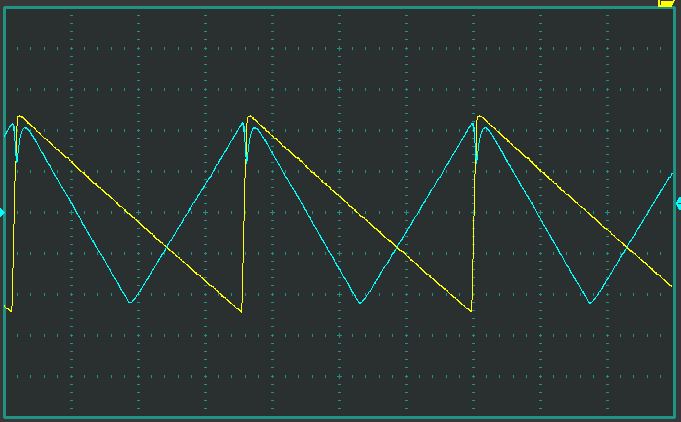

Hi there,
Previously I built the Simple VCA and Wavefolder module from YuSynth and I am very happy with them. Recently, I built the YuSynth VCO module. Everything is OK except for one thing. I tried everything to properly setup TRI and SINE waves but there's a ripple on the positive top edge of both TRI and SINE waves. SQR works perfectly. The oscilloscope screenshots are attached
Any ideas?
Thank y'all.
The triangle wave. Nearly 4 volts peak to peak.
 Filesize:  38.18 KB
 Viewed:  252 Time(s)
TRI and SAW together. Maybe gives an idea.
 Filesize:  46.99 KB
 Viewed:  239 Time(s)

PostPosted: Mon Dec 20, 2021 11:06 am    Post subject: Reply with quote  Mark this post and the followings unread
this is kind of of normal behavior
(for all saw-vco`s)
(if you need a perfect triangle you need to build a triangle core vco)
you can play around with C12 (47pF),
i have used 10pF for instance
important is, that you listen to it, if you like what you hear - leave it like that
in a vco the sound important,
if it is a LFO you have to check if that error is audible, mostly is not (you can only see it on your scope)
cheers

PostPosted: Mon Dec 20, 2021 11:12 am    Post subject: Reply with quote  Mark this post and the followings unread
It is actually audible at the high end. I will check the cap. Thank you my friend.

PostPosted: Mon Dec 20, 2021 12:54 pm    Post subject: Reply with quote  Mark this post and the followings unread
I tried various caps and 680p was the best (this is far beyond 47p). Lowering the cap increased the ripple. The ripple is gone but as the frequency increases amplitude goes down. Not a perfect solution but acceptable.
