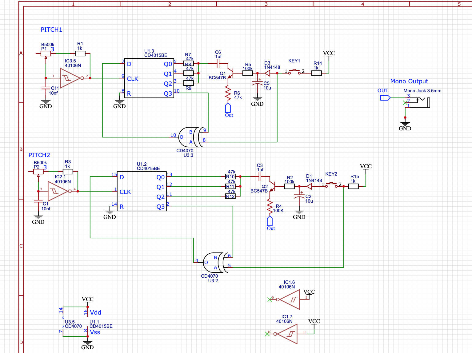

Did I get it right?
On each new trigger of KEY1 a new note will generate based on PITCH1
On each new trigger of KEY2 a new note will generate based on PITCH2

What you say is right, but the circuit will not work because input A of U3.3 is left floating. How do you intend to use the circuit and what are your inputs?

I meant to connect input A of U3.3 after the button, just before the diode anode (same as in KEY1)
the original circuit generating a new note for pitch1 and pitch2 on every new clock of the TEMPO part of hte circuit. My intended is that on each manual pressing of KEY (either 1 or 2) a new tone will be generated.

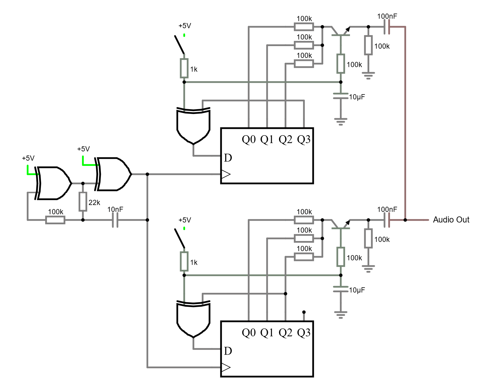

You may want to try this on a breadboard. The good thing is that it requires less parts as well.
There is only one oscillator built from spare XOR gates. Because they have no Schmitt-Trigger in the inputs, we need two gates for the oscillator. The same clock now feeds both shift-registers. However, the frequencies will be different, because their feedback path is different. Even better, the two tone frequencies will always stay in a harmonic ratio. I haven't tested the circuit, but it does simulate ok.

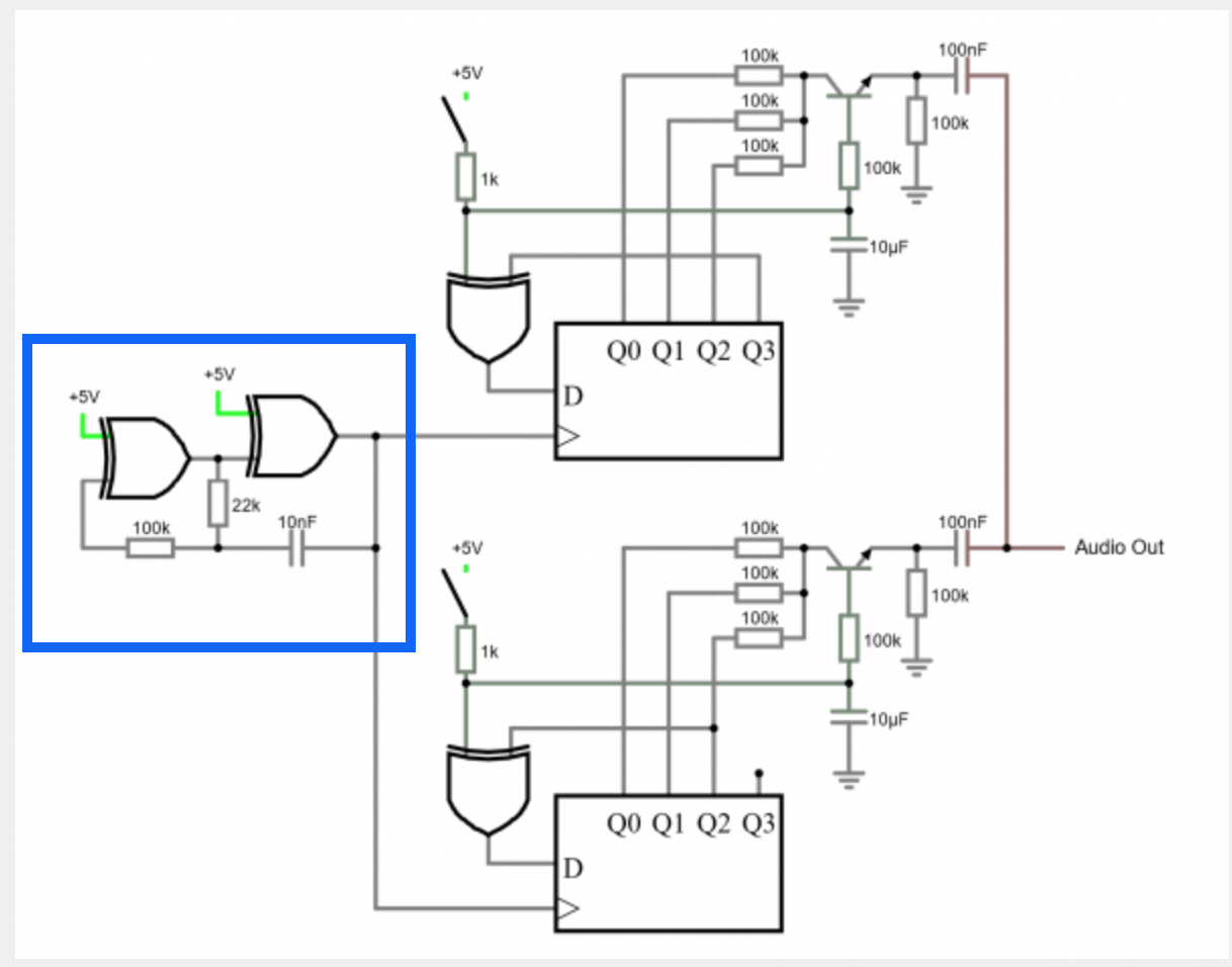

The two xor gates I marked in blue are forming an oscillator at a fixed frequency? that is determined the fundamental frequency for both the two tones? if so - is it possible to add a potentiometer to change it fundamental frequency?
Why the bottom tone generator is feeding the xor gate from Q2 while the upper tone generator is feeding the xor gate from Q3?

The two shift register taps cause differing frequencies. The one fed from Q3 is 1/8 the frequency of the oscillator. The other fed from Q2 is 1/6 of the oscillator.
Looped shift registers form a divider depending on which step is selected Q2 is the third step and Q3 is the fourth. The two XOR gates that are not part of the oscillator invert the output from the selected shift register stage diving the frequency by another two. hence 1/6 and 1/8. Don't be tempted to remove those XORs or you will have no output.

What is the functionality of the two xor gates marked in blue?
Steveg
Joined: Apr 23, 2015
Posts: 184
Location: Perth, Australia
PostPosted: Sat May 14, 2022 3:20 am    Post subject: Reply with quote  Mark this post and the followings unread
They act as inverters to make an oscillator. By tying one input to +5v the XOR gates become inverters. Two inverters can form an astable multivibrator. There are plenty of explanations of the circuit on the web. Here is one: https://www.eleccircuit.com/the-experiment-use-inverter-gate-as-oscillator-circuit/
The explanation only has one resistor but two is usual.

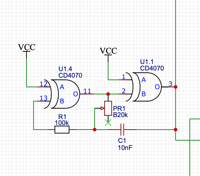

Can I replace the 22k resistor with a 20k potentiometer? For controlling the frequency of the oscillator?
will that circuit will work with 9V supply?

Yes and yes. However the oscillator won't work at all if the pot resistance is too low. I don't have a good idea of where the cutoff will be but I would suggest putting a 10K resister in series with the pot.

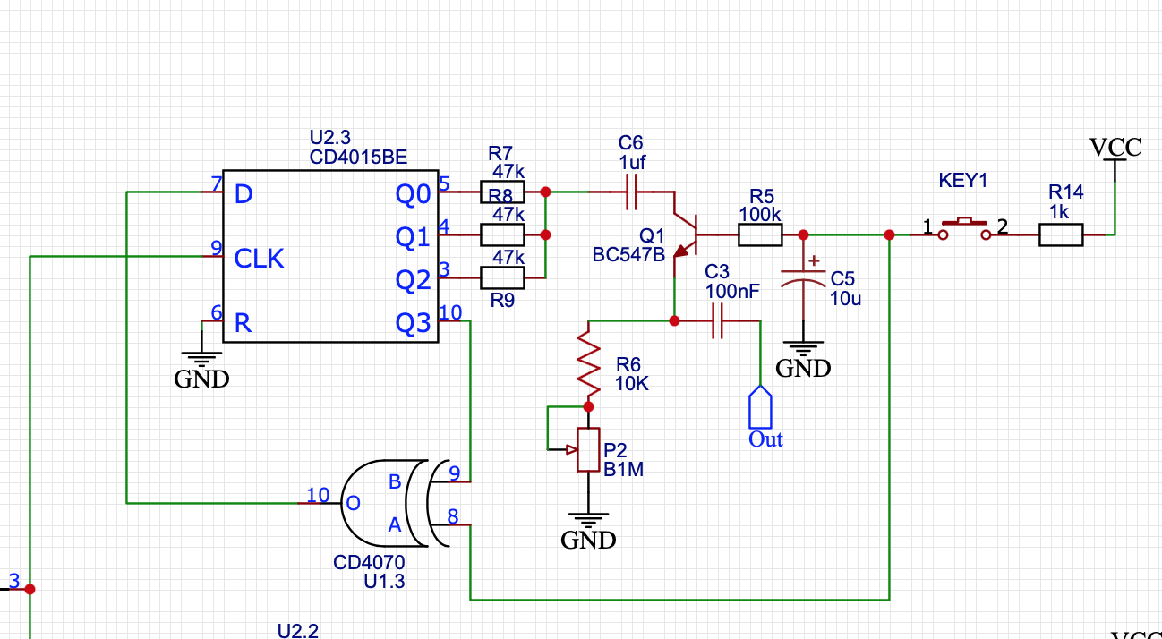

Can I add a potentiometer in series with the 100k resistor to ground so the decay time could be change?
Will that work?
R6 changed to 10k instead of 100k and it will keep the path to ground at minimum of 10k (?). The P2 B1M will make the decay time variable when turning the shaft(?)

Add a potentiometer in series so the decay time could be changed?
The capacitor discharges through the transistor and the resistor to ground. Rather than exchanging the resistor to ground with a pot, try to replace the resistor to ground with a 10K and the resistor to the base with a 10K plus a 100K pot in series.
