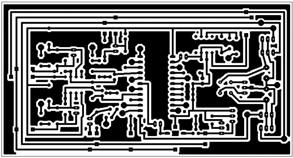

After reading the datasheet I decided that the best thing to do is to build a “trainer”. This trainer should have :
a) four supply voltages (+12, +5, -5, -12)
b) all the circuits that are on the datasheet to control the chip

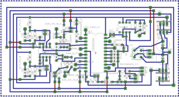

So I build this:
After building the trainer I discovered that some section did not worked as expected (or worked at all)
Building the trainer:
(Please read all before wasting your money and time)
1) The “DCOs buffer and external signal” part do not work – so don’t build them
2) The waveselection part work as expected (I mean the voltages and bit selection are ok) but do not have influence on the wave selection – (maybe if you use the Abalog part only) I only change R37 from 33K to 1K to be in the voltages the chip needs (regarding the datasheet), but If the jumper is removed, the analog part becomes a little unstable. I thing the best thing to do is to connect the WS CV Pin (6) to the -5V supply directly (both converter on). Not tested.
3) After building the PCB and BEFORE inserting any chip:
A) control the supply voltages
B) build the CV part (not shown in the schematic) Almost every input worked with 0 - 5 V. Except the balance -2.5V / +2.5V, and the filter CV (-2.5V / +5V).
Every CV is done with a 100KB pot. (one end to GND and the other to +5V). BUT the filter CV has a 33K resistor and is connected to the -5V supply (-5V / 33k / 100KB pot / +5V) and the Balance is connected to the -5v and +5V supply with a 47K res. (-5V / 47K / 100KB pot / 47K / +5V)
C) connect the CV potentiometers to the PCB
D) check (test) every voltage in the chip socket (first the supply and then the CV – test if they are in the expected range)
E) test the WS selection (if you decided to build it anyway) – If the voltages are not in the expected range, tweak the R37 resistor. Refer to the datasheet
If everything works as expected, disconnect the supply and insert the chips.

Well this is it. I think the first part is finished. Here are the PCB and Layout EAGLE files, If someone wants to make a better PCB, take the parts that do not work out, and made a nice Analog module, feel free.

If you do a pcb you should include pinout for narrow and wide body CEM3396! There are two versions (eg matrix 6 uses wide body, matrix 1000 narrow body). Beside the physical dimensions the chips are the same.
