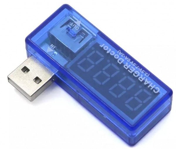

I bought this at Aliexpress. Very cheap, very usefull
It displays voltage ánd current, but be aware that this measuring device also consumes power!
