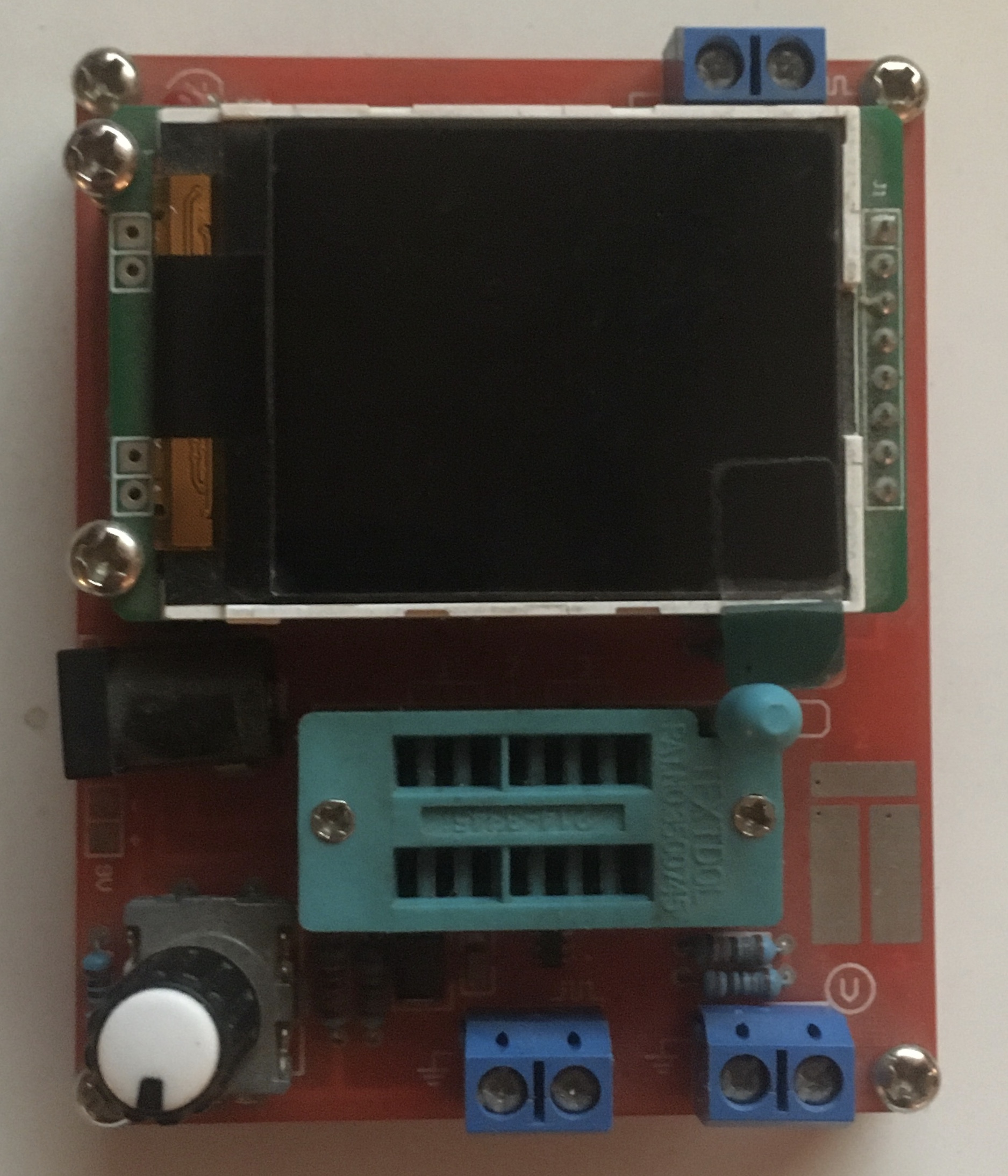

i dunno ,the one i got labels the P channel fet as PNP or NPN ,and the J112 like resistor so i don't really find it useful ,maybe that's useful for someone who understands more but it does not give me the pinout GDS ,can you show me what kind of tester you got ,or if you can suggest any ,it seems this that i got can read Mosfet but aparently not JFET
i got this one https://youtu.be/KS-JWDh0IbA

I never used that newer tester model.
Mine is older, with the last firmware implemented, 1.13k
It's close to impossible to know the version in advance, they usually don't know it and wont look for it even if you explain how/whwre to look for it. So you have to risk. 1.12k is fine too

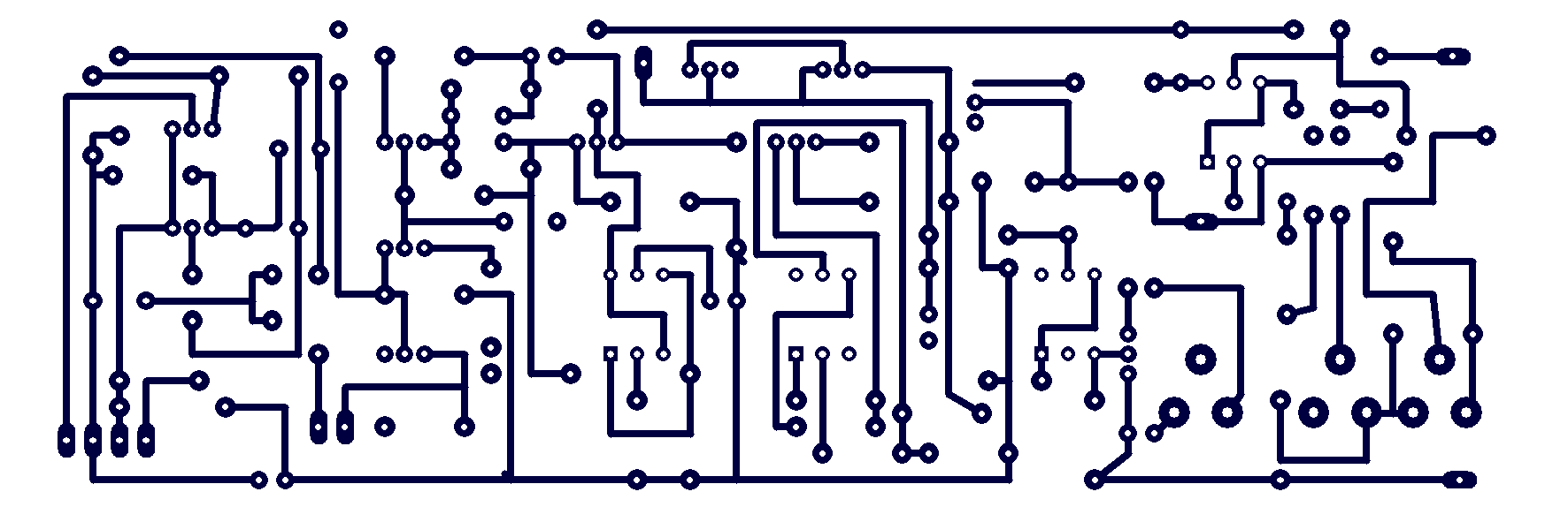

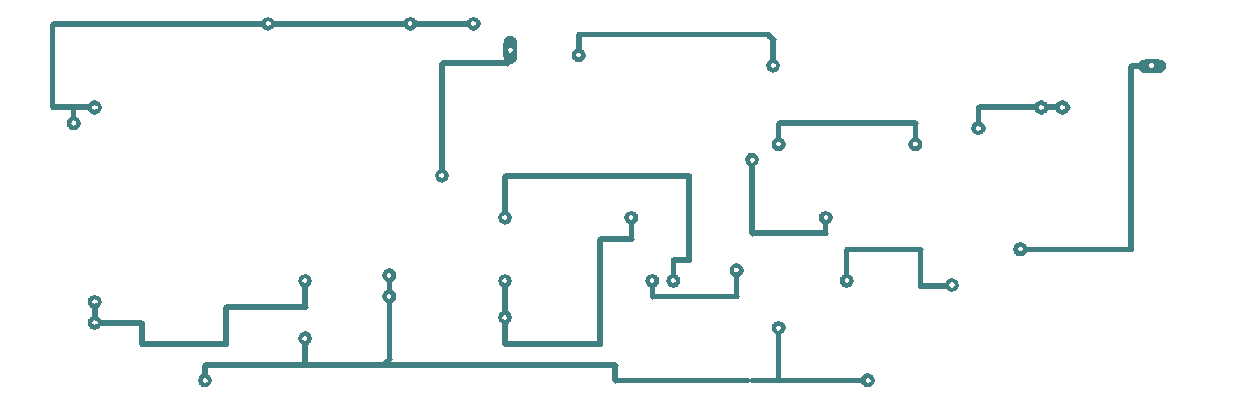

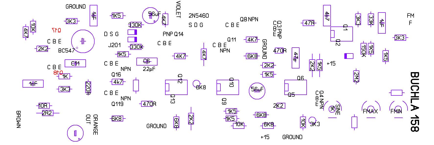

if anyone has more luck with JFETS ,here's my layout ,should be correct ,all npn pnp pairs used in the oscillator are matched BCM847/857

Are you identifying/using correctly the tester's 1, 2, 3 holes in the adapter?
For instance, mine uses the one in the center-right for 2, like 11112333
New ones I think use 12223333
*** You need to use 1,2,3 for the tester to read any 3 leg device. I mean you are maybe using 2,2,3 or so and the tester can't read them.
Also for resistors and capacitors, if you want a dynamic reading, you must use 1 and 3, not 1-2 or 2-3
Fer

i use the ones labeled as 123 ,nevermind really ,this is no big deal , i've built many 258's without this ,so it's all up to how correct is schematic , other thing i found at muffs is by la67 a comment ..the 1.5K resistors tied to the fet can be up to 2.5K if the transistor itself is off in idss ,someone has tried this and it works fine and it makes sense looking at the schematic ,i also found the same shaper in electronotes vco ,i am still waiting for the pcb's ..if it works great ,if not ..will have to find some other vco to replace it ,maybe pure sine vco from electronotes coupled with buchla timbre that also has a Jfet haha

read ebolatone's blog (link up the thread), he used trimmers initially on that position

as I said, 4391 will confuse automatic testers for shure
