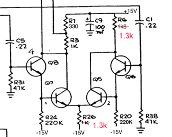

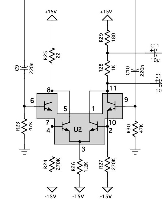

Looking at the two schematics there's a considerable difference in resistor choice for the output amplifier - especially the size of R25 in the Yusynth build (22R) and the same resistor marked R6 (1K3) in the René Schmitz circuit. Given the other resistor value changes in this section, are there any differences in how the filter sounds? In particular, does the emphasis control behave differently?
I've heard plenty of Yusynth clips and have this circuit in my own modular, but can't find any clips of the René Schmitz version.
UPDATE: I've just changed my Yusynth output amp to match the René Schmitz values as an experiment. There's no change to the filter cutoff (or at least, I can't hear any difference), but the real change is in how the emphasis control works - I now have a much broader spread of useful range with the control than I had before. It fixed a problem I had with the filter oscillating only within a knife-edge range of rotation, beyond which the volume dropped dramatically (almost to zero). I now get a nice graduation and with the emphasis control at maximum I don't get the sudden volume drop. I double-checked my component values just to be certain I hadn't originally got some wrong parts in there, but all was OK.

Did you rework the amp to be non inverting or just match Rene’s values?
