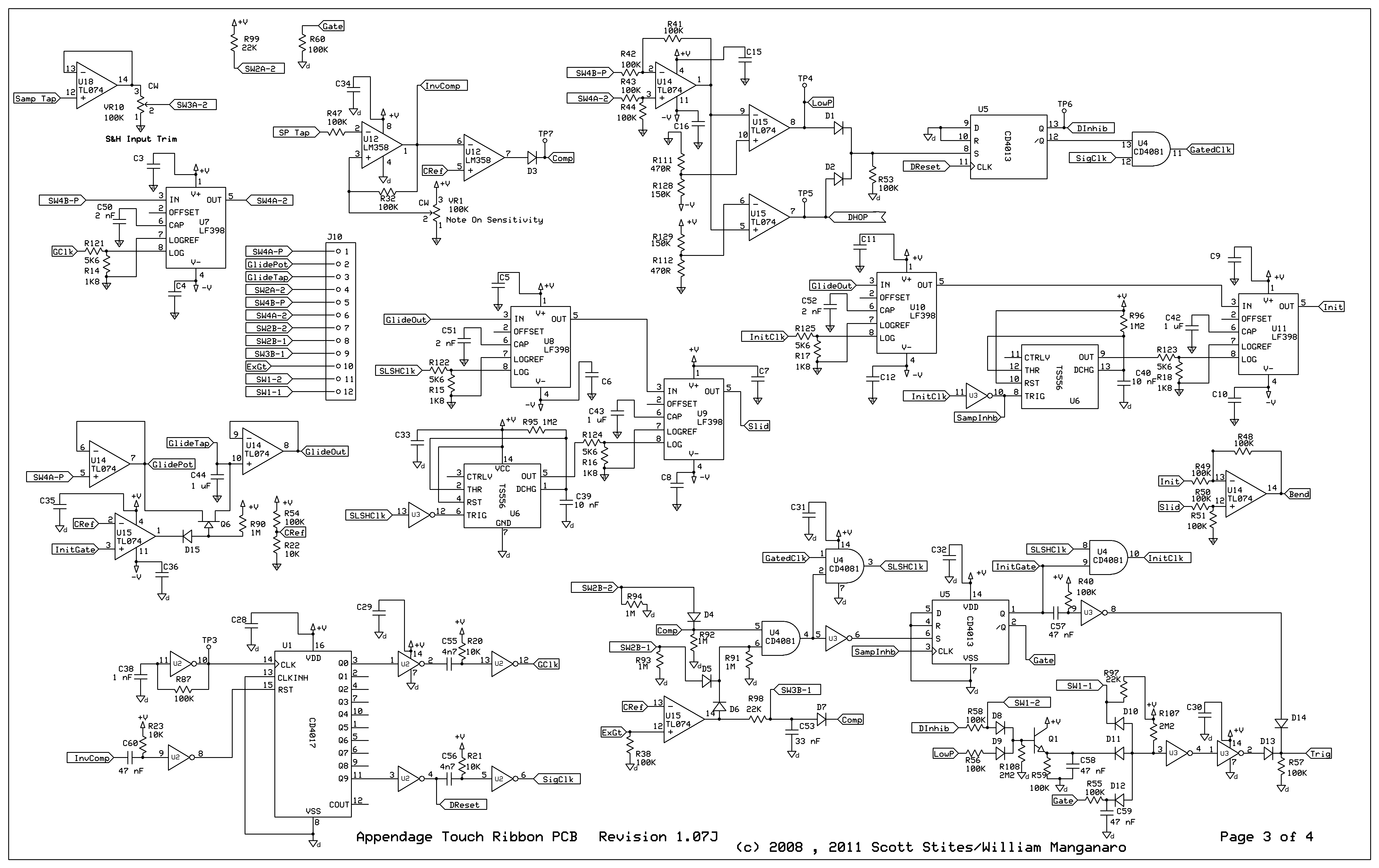

PostPosted: Wed Sep 26, 2018 3:50 am    Post subject: Really weird problem with Appendage Reply with quote  Mark this post and the followings unread
So, here’s the thing. I built the appendage on stripboard (don’t ask!), and it works completely – provided I warm the boards up with a hot air gun! The weird thing is, when it is cool (and depending on the ambient temperature), it works with the bottom couple of inches of the ribbon, but not higher up. As I warm the board up, the usable length of ribbon increases, until all functions work for the full length of the ribbon. Then, as it cools down, the top end ceases to function. (The usable length also increased slightly over time, presumably as current flowing in the circuit warms it up.)
I have traced the problem to the SLSHClk put out by AND gate U4 pin 3 (all references are to the 1.07J schematic, attached). The inputs to this gate, on pins 1 and 2 are the GatedClk, and, effectively, Comp – which goes high when the ribbon is pressed. I measure the GatedClk as a pulse with a frequency of about 1.1 kHz (my main clock runs at 11kHz), with the positive going pulse being 37us wide. That is present on pin 1 regardless of where, or whether, the ribbon is pressed, or the temperature. Likewise, pressing the ribbon, at any temperature and anywhere, makes Pin 2 go high.
The output on Pin 3 SLSHClk, ought therefore, to be identical to the GatedClk, when the ribbon is pressed. Which it is – at the bottom end of the ribbon or when I warm the board. But at the higher end of the ribbon, pin 3 remains Low. In a transitional length of ribbon, pin 3 goes High with a 1.1kHz pulse, but the width of the pulse decreases over half an inch or so of ribbon from 37us down to less than 1us and then to nothing.
Since the output on U4 pin 3 also ultimately drives all the S&Hs, and the sample deinhibit, it makes sense that the absence of a SLSHClk would indeed mean no sample.
Been tearing my hair out over this one. Any help welcome!
I have swapped the 4081 in U4, to no avail. I am using ST HCF4081’s – not sure if using CD4081 would help? My other thought was that the SLSHClk signal is fed into pin 8 of U8 (LF398) via a voltage divider consisting of 5k6 and a 1k8 resistors. That means there is a 7k4 path to Ground, which assuming SLSHClk is at 12v (when High), would seem to mean U4 pin 3 has to source about 1.6mA. The datasheet for the HCF4081 says the maximum output drive current at 10v supply is typically 2.6mA, but could be as low as 1.1mA. At 15v supply, the minimum is 3.4mA and typical 6.8mA. (I’m not sure if these are per gate or total for the whole IC). So I am just wondering if my IC, at 12v supply, is just on the cusp of being able to supply the necessary current – and presumably if it is unable to do so, the gate won’t function properly. Quite why, or how, this depends on both temperature and the voltage sampled by the ribbon (which as far as I can see is not directly in the various clocking signal paths) is a mystery.

PostPosted: Wed Sep 26, 2018 8:27 am    Post subject: Reply with quote  Mark this post and the followings unread
The first thing that occurs when you talk about heating up the board is solder joints. Heat makes things expand and could complete connections that are otherwise dodgy. Those are often hard to find by poking and probing because usually putting your meter probe onto something can *also* complete a dodgy connection.....

PostPosted: Wed Nov 14, 2018 9:33 am    Post subject: Reply with quote  Mark this post and the followings unread
Is there any reason why the voltage divider on U8 pin 8 uses such low values? The LF398 doesn’t need any significant input current to that pin, so why not use, say 56k and 18k? That would reduce the load on the AND gate.
But maybe there is some other explanation?
How did all work out? Did you get this working and if so, what was the remedy? I was starting to think the same thing that pin loading is the issue considering the inputs to the AND gate were the same always when working and not working. By design, there really has not been a loading problem on this gate and there have been many Appendages built. If you have not changed the chip to a CD4081, I would try that. If that does not work, then pull each chip that the signal feeds one by one and see if any of the these devices are causing the problem.

PostPosted: Sun Nov 18, 2018 10:42 am    Post subject: Reply with quote  Mark this post and the followings unread
thanks for the response. Been moving house, so not been able to work on synth recently. I've sort of parked this problem for a while - the board is a fiendish triple stacked stripboard with a rats nest of wires to the panel - not easy to get at components. But I think I can disconnect the output of the 4081, which should allow me to test the 'load' theory.

Then I recalibrated All steps back to Step 3-7 as follows:
Step 1, voltage at R34 in voltage mode: 1.475 V, at R34 in Current mode: adjusted up to 1.475V
Step 2, Gate set at low and high end of softpot with voltage at 10.46V
Step 3-5: adjusted again to -4.751V
Step 3-7, adjusted again to +0.607V
Q: What are the voltages from the ribbon itself directly at the top and bottom, measure U13 pin 8.
U13-8 A: press Top = 1.485V
press Bottom (where the connection is) = 8.03V
Q: In theory your ribbon should be measuring from not quite 10V (or whatever your voltage from the regulator is) to somewhere not too far under 2V.
is R117 correct (330K)?
A: Yes.... Orange, Orange, Black, Orange Brown
Q: The other thing that seems weird about the voltages you're reporting ...
U19A is summing the positive voltage from the ribbon, with a negative voltage from VR2 and then inverting them. If you're getting the expected ~1.9V from the bottom position of the ribbon, there should be *no way* that your output voltage could go more negative than that, because VR2 is supposed to swing between ground and the -rail, and the divided by 3 (the 330K resistor, with 100K feedback resistor) and inverted. The VR2 component should be (at the output of U19A) 0 -> +4V or +5V depending on which supply values you're using.
Note: Calibration not completed beyond step 3-8
A: voltages on U19
U19-2 = 0V
U19-1 = Idle = 1.438V, press ribbon top = -0.047v, press ribbon bottom = -6.57V
U19-6 = 0V
U19-7 = Idle = -0.082V, press ribbon top = 0.013v, press ribbon bottom = 8.96V
Other voltages:
U21-4 = Idle = -0.081V, press ribbon top = -0.014v, press ribbon bottom = 8.96V
U21-14 = Idle = 8.09V, press ribbon top = 8.09V, press ribbon bottom = 8.09V
U21-15 = Idle = -0.001V, press ribbon top = 0.003v, press ribbon bottom = 0.003V ***** Does not seem right *****
U13-1 = Idle = 1.4751V, press ribbon top = 1.483v, press ribbon bottom = 1.483V
U13-3 = Idle = 1.4751V, press ribbon top = 1.483v, press ribbon bottom = 1.483V
U13-10 = Idle = 0.002V, press ribbon top = 1.504v, press ribbon bottom = 8.03V
U13-14 = Idle = 8.10V, press ribbon top = 8.09v, press ribbon bottom = 8.08V
U13-7 = Idle = 0.024V, press ribbon top = 0.032v, press ribbon bottom = 0.034V
U20-1 = Idle = -0.025V, press ribbon top = 0.03v, press ribbon bottom = 0.03V
U20-14 = Idle = -0.026V, press ribbon top = 0.034v, press ribbon bottom = 0.049V
U20-7 = Idle = 0.001V, press ribbon top = 0.006v, press ribbon bottom = 0.009V
Q: Stupid question: do you have the bottom and the top of the ribbon mis-identified? Maybe the ribbon is mis-wired to reverse them, or maybe you have top/tap/bottom wired wrong in some other way?
A: I thought of this at first (because mistakes I make are usually stupid ones Smile, then tried reversing at the softpot connector. All it did was reverse voltages top to bottom. Pulled the entire thing up and retested from the PCB, through the Jack and trough the softpot. Wired correctly. No change.

PostPosted: Sun Mar 26, 2023 10:19 am    Post subject: Re: Appendage Calibration, Step 3 Reply with quote  Mark this post and the followings unread
sixbyseven wrote:
Wow! Thank you or the assistance.
You have your top and bottom backwards. The 1.485V is the bottom.
YES it is SUPPOSED to reverse voltages top to bottom. You need to press the 1.485V end (whichever it might be) in order to calibrate.

PostPosted: Sun Mar 26, 2023 10:54 am    Post subject: Just to clarify.. Edited Reply with quote  Mark this post and the followings unread
Edited.
I was getting -1.186 at the bottom and -7.29 at the top measured at TP1.
I traced the circuit from "SH Scale" flag on page 2of8 through to U14-7 where I am getting 0 through 5V, top to bottom. But -6.08V to -0.996 top to bottom on U14-10.
Then I realized the glide pot was all the way up, I then rotated it to minimum and now I get 0V to 4.675V top to bottom at TP1
I can't get the voltage higher than 4.743V no matter how far I adjust VR3
Weirder yet, is that it is acting more like a logarithmic pot, even though it is linear (tested). I can move from bottom to 3/4 of the way up the softpot until the voltage breaks below 4 V.
Question: Should the glide pot have that much effect to send this to -7V when fully turned up?
wondering if Q6 (MPF102) is messed up
