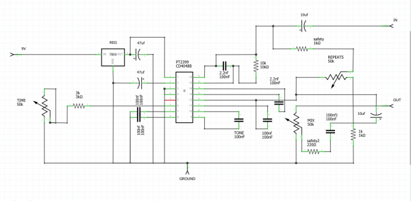

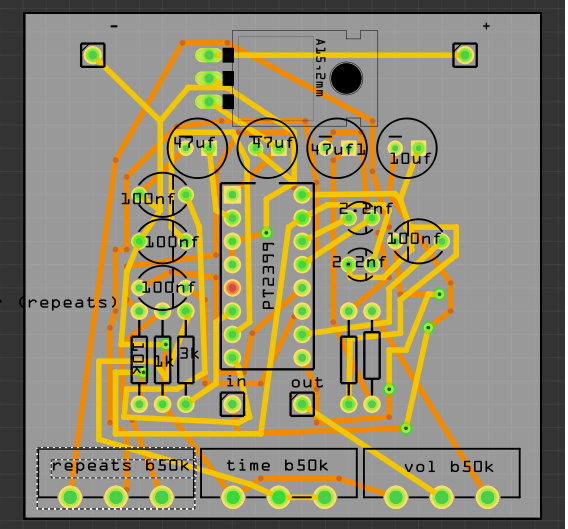

I've had this barbaric pt2399 circuit on my breadboard (it works perfectly (for my purpose) on the breadboard) for a while and have been trying to get it to PCB form so I can use it in projects however it never seems to work.
I have mapped it out on Fritzing:
My first attempt, I tried drawing it in on the schematic tab and autorouted. This design had output but it was completely clean, the knobs were basically doing nothing and no delay/effect.
Please see ATTEMPT 1 screenshots of the schematic and the autorouted pcb layout. I coudn't embed an image.
This latest attempt, I routed it on the breadboard tab, basically just following what I see on my breadboard and autorouted. This one I can hear very faintly the delay but the repeats and volume controls are a mess and the circuit is basically useless.
Please see ATTEMPT 2 screenshots of the schematic and the autorouted pcb layout. I couldn't embed an image.
I am not heavily educated on electronics, I just learn online and plug things in and see what happens. I am assuming I am making some classic mistakes, may be to do with how you should assemble components around the pt2399/autorouting not suitable.
Could someone help/shed wisdom?
Thank you.

PostPosted: Wed May 31, 2023 7:12 am    Post subject: Reply with quote  Mark this post and the followings unread
On both the schematic pictures the 5 volt coming from the regulator isn’t going anywhere but to +pin of the 47uF capacitor.

PostPosted: Wed May 31, 2023 8:33 am    Post subject: Reply with quote  Mark this post and the followings unread
Ahh OK, I'll look into that when I get home, cheers grumble.
As another note, do you think the potentiometers are wired correctly, doing some searching, Fritzing potentiometers might be set up not how they seem. As in lug '3' may be the middle lug, I assumed it was the 3rd one going ---> that way if turning it.
We'd be talking about the schematic version.
Posts: 1320
PostPosted: Wed May 31, 2023 10:05 am    Post subject: Reply with quote  Mark this post and the followings unread
In the drawing named ATTEMPT 2 - BREADBOARD CIRCUIT PCB LAYOUT.png (top drawing) the potmeters are differently drawn as in the lower drawings.
The middle pin of the potmeters are the wiper of the potmeter, between the left and right pin you should measure the total value of the potmeter, regardless of the position of the wiper.
As a sidenote: I can’t imagine why anyone should place a 10uF capacitor in series with a 100nF capacitor… so there is something wrong as well…

PostPosted: Wed May 31, 2023 10:56 am    Post subject: Reply with quote  Mark this post and the followings unread
Riggght OK so the pots are wired wrong then as the potentiometer part I used in the schematic; number '3' is the 'wiper' and not the 3rd lug. I'll figure that but would this be connected OK now for the power?
Would you be able to kindly elaborate on everything that looks wrong so I can troubleshoot?

PostPosted: Wed May 31, 2023 11:27 am    Post subject: Reply with quote  Mark this post and the followings unread
Reuploaded schematic as the default Fritzing values are probably confusing.
I circuit is based on a hand drawn schem I saw on Google so I am sure there are things that are not right.

PostPosted: Tue Jul 04, 2023 11:50 am    Post subject: Reply with quote  Mark this post and the followings unread
I don't have any experience with the pt2399, but comparing your schematic to the data sheet most of it looks fine now except for the bottom right hand section which has some differences. I suggest that you take a look here: https://datasheet.lcsc.com/lcsc/1806132210_PTC-Princeton-Tech-PT2399_C84963.pdf
