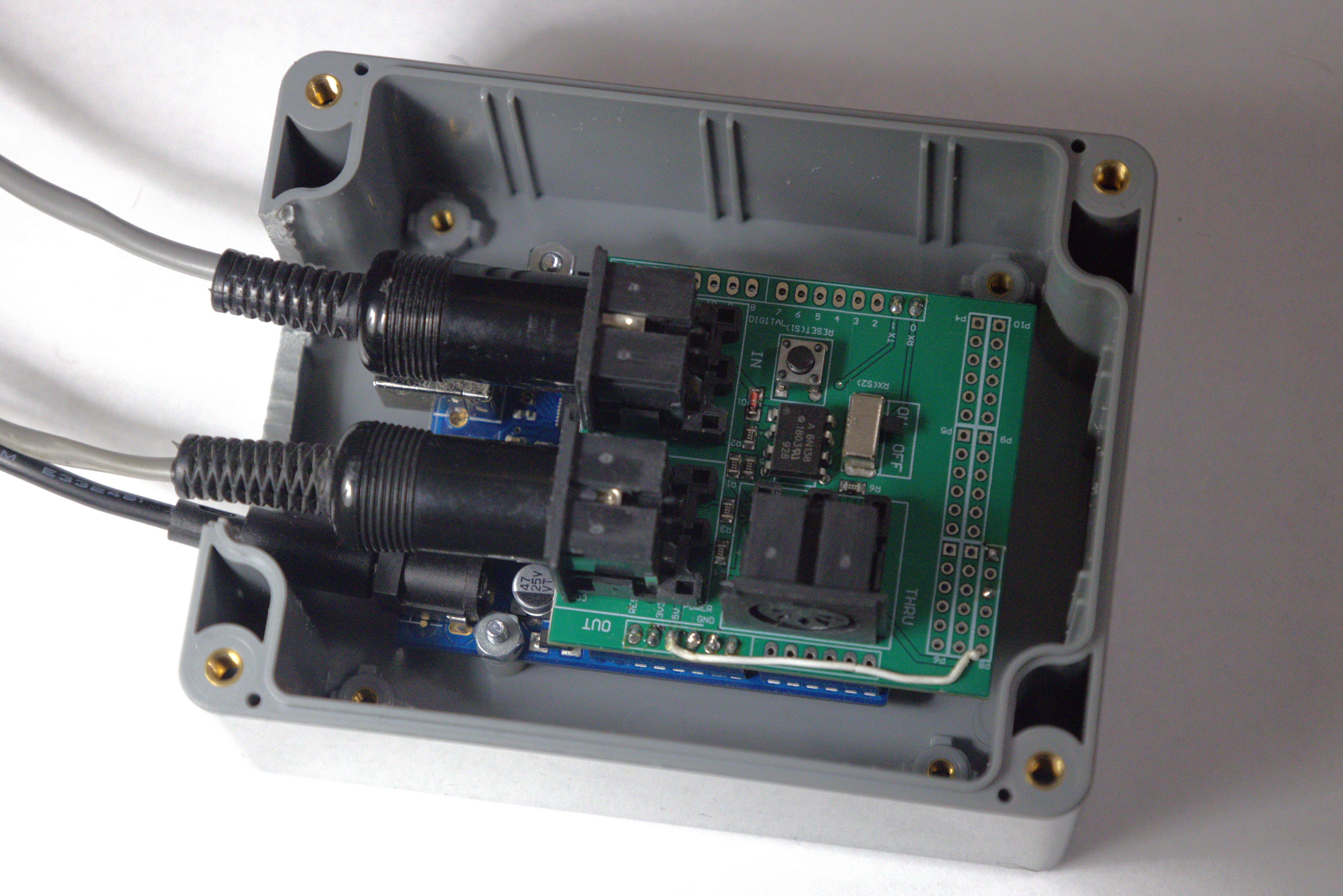

Hello to all.
I recently encountered a challenge with my setup involving the Looperlative LP1 and my modular synthesizer, prompting me to devise a solution in the form of a utility module.
For years, I've relied on the LP1 looper as a solid MIDI Clock source for my modular synth. One issue I faced was ensuring precise clock message divisions without any timing discrepancies. Additionally, I needed to maintain synchronization between my sequencers and the LP1.
Initially, I capitalized on a unique behavior of the LP1, wherein it sent a MIDI START message at the conclusion of the master clock loop. This served as a convenient trigger to reset my clock dividers and sequencers on the modular.
However, after updating the LP1's software, this handy "quirk" vanished. Fortunately, the LP1's creator, Bob, introduced a new feature. Users could now signal the LP1 with a custom program change message, prompting the LP1 to output the RESET message at the end of the master loop.
To retain the functionality of the original "quirk," my utility module comes into play. It monitors the MIDI message stream from the LP1 and, upon detecting a MIDI RESET, automatically dispatches the necessary Program Change message to the LP1. Thankfully, my FCB1010 controller, used to manage the LP1, conveniently passes its MIDI IN to its MIDI OUT.
Looking ahead, I have more Arduino projects lined up for this year. Specifically, I'm planning to develop quantizers and additional control circuits tailored for the modular synth.
Utility module to force the LP1 to send a MIDI Reset at the end of the master clock loop (cover removed).
 Filesize:  6.42 MB
 Viewed:  221 Time(s)
Utility module to force the LP1 to send a MIDI Reset at the end of the master clock loop.
 Filesize:  8.55 MB
 Viewed:  236 Time(s)

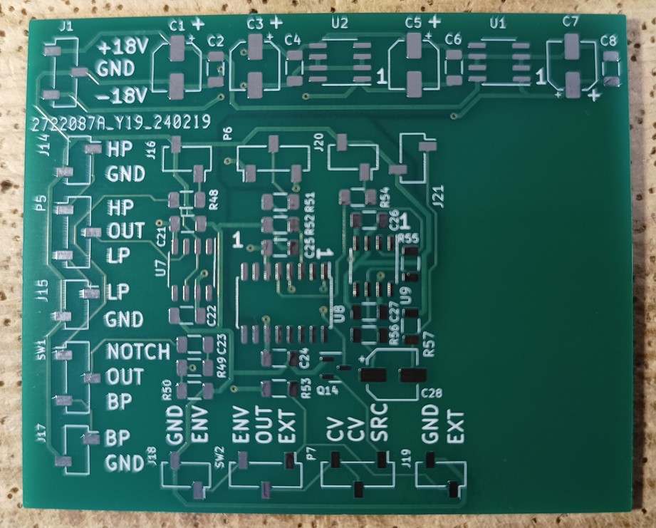

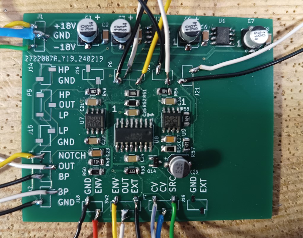

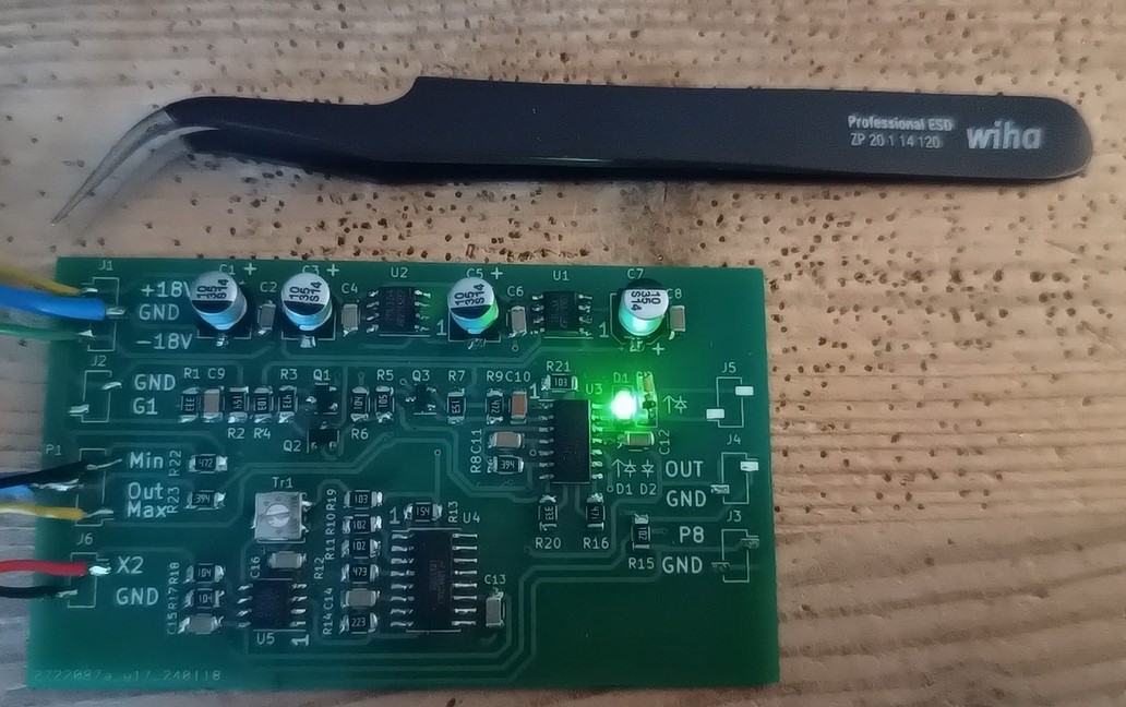

PostPosted: Sun Feb 18, 2024 3:38 am    Post subject: Oberheim SEM LFO submodule in SMT
Subject description: First feasibility evaluation of a SEM clone in SMT

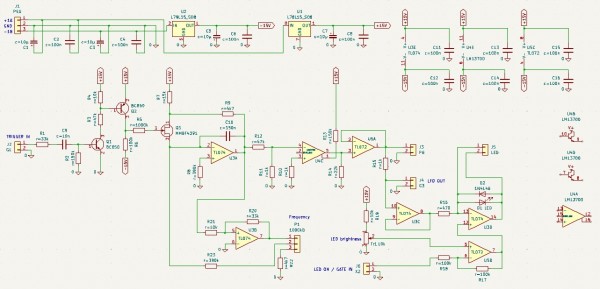

This is my first pure SMT finger exercise (beside one diode 1N4148). I thought cloning an Oberheim SEM would be a nice project for SMT training. I started with a rather simple sub project of the SEM, the LFO. Though rather easy, it has some functional specials for being integral part of a / my SEM:
1.) (Re-)Trigger(able): The LFO starts in a defined state when triggered. This can be used to sync several LFOs within a 2-, 4- or 8-voice instrument.
2.) Monitoring LED on front panel: Follows the LFO signal
3.) Monitoring LED on PCB: For debugging purposes
4.) Gate indicator: The LFO activity (on board and front panel) is only visible if the LFO is accessed by a GATE signal. This shows more clearly that the SEM is invoked in a polyphonic context.

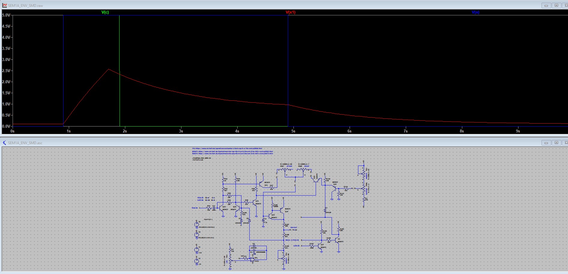

First, as in most Analogmonster projects, I made extensive spice simulations, especially as I changed some components into SMT variants:
1.) I replaced the n-channel-fet of the original circuit by the SMT MMBF4391-ONS transistor.
2.) I replaced the 741 opamp (only available in SOP) by the TL071 (available in SO-8 as well). In fact I used a TL074 and a TL072 in SO-8 as I needed more opamps for the "special" functions.
3.) I used the LM13700 as replacement for the CA3080 of the original, as the CA3080 is not available as SMD.
KiCad schema

LTSpice analysis: LFO out (V(g3)), Gate (V(x2)), Trigger (V(g1)), LED current (I(D1))
 Filesize:  490.8 KB
 Viewed:  222 Time(s)

Board
 Filesize:  155.59 KB
 Viewed:  192 Time(s)

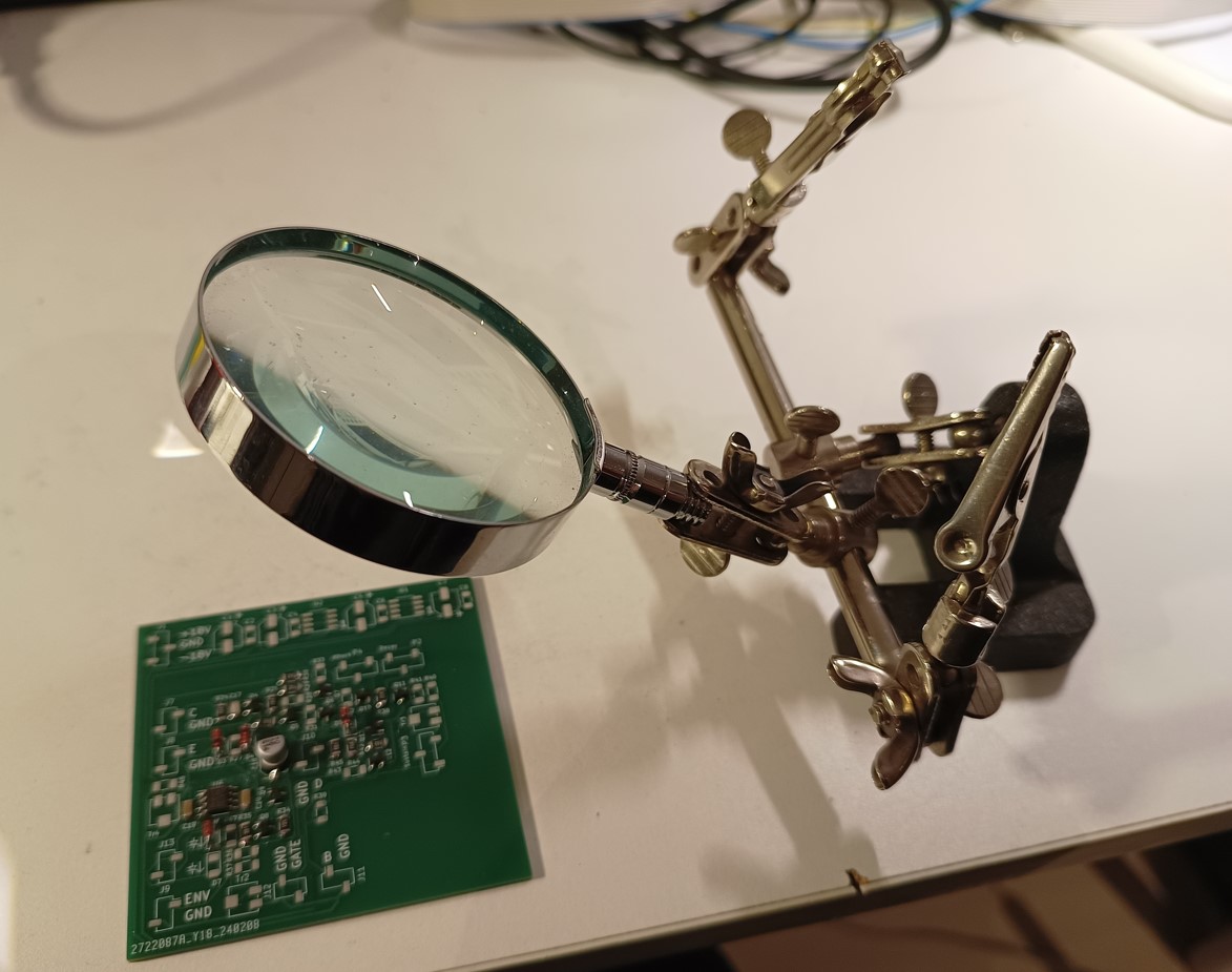

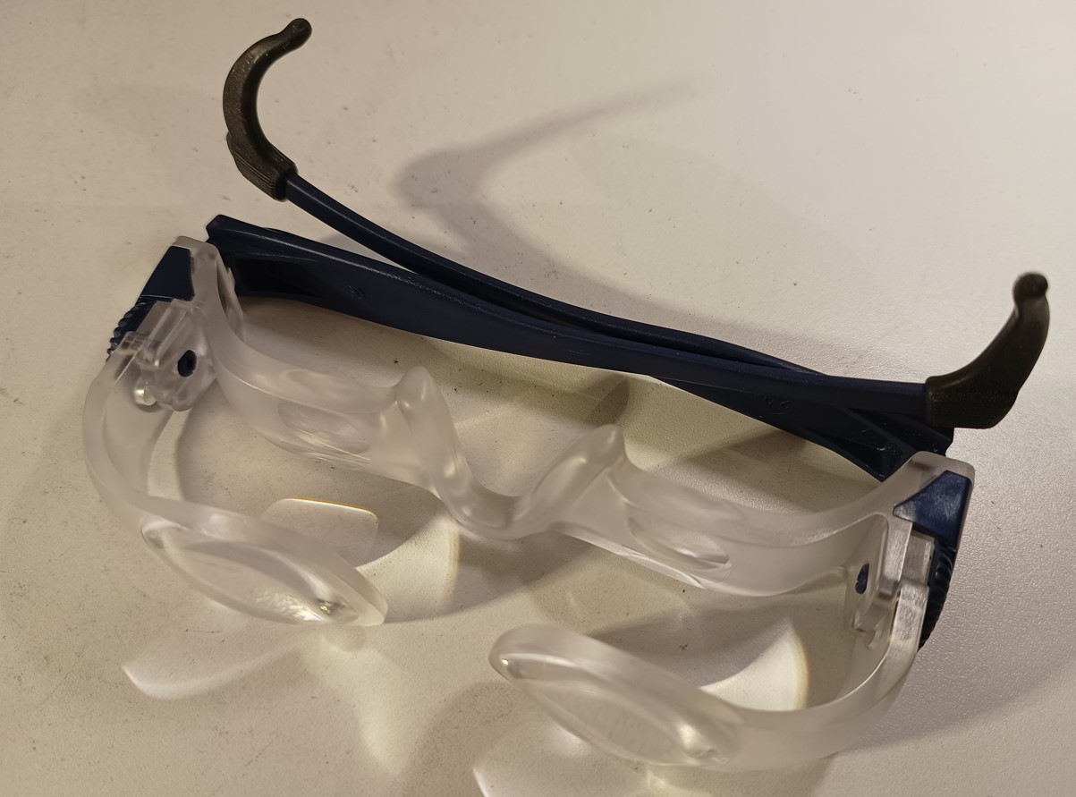

analogmonster wrote:
Finally I used my "standard" temperature of 400 degrees Celsius and my standard iron, taking into consideration that my first SMT exercise would be fried, but nothing bad happened at all, everythink works fine, short solder time with high solder temperatures seems to be ok, so this is my recommendation for first tests.
Really appreciate the information. Do you use a microscope or some kind of magnifier for SMT work?
analogmonster
Joined: May 30, 2011
Posts: 100
PostPosted: Wed Feb 28, 2024 11:17 pm    Post subject: Reply with quote  Mark this post and the followings unread

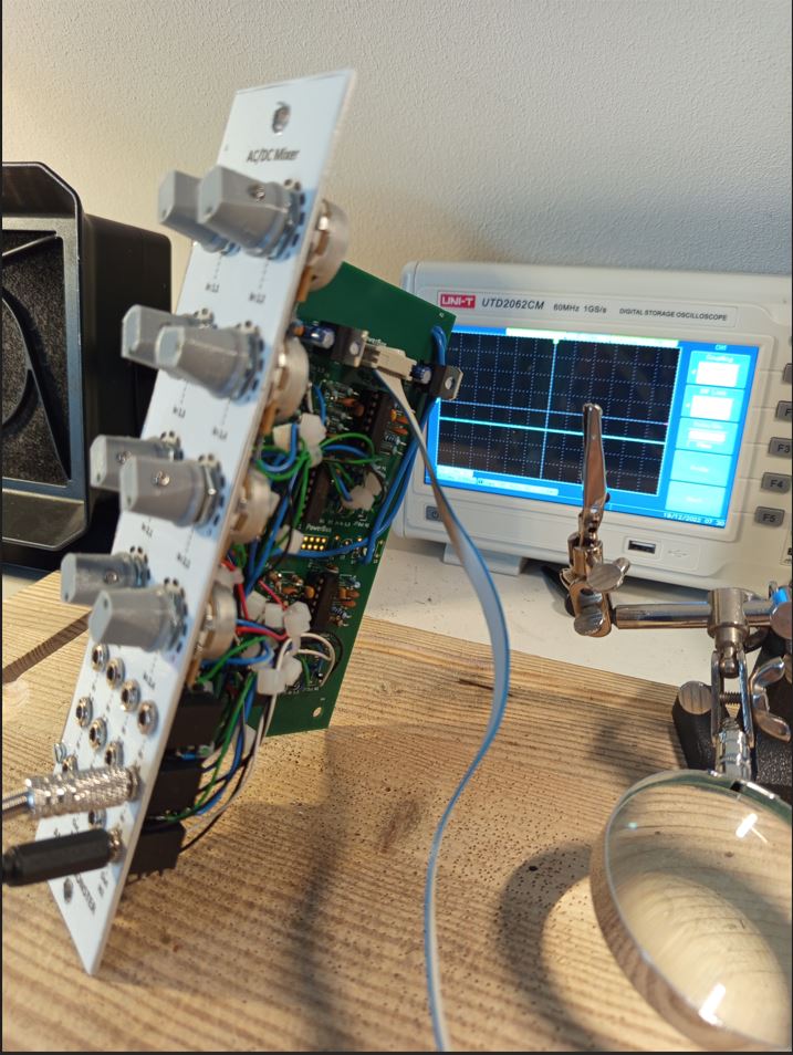

Yes, I do. For soldering of passive components like diodes, resistors or capacitors in 1206 size I use precision mechanic glasses (see below). This one magnifies factor 2.5. It can be adapted to the needs of your eyes (diopters) additionally.
For active components like transistors and integrated circuits (SO-8 size) I use a magnifying glass additionally (see below).
Precision mechanic glasses
 Filesize:  151.63 KB
 Viewed:  192 Time(s)
Tool with magnifying glass
 Filesize:  143.43 KB
 Viewed:  190 Time(s)

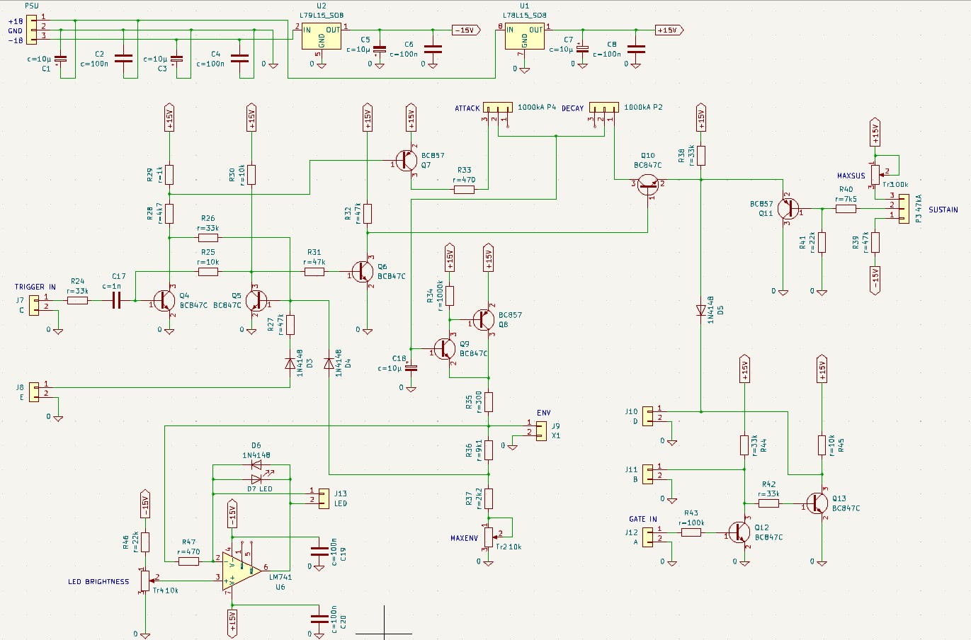

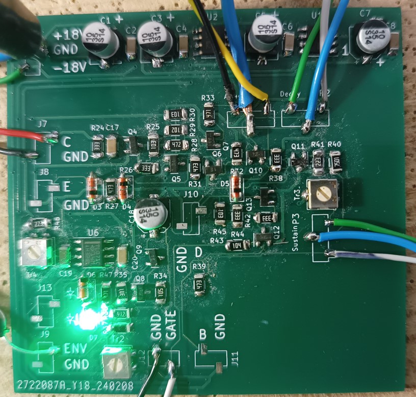

PostPosted: Mon Mar 04, 2024 7:59 am    Post subject: Oberheim SEM ENV submodule in SMT
Subject description: Next feasibility evaluation of a SEM clone in SMT
Ok, after finalizing the SEM LFO I continued with the next SEM submodule, the envelope (ENV). There are two of them in each SEM.
It is a bit more complex than the SEM LFO, but being the second finger exercise it was a bit easier to build. And again, I found differences compared to other ADSR modules (envelopes) I built before.
First of all: It is not really an ADSR. There is a RELEASE phase of course, but it is more an ADS than an ADSR, as the RELEASE time can't be leveled by a pot. It depends from the SUSTAIN level.
Second: There are two time setting input signals instead of one: TRIGGER *and* GATE (in other ENV modules only GATE is used).
TRIGGER-only works; in this case the SEM ENV works as AR module. GATE-only does *not* work, as there is no envelope created without TRIGGER.
TRIGGER *and* GATE let the SEM ENV work as ADS(R) module, only then you can determine a SUSTAIN level by leveling it with the SUSTAIN pot.
Third: The SEM ENV is a Moog (tm) native speaker. It is able to process Moog S/TRIG events as well, not only positive voltage TRIGGER and GATE inputs.
So in total the SEM ENV is the second surprise in my SEM clone project. It can create very snappy envelopes for cool percussive effects, and if you use square LFOs with different frequencies as GATE and TRIGGER input, you get quite weird repetitive envelopes beside the standard ones (see video).

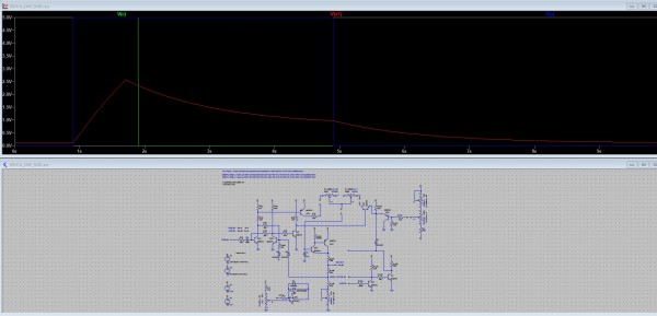

Again I did extensive spice analysis before building that thing. Find below the pictures, graphs and videos.
And again I added an onboard LED for debugging purposes.
SEM ENV as ADS(R): SUSTAIN stage is added by GATE input. V(c) (green): TRIGGER input, V(a) (blue): GATE input, V(x1) (red): ENV output
 Filesize:  325.79 KB
 Viewed:  214 Time(s)
SEM ENV schema (KiCAD)
 Filesize:  180.55 KB
 Viewed:  229 Time(s)
SEM ENV as SMT
 Filesize:  185.98 KB
 Viewed:  177 Time(s)

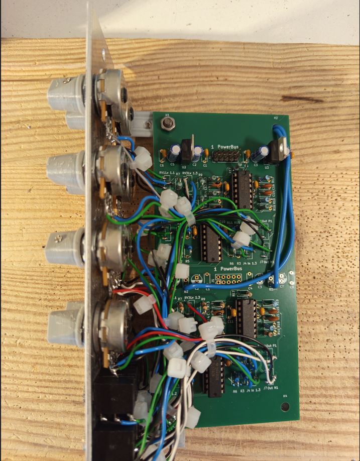

No. 3 of the Oberheim SEM submodules, the SEM VCA as SMT version, is up and running. And again I found some specials I don't know from other VCAs and which I consider as needed for integration aspects in the SEM environment.
The VCA core itself is absolute standard. An OTA based amplifier stage driven by a control voltage dependent current source. New for me was the source mixer onboard which does the job of a state variable VCF output selection and filter coupling (ร  lร  Moog 904-C filter coupler, see T904-C documentation). The other function I am wondering about is the voltage controlable DC offset setting. I know that the offset correction is needed for the specials of the SEM ENV output, but why voltage control? Perhaps someone can enlighten me.
Again I tried to be as close to the original as possible, but I had to do some changes for the SMT adaption:
1.) I replaced the CA3080 OTA by an LM13700, as no CA3080 exists as SMD
2.) I added an amplification level pot to avoid clipping due to external control voltages which are too high for the VCA
I integrated this test board into my Formant Modular environment and it works perfectly.
And again as always my offer: As JLCPCB always sends a minimum of 5 boards: If anybody wants to do own experiments or wants to build an own module from that board, contact me offlist.
The same for the other Analogmonster SEM SMT clone prototypes.
VCA board
 Filesize:  156.09 KB
 Viewed:  192 Time(s)
Populated VCA board
 Filesize:  214.75 KB
 Viewed:  181 Time(s)

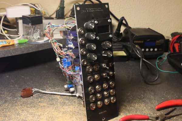

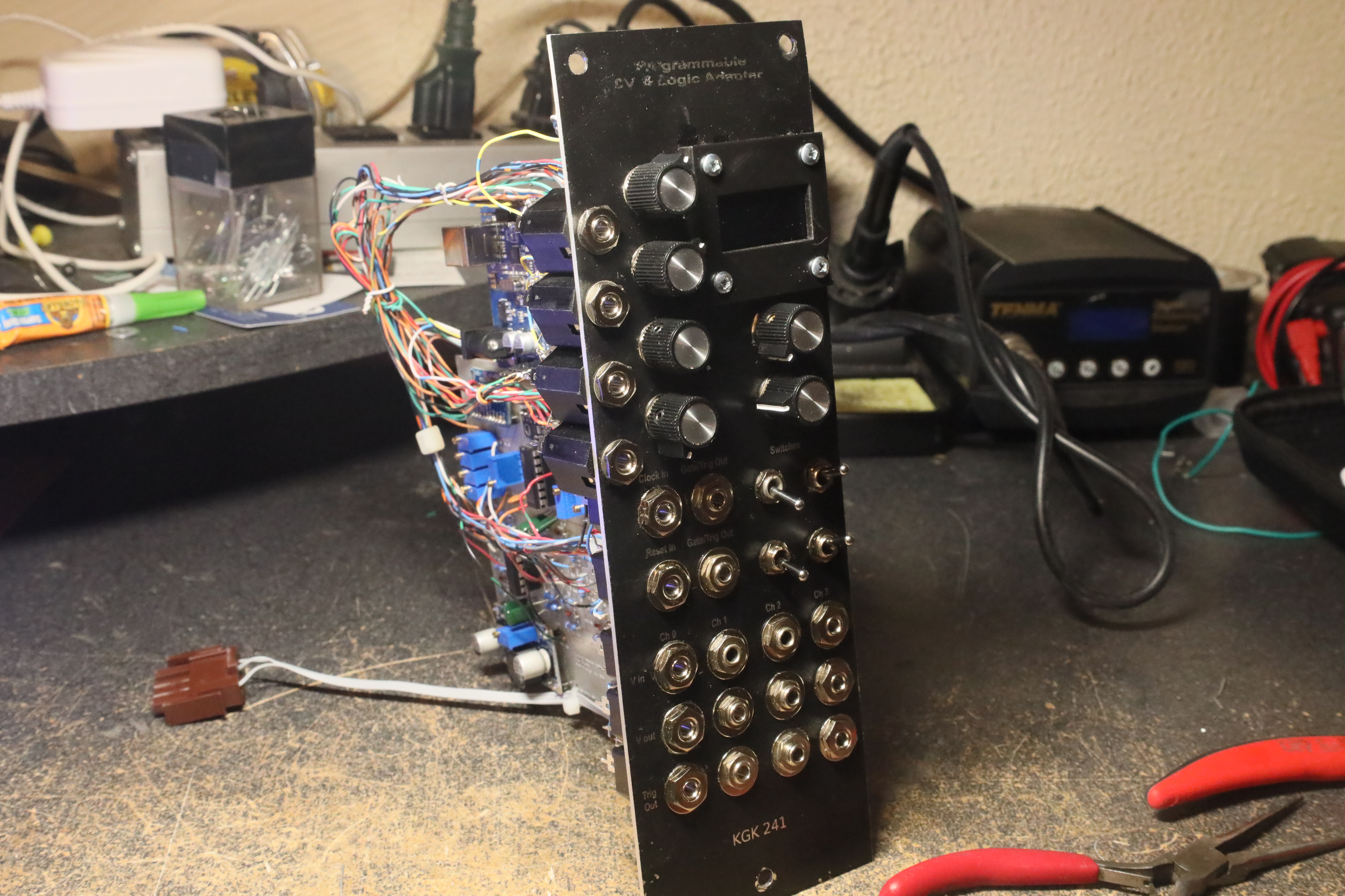

PostPosted: Tue Aug 13, 2024 7:01 pm    Post subject: Programmable Control Voltage and Logic Adapter
Subject description: Using an Arduino with the Modular Synthesizer
This module provides an interface between the Arduino's i/o and the synthesizer's i/o. The Arduino works with 5v Analog and logic levels and this module presents i/o to the synthesizer at 10v levels. The panel also has an OLED screen.
What the module does depends on the software I create for it! It is much easier to experiment with the module and software when it is mounted in the synthesizer. Thus, the non-application specific labeling and description.
The module (as configured) features the following:
(4) 16-bit Analog Inputs that handle from 0 to 8v
(4) 14-bit Analog Outputs that handle from 0 to 8v
(6) Logic output with 10v logic level (i.e., gates and triggers)
(2) Logic inputs that accept 10v logic levels
(4) Four 10-bit Analog Inputs with associated pots, normalled to 10v overridable via patch cord connections
(2) Control knobs (internal -- 0 to 5v -- they do not interface with synth but can be used to set non-cv parameters
(4) toggle switches (2 momentary contact)
(1) OLED screen
The 14-bit DAC provides 16,384 steps of resolution. Over eight volts (octaves) this resolves to .56 cent resolution which may exceed the accuracy of the analog VCO's anyway!
My original plan was to scale for an even 10v however there was noticeable noise when amplifying the DACS' outputs up to 10v. 8v was a good balance between noise and range. In addition to the scaling amplifier stage, I utilized a zero-gain buffer stage. This holds the output voltage constant despite the number of modules driven.
One of the issues when working with Arduinos is that they tend to "fry" when the logic levels are incorrect (particularly if a negative voltage appears on a logic pin). The module diode-protects the pins and separates them from the synthesizer levels via op-amp comparators.
The high-res analog inputs and outputs are designed to handle pitch-sensitive tasks. The low-res analog can handle Control voltages that don't demand the same level of precision.
The toggle switches are provided as another method to control the software.
OK, so what does it do? My current software project creates a quantizing sample/hold. The software supports two voltage maps that I call "scene-A" and "scene-B". The voltage maps correspond to different scales and tunings including non-quantization. A cross-fader allows gradual or rapid change between the scenes. A momentary-contact switch steps through various crossfade methods. Currently, I have an "average" method and a "wipe" method.
The "average" simply morphs from one table proportionally averaging the voltages based the control's position. The wipe selects scene-A or scene-B based on the control's position. In musical terms, if the pot is in the center position, all the notes from C to F are quantized with the scene-A table and F# through B from the scene-B table.
I am working on a common-tone method (that is, an intersection method). The idea is that the center position will give notes (voltages) that are common to both scenes. On positions left of center, the common tones plus notes unique to scene-A are presented, right of center introduces notes unique to scene-B. To program this method is a bit trickier than the first two methods!
Another feature of the software is that while it accepts a single input clock, the output produces clocks only when the voltage changes. I plan to make this a selectable feature and may provide internal clock dividers, etc.
I am using the four i/o clock lines as independent sample/holds.
However, what the module does is based on the programming. It could be configured as a CV looper, harmonizer, root-note calculator, etc. At this point, it is simply whatever I think up.
Anyway, I hope you enjoyed the technical notes here. I will post a video soon to demonstrate this -- forgive my slow pace for videos -- I am still trying to work out a few things with videos here.
Front Panel of CV and Logic Adapter
 Filesize:  9.36 MB
 Viewed:  201 Time(s)
PCB and Arduino for CV and Logic Adapter
 Filesize:  10.7 MB
 Viewed:  168 Time(s)

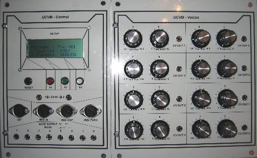

analogmonster
Posts: 100
PostPosted: Wed Aug 14, 2024 2:16 am    Post subject: Re: Programmable Control Voltage and Logic Adapter
That's why I add an ISP interface to each and every module which operates with a microcontroller.
Cool work, Kevin! Cool
https://www.analog-monster.de/ucvm_en.html
 Filesize:  46.17 KB
 Viewed:  8472 Time(s)

My MODDER is an ESP32 based module to convert the input signal according to a chosen conversion.The input signal in this patch comes from the O&C module on the left (an Attack-Decay signal).
In this module is the conversion table visible in top part of the screen (horizontal the 8-bits input value, vertical the 8-bits output value)
The bottom half of the screen gives an indication of the input signal (amplitude versus time)
This module makes use of both cores of the ESP32, where one core only does the AD-conversion of the input signal, gets the conversion value to go with that signal and sends it to the DA-converter.
The other core controls the Oled screen and gets signals from the Rotary Encoder and does the calculation for the display.
The two potentiometers are the offset of the input signal and an attenuverter.
This module also works on audio signals up to a few kHz.
thumb up
I wonder if this module could be used for ratcheting Rolling Eyes
Posts: 1320
PostPosted: Sun Sep 08, 2024 2:12 pm    Post subject: Reply with quote  Mark this post and the followings unread
sure, look at 1.40

PostPosted: Tue Sep 10, 2024 1:28 am    Post subject: AC/DC Mixer
Subject description: Helper module for the Analogmonster Modular
Not spectacular, but useful in any modular synthesizer (and I need this for mine): Two DC coupled 4 channel mixers with inverting and non-inverting outputs. It is part of my third modular:
I really like the functionality of your module. In fact, I may adapt your idea to my Arduino-based approach. What comes to mind is the idea that a single input voltage would be routed to multiple maps and a cross-fader could fade between maps. Also, you could map the same function to separate outputs at different phase positions.
Your output display is intuitive and very cool looking! Smile
...useful in any modular synthesizer (and I need this for mine): Two DC coupled 4 channel mixers with inverting and non-inverting outputs...
Indeed! There never seem to be enough mixers.
Nice build, there.

kkissinger wrote:
Thank you ๐Ÿ˜ƒ๐Ÿ‘๐Ÿป
This module is programmed using the Arduino IDE ๐Ÿ˜‰
