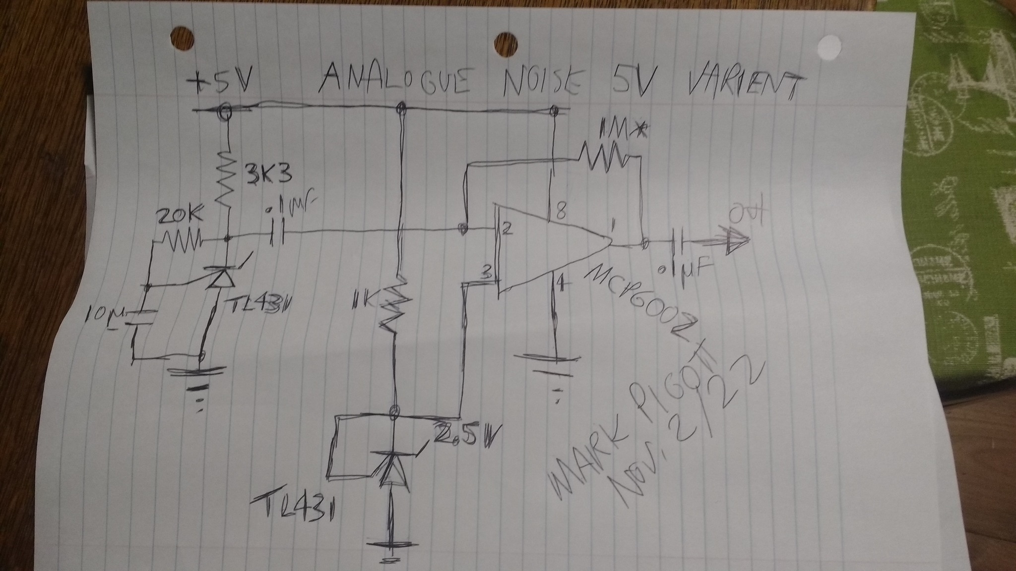

This circuit works fine all the time at 5V, it might even work at 3.3, but I never tried.
To simplifiy you can use a 10k,10k voltage divider on pin 3 of the op am and it works fine as well.
This triggers shift registers fine as it is biased near the trigger point.

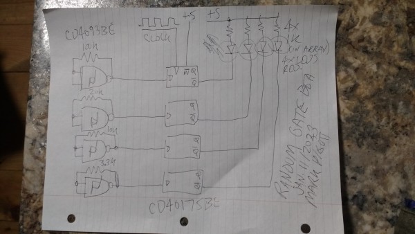

Here is my take on a random trigger, as we seem to use some of thee same chips.
This one is a 5V 4 channel random trigger

I find the LFSR a whole lot of chips that can be done analog with just some caps, resistors a TL431 and a MCP6002.
Analog brown noise has enough random to trigger a CD4517BE.
