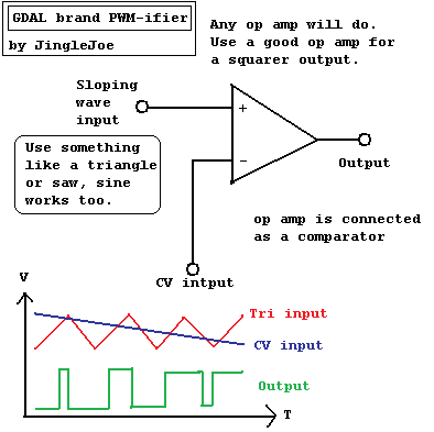

Just thought of vactrol controlled filter myself!
The hastily scrawled schematic and notes were carefully filed in the huge pile of hastily scrawled schematics and notes by the wall covered entirely in hastily scrawled schematics and notes. I may be in that facility too, Mr Mongo.
I think it may be possible to use a PWM signal to control the brightness of the LED, from what I've read and seen, some (if not most) vactrols have a sort of "fall off" when the light is turned off, which would effectively filter the pulses applied to the LED giving you smooth control instead of a filter modulated by the frequency of the PWM.
I will attach a schematic of my PWM-ifier. I would not consider using anything else at the time of writing. Maybe I will find something better as my knowledge progresses but this works like a charm Wink
Maybe one of you could test my idea Very Happy I am working on other things at the moment (and minecraft).

MadScientist
Joined: Nov 28, 2011
Posts: 63
Location: Denmark
PostPosted: Wed Dec 14, 2011 12:59 pm    Post subject: Reply with quote  Mark this post and the followings unread
There is a component called an analog comparator, which is better at comparing than any op-amp is likely to be. One example would be the LM393.

If I understand what you're saying (and who knows if that's true?) it sounds like you're trying to use the sluggish nature of the vactrol as a filter. That seems like it would work, but the corner frequency of the filter would be fixed.
I don't know how useful that would be.
I was assuming the idea was more in the nature of using the vactrol to replace the R part of normal filter.
Gary (hang on - the nurse is here with my meds)

Mongo1 wrote:
Hi Joe -
no no no no Laughing the LDR part of the vactrol would control a filter, I was merely saying that the "slugish nature" stops the PWM signal form modulating the filter and should in theory let the light level* control the filter.
(*which is controlled by the PWM signal, which will have to be around 100 to 500 Hz for good operation I think)

PostPosted: Wed Dec 14, 2011 3:01 pm    Post subject: Reply with quote  Mark this post and the followings unread
Brilliant Very Happy thats just the ticket!

Tim Servo
Joined: Jul 16, 2006
Posts: 924
Location: Silicon Valley
PostPosted: Wed Dec 14, 2011 6:18 pm    Post subject: Can It Be Done? Single Supply Op-Amp Filter Reply with quote  Mark this post and the followings unread
Not quite sure I understand the idea of using PWM to control the LED in a vactrol. Why not just directly control the brightness of the LED with the DC control voltage? PWM control has advantages in other areas (like motor control or high power LEDs), but I think it's an unnecessary step here. Right? Wrong? I have seen circuits that essentially switch a resistor in and out with a varying frequency and/or pulse width, allowing voltage control to replace a standard pot, but that's not the case here. Also, I think with the average vactrol, the response is so slow that a pulse frequency of anything more than a few Hertz would be lost (would probably work much better with the ultra fast H11 optocoupler).
Or am I just typically confused?
