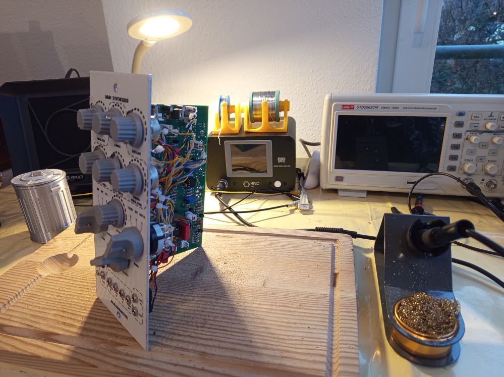

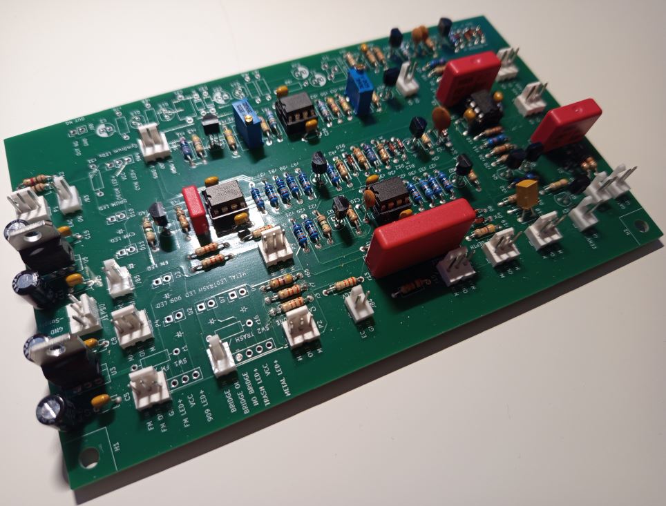

PostPosted: Mon Dec 15, 2025 6:40 am    Post subject: FM Drum Synthesizer
Subject description: My implementation of the Erica Synths project
I decided to implement the Erica Synths FM Drum Synthesizer with some (small) extensions. The Carrier CV nonreturn diode can be bridged to add some distortion (frontpanel element "TRASH - OFF - METAL"), and I added a Gate LED.
My YouTube example shows some first primitive integration tests. The Cymbal sounds a bit harshly due to the 4 diode ringmodulator.
