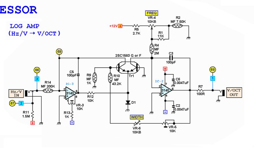

i think i found something you people might like to have a look at...
there was some talk on this thread about getting real cv tracking for audio input, i.e. guitar, in order to use it with a soundlab or other VCO. So that you could basically plug in a guitar and get the soundlab to follow the notes you are playing or something...
I'm very interested in doing that, so I've been googling on this forever again and again, without much results... the problem is, there are chips that will convert frequency to voltage, but they all do it linearly so you get 1kHz/volt for example. so it won't track properly on a soundlab, because the SL uses 1V/oct. (if you don't understand this, google it out, i'm just too tired to explain very much)
so: what you need after the f to v conversion is a hz/v to oct/v conversion, yes? well, google says there's this: Korg-MS-02
for the full schematic go to: (& scroll down)
http://www.cykong.com/Synths/Korg%20MS-02/KorgMS-02.htm
(I'll try to attach a close up of the converter part, if i can work this...)
so, for f/v maybe LM2907 or AD650, and then this Korg-MS-20 Log Amp from there on, and there you have it, guitar to 1oct/V, or what?
anyway. I'm off to bed, it's 2am.
I'd love to hear what you think...
Tom
hz/v to oct/v converter by korg

PostPosted: Wed Jun 24, 2009 1:38 pm    Post subject: Question about that MS-02 Log Amp Schematic Reply with quote  Mark this post and the followings unread
Hello all of you,
I have built out this MS-02 Log Amp on a breadboard, but have some remaining questions about it -
Can anyone tell me what the difference is between a 10k pot and a 10kB pot? (the guy at Potentiometers.com couldn't even tell me!)
Also, am i correct to use a generic silicon diode for this?
I haven't got it working yet, going back over the circuit. Am running on 9v at the moment, so perhaps that's part of the prob.
I also couldn't find the matched pair they refer to, but used a NTE42 instead, which i am hoping is a good alternative?
Possibly meaning 'B' type pots, ie. Linear. 'A' type would be Logarithmic
source:
http://sound.westhost.com/pots.htm
LektroiD
Gonecat
Joined: May 02, 2009
Posts: 43
Location: Rome, Italy
PostPosted: Wed Jun 24, 2009 6:14 pm    Post subject: Reply with quote  Mark this post and the followings unread
Thanks for the response.
So on the schematic we have above for the MS-02's log amp, would the two not marked with a 'b' be 'logarithmic'?
